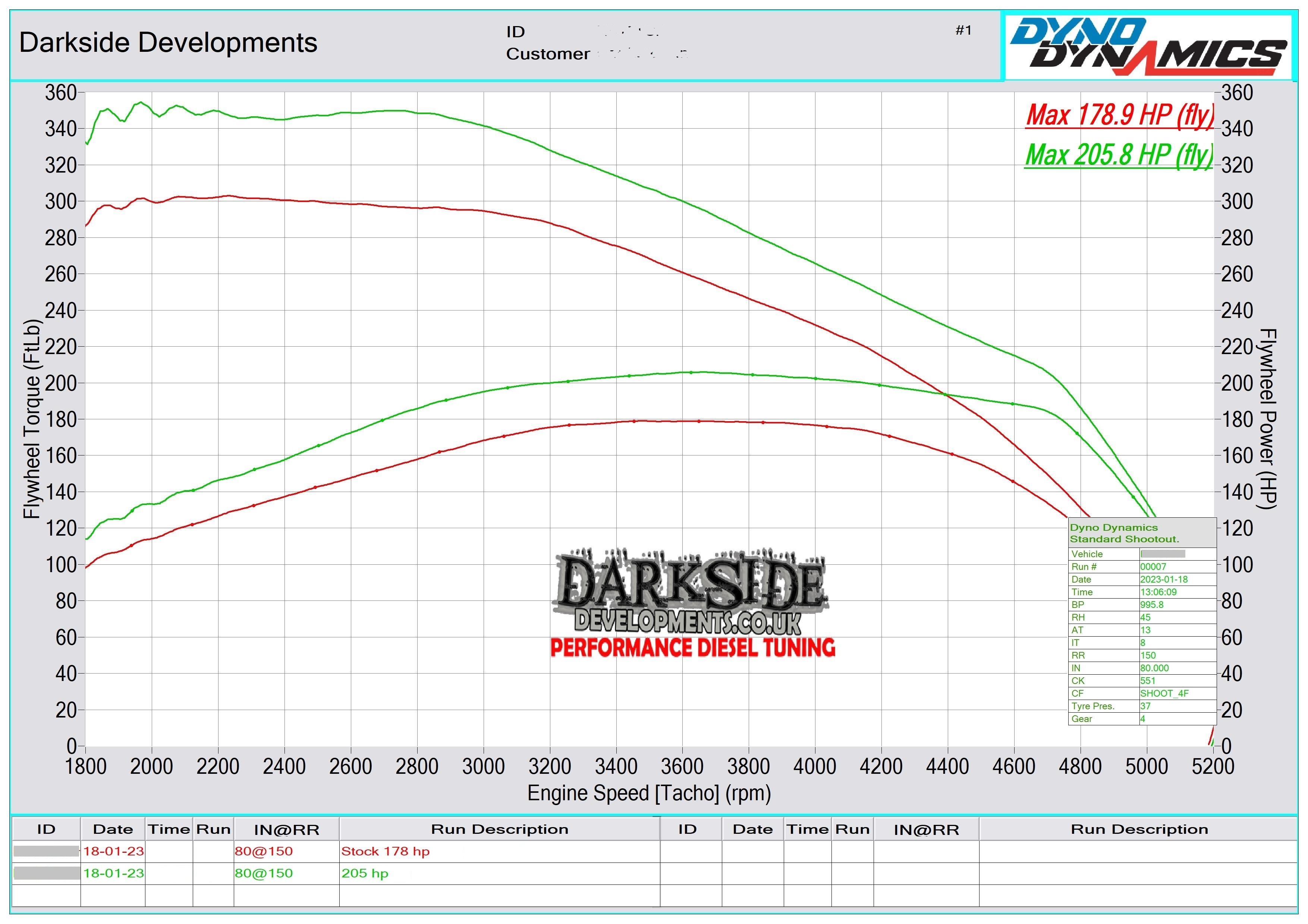

so an update.
My car went into Darkside on Wednesday morning and returned yesterday afternoon all sorted.
Remap has all been sorted. Slightly less hp than I was expecting with a peak of 205.8, but the torque is still a vast improvement at 350ftlb's.
It just feels so much more responsive no matter what gear you're in. And unlike when I had the DTUK box on, it just feels nice and progressive, rather than a lump of power all of a sudden.
I went round the block just to make sure I was happy with everything and did a quick 0-60 and it came back 7.59 seconds. It was a bit slippy due to the conditions (TC kicked in in 1st and 2nd), but that it still a noticeable improvement over stock. I know it's not a record breaker, but I'm happy with that.
