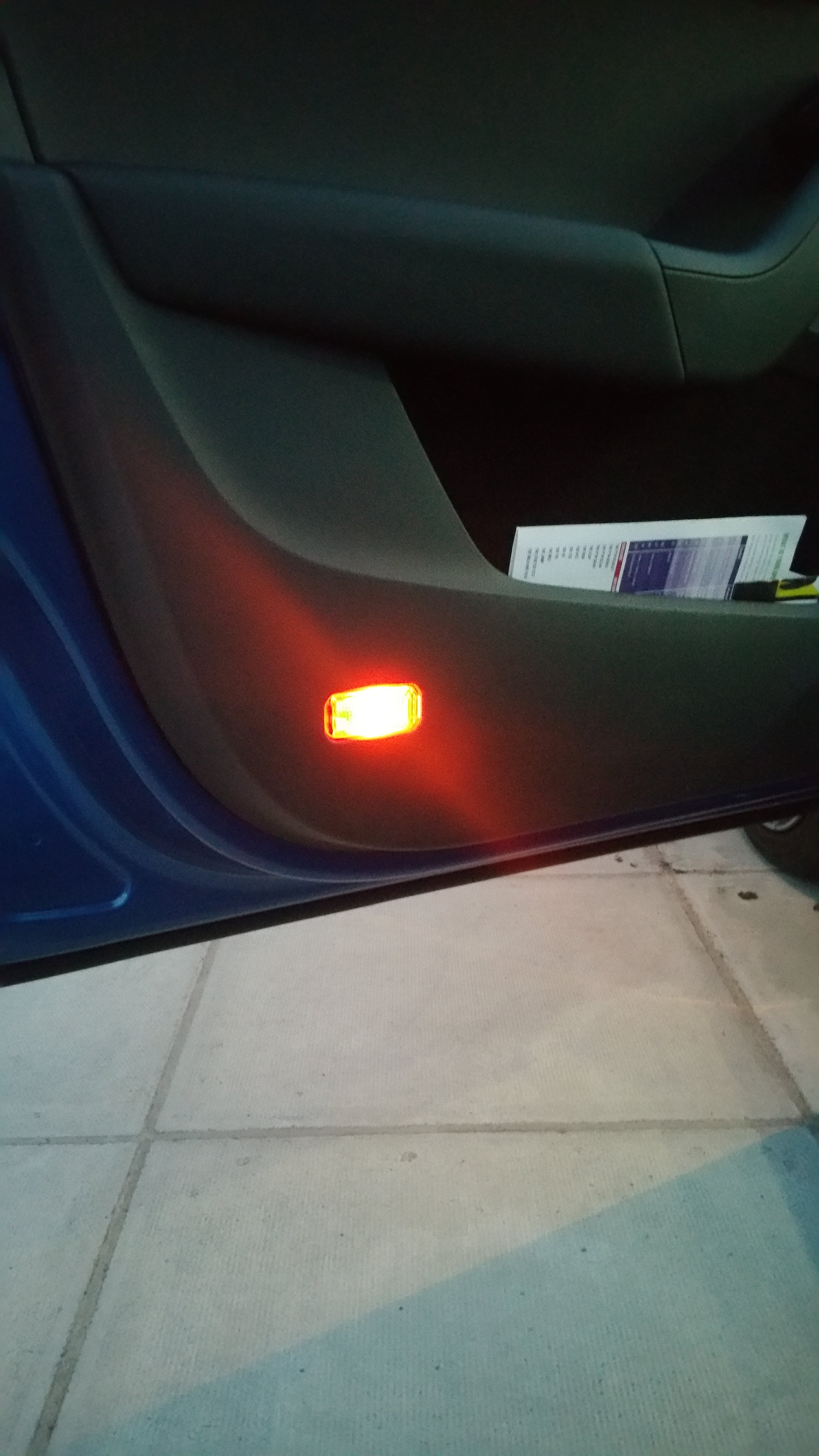

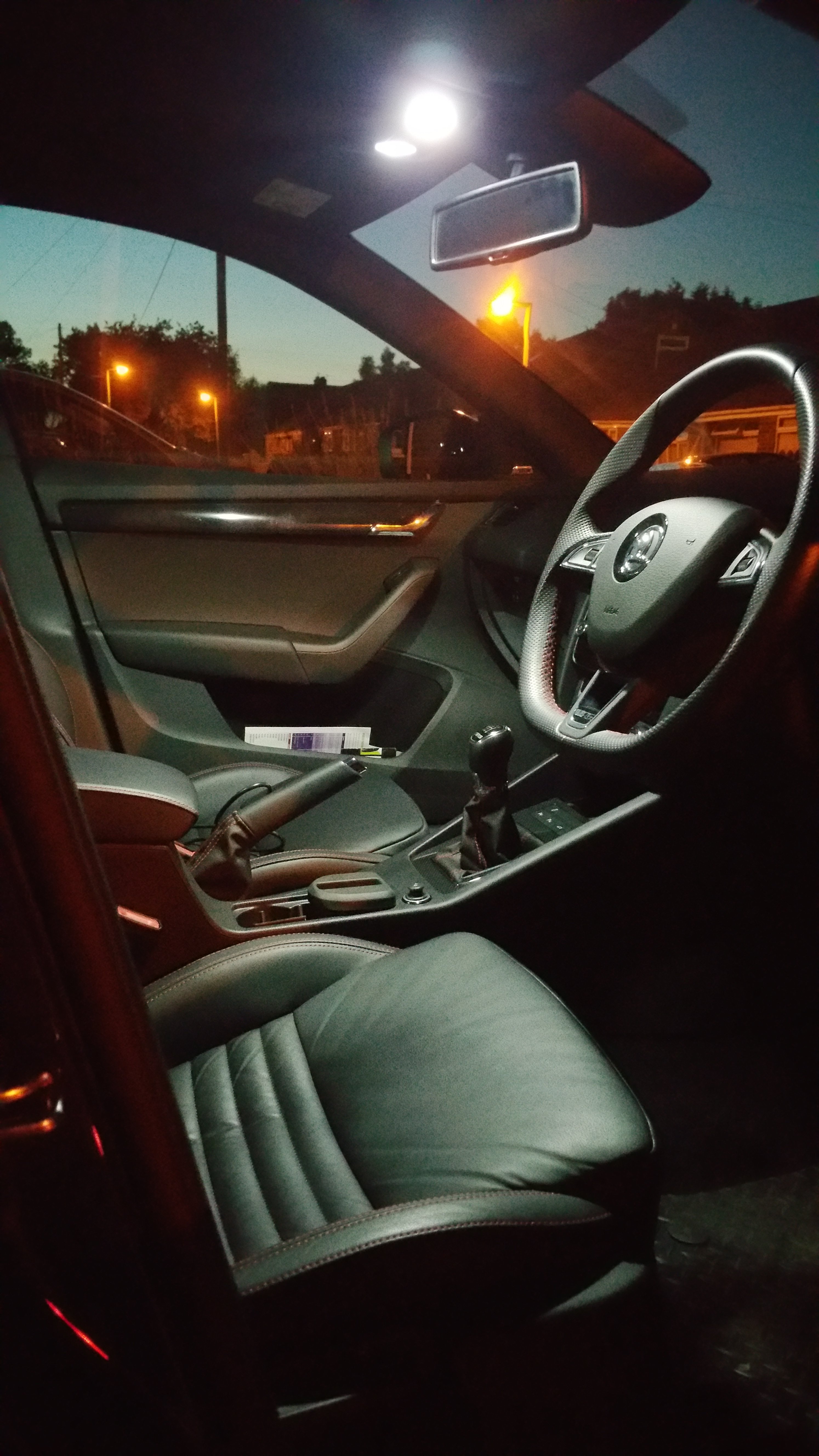

In between having a cool beverage or 2, I've been doing a couple of tweaks to the car. Forgive the script..........

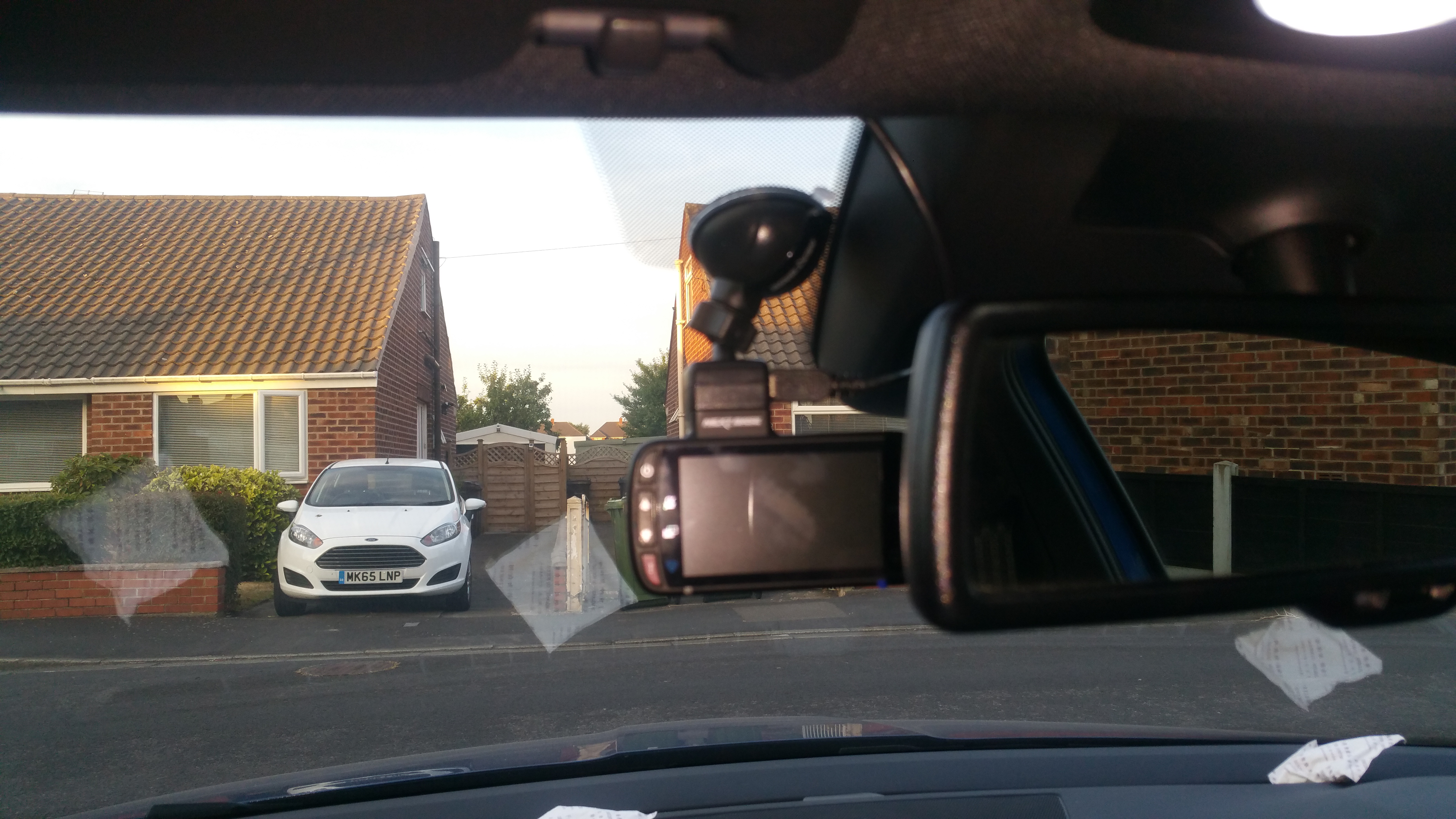

First on the list is fitting my dashcam. I feel these are starting to be seen by insurance companies as a necessity for getting a cheaper quote, plus you're getting the benefit of a bit of security for yourself. I've not pushed the boat out too much, only bought a relatively basic Nextbase 312GW, but they do get a decent review and I was able to get an unused, open boxed and 'shop soiled' one from ebay for £45 delivered. Add a wiring harness and delivery and it came to just on £55. Result!!!!! Installation of it didn't prove overly difficult to be fair, just the usual swearing whilst putting the glovebox damper back on.

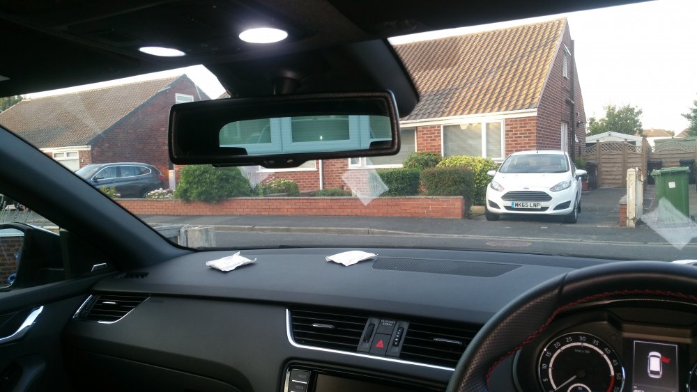

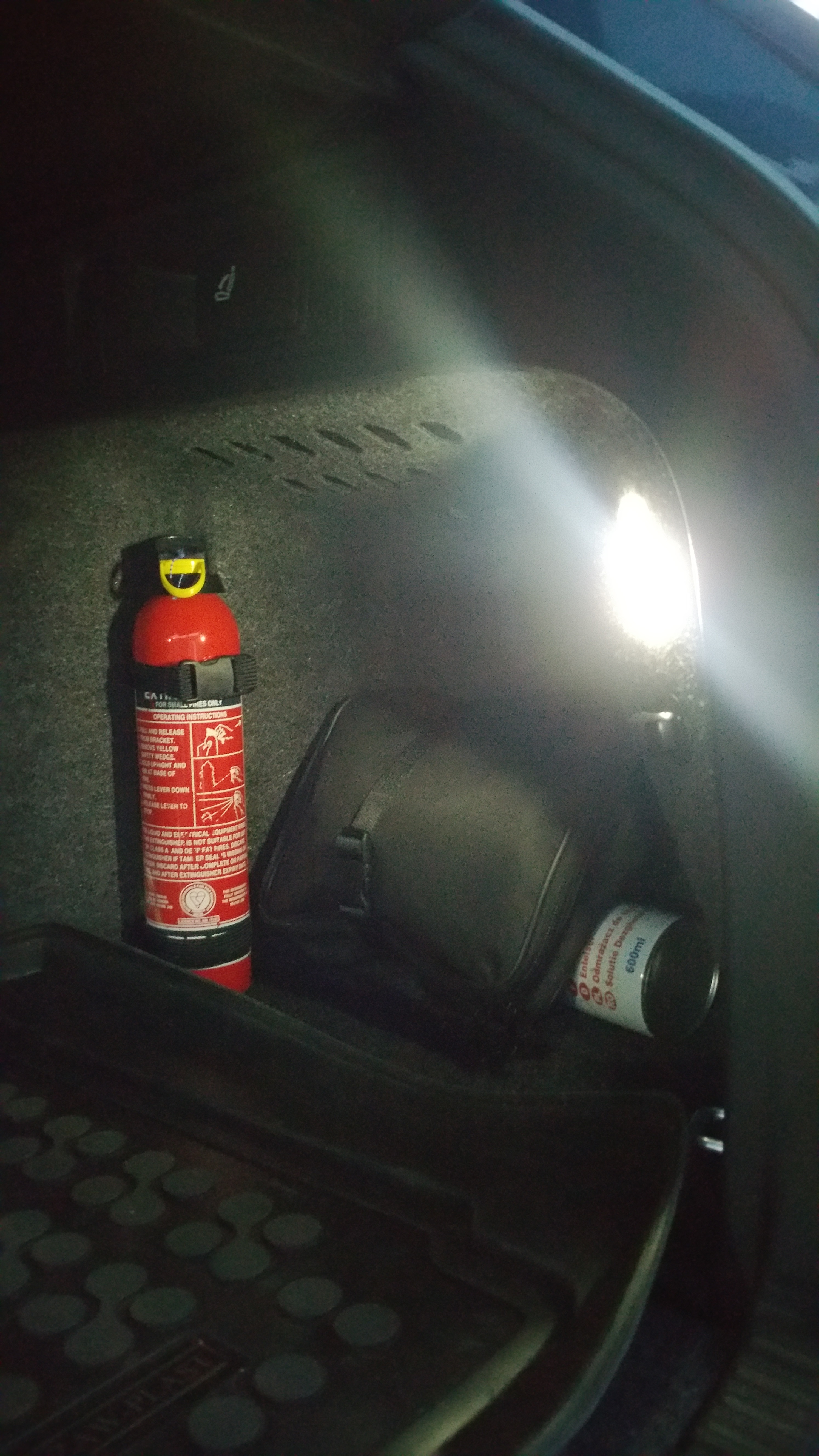

The next tweak I've done are swapped the horrible, yellow, awful, hot, power wasting incandescent bulbs and put in a set of nice, white, tidy, cool, power saving LED bulbs to make the interior look that little better than it already does. They're nice and bright, but not stupidly bright. The one thing I do like from these LED's are they dim down when the lights are going off, so they fit in with how the original bulbs were. A lot of LED's I've used in the past were either on or off, so this is nice. Only issue I had was on the door opening lights and the boot lights, as these LED's were just a little too big to fit in comfortably into the metal holding pins, so I had to bend them a bit. No major issues. These bulbs, due to their size (3mm too wide) weren't able to fit into the sidelight slot. Which leads onto the next mod.
The last upgrade I've done are the sidelights and the number plate lights, which again are the old, horrible, yellow filament bulbs. They look daft next to the DLR's and stick out like a sore thumb. With the rear number plate being yellow, you can't notice the colour there, but they're gone regardless. The physical fitting of them wasn't an issue, but the digital side of things sure threw a spanner in the works. Turning the ignition on brought up an error with the number plate lights (expected) but didn't bring an error up about the sidelights (unexpected). Coding them on VCDS both to  '6 - LED Lichmodul' got rid of the number plate error, but instead brought up 'Fault: vehicle light' on the screen. A bit of searching later and I found a post which advised instead of using '6 - LED Lichmodul' for the sidelights, use either '43 aligemeine LED' or '40 aligemeine LED'. I changed it to the 40 setting and I still had an error. A night's sleep and a google later and I changed the number plate setting to '40 aligemeine LED' as well. Error messages have now gone!!!
Pictures to follow.......
Which interior LEDs did you use?
On my interior I used these
ebay LED 5w sidelights
Like I said above, you needed to bend a little bit of the mounting chassis on the ones which you'd pull the lighting housing out (door light, boot, glovebox)
I probably should have got a full set on these. These are the ones I used on the sidelights and number plate lights because they're narrower. Still fairly bright to be honest.
ebay LED 5w sidelights narrow (I got the 5 SMD ones, as I was worried about the length)
Ignore the 'canbus error free' as they do flag up an error regardless.

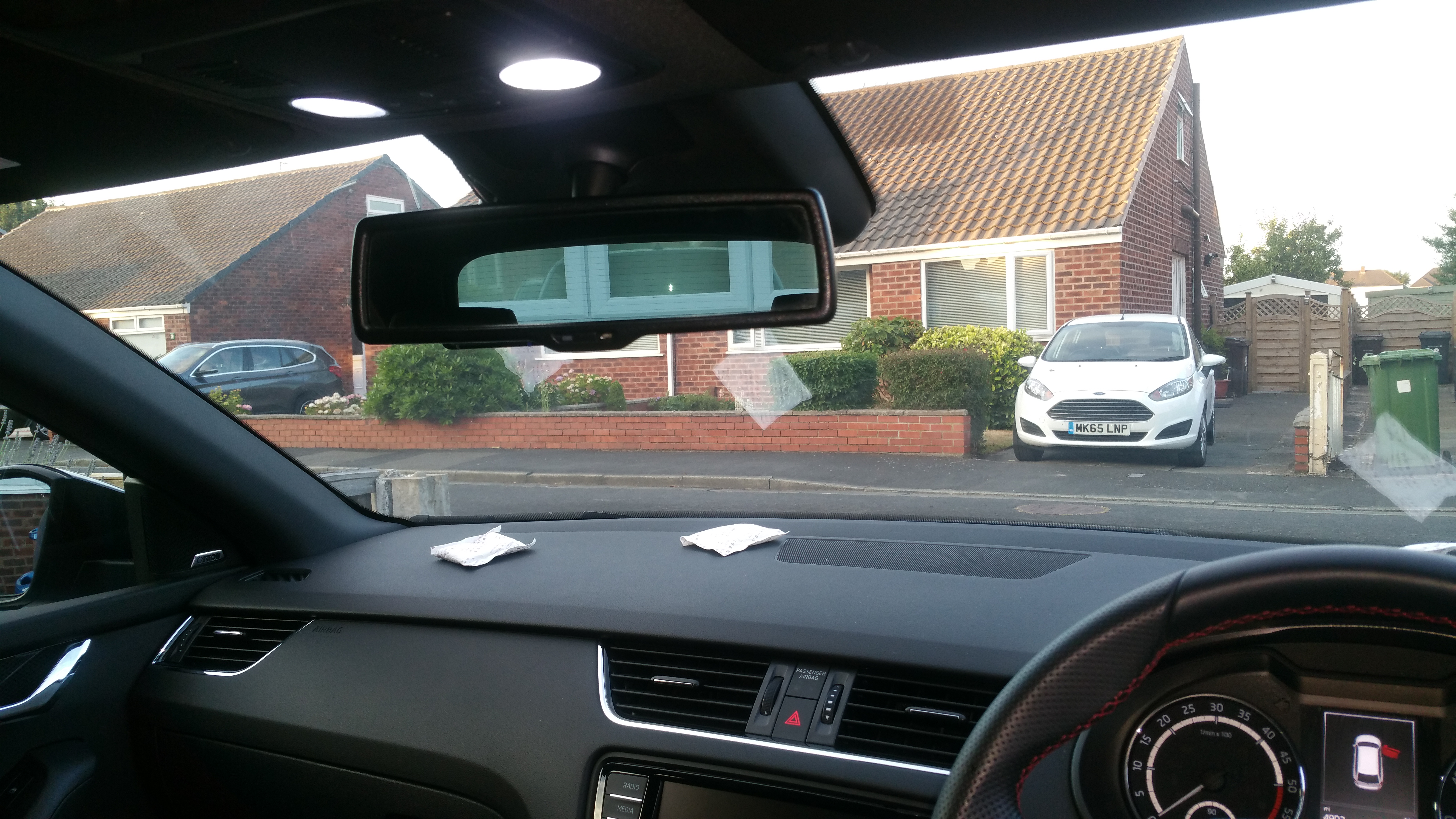

I've taken a couple of the dash cam. It was hard to get a decent picture whilst the sun was glaring down.
I feel it's in a brilliant position, as from where I have the seat, I can't see it. This is a bonus as it does have a light on it, which may require some tape in the darker nights. It only catches a very small corner of the mirror mount, but apart from that, it gets a clear view.

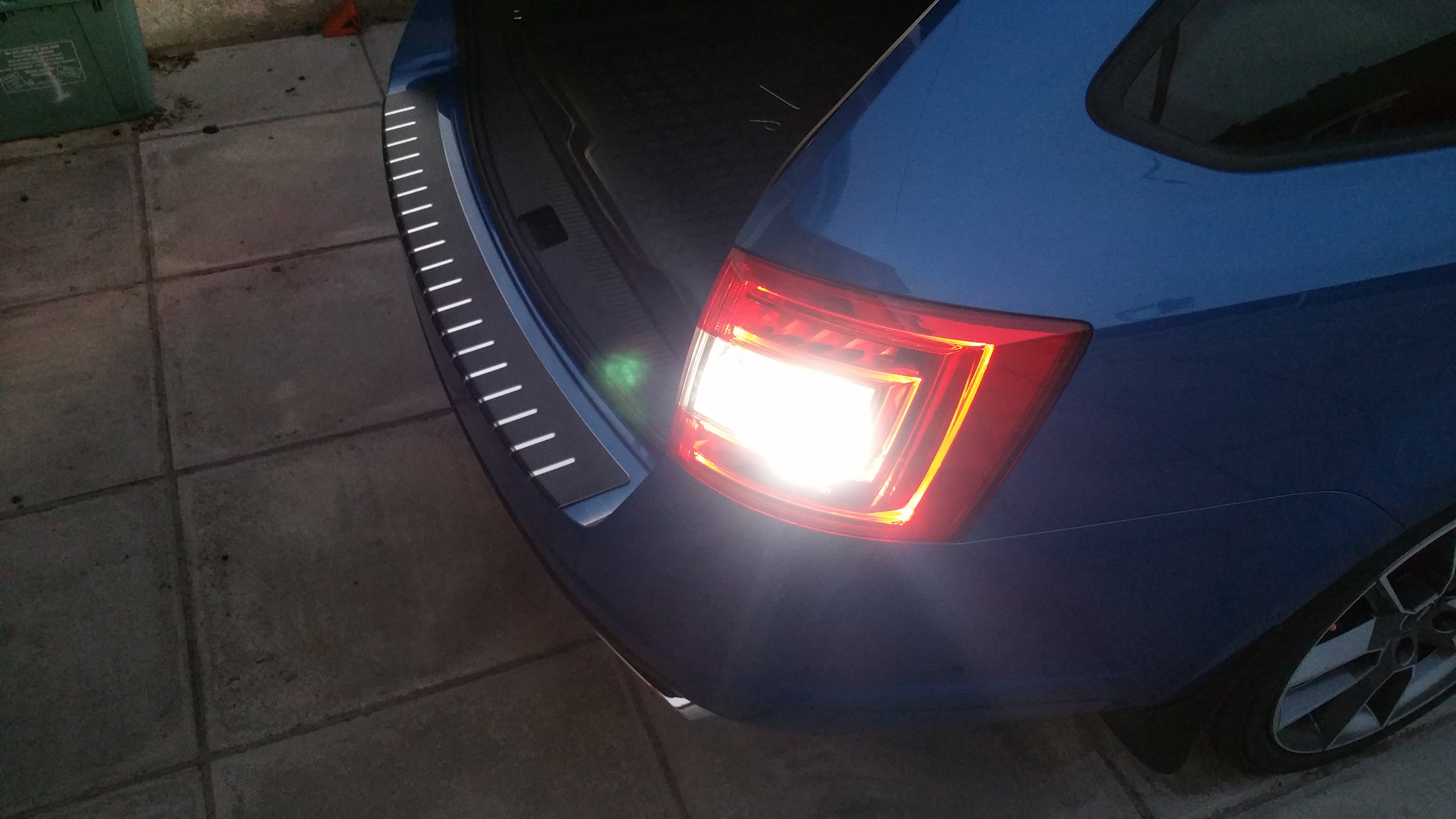

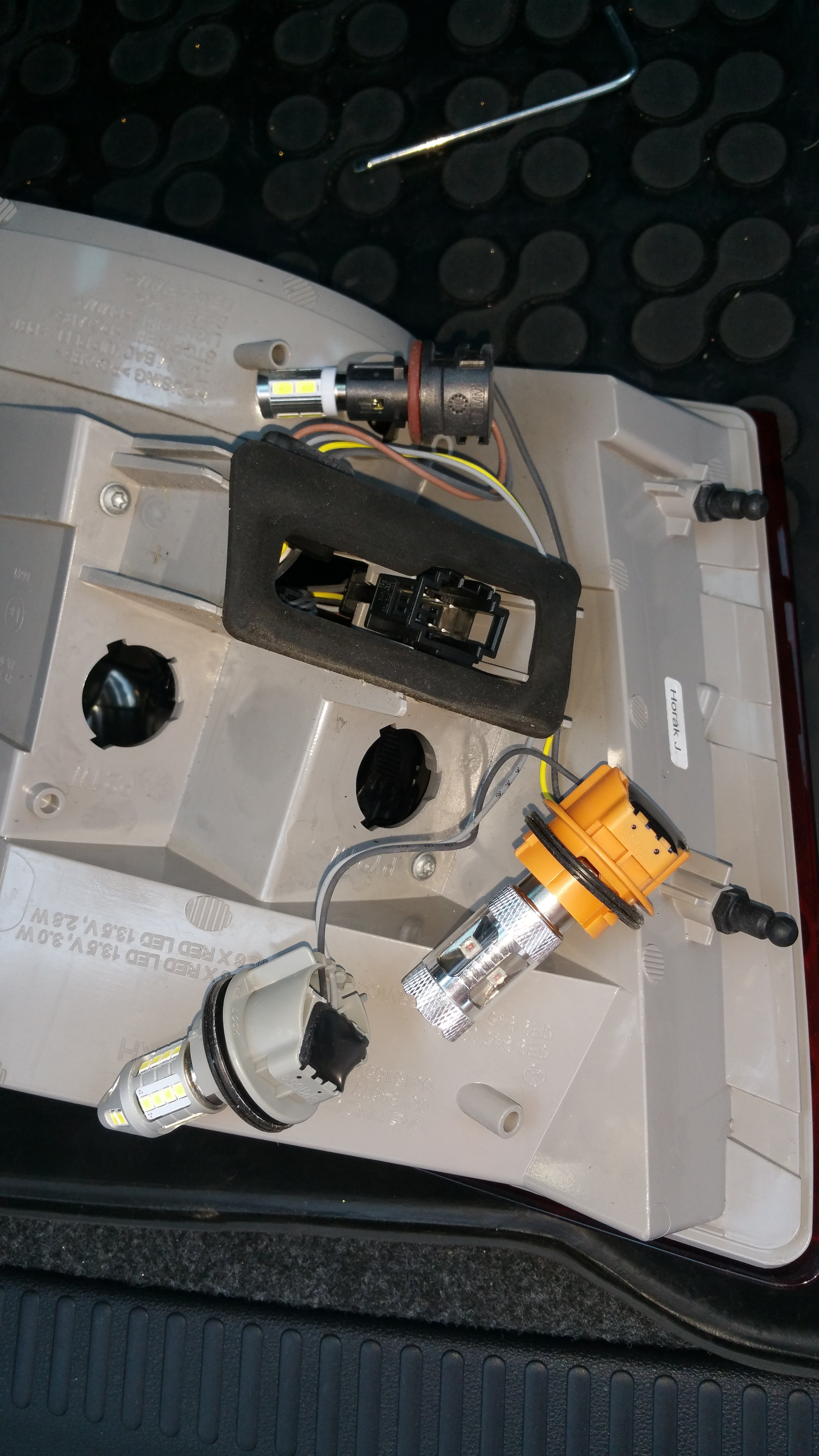

Right, again I've been having a fiddle with bulbs and this time it was the rear clusters' turn to be brought up into the 21st century.
I've been having a look for indicator bulbs for a while now and I had seen a few on ebay and other car parts places, but I've always been a bit concerned about need to fit resistors because of turbo flashing. Now a few member on here have pointed me towards aliexpress, however a lad in my work bought the following bulbs for his Audi A4 and I was impressed when I saw them; very bright, fairly cheap and no error messages)
It's a shop on ebay (mkauto) and these are the bulbs - MKauto Rear Led Indicators
I also bought the reversing leds - MKauto Rear Led reverse lights
and the fog light bulbs as well - MKauto Rear Foglight Led
I was still sceptical when I saw the 'CANBUS ERROR FREE', as this does usually mean a faff to get them either coded or resisted, but these bulbs went it with no errors!!!! Made up!!!

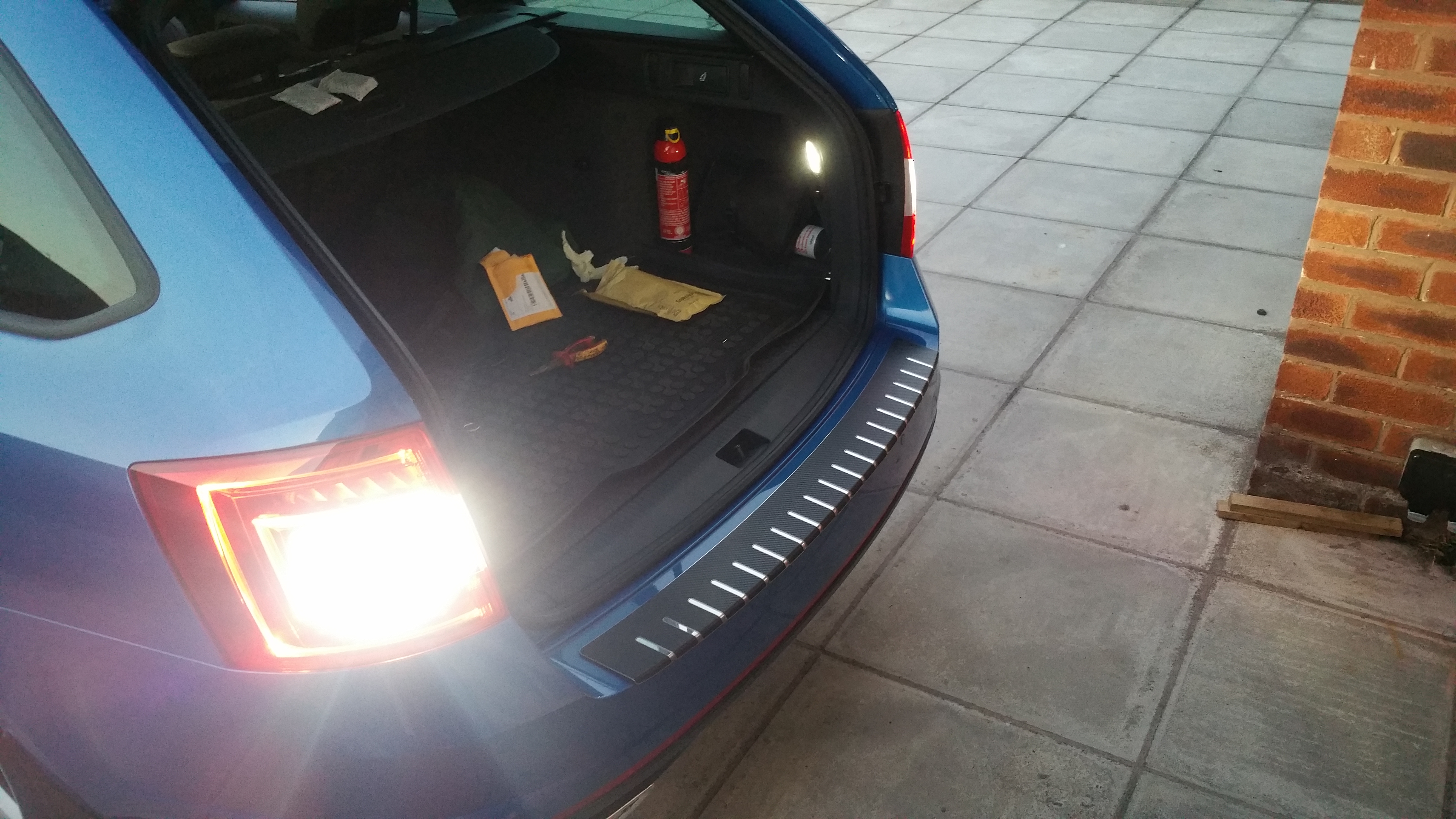

I've done a video of one set of bulbs on the left (LED) and the other set on the right (filaments)
Rear LED Comparison
I'll do another video later on in the evening, just so you can see the difference in the dark
Here's a picture of what the LEDs look like as well
All in all, a great purchase for £40.92!!!! I'd certainly recommend these.
As promised, a video of the indicators in low light. I am very impressed with them. Mkauto indicators in low light
I am also made up with the reversing leds, as they illuminate behind the car so well.
