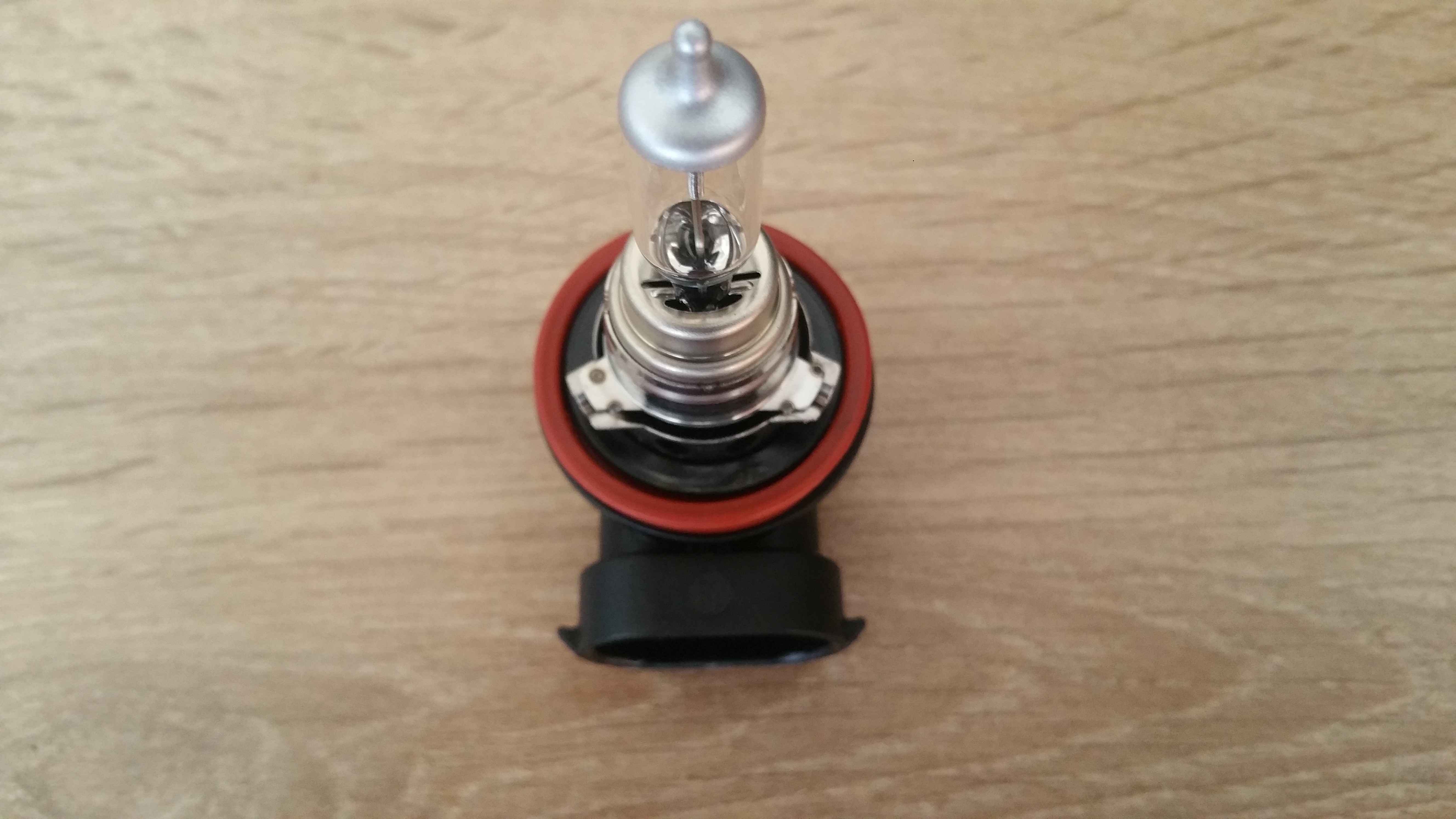

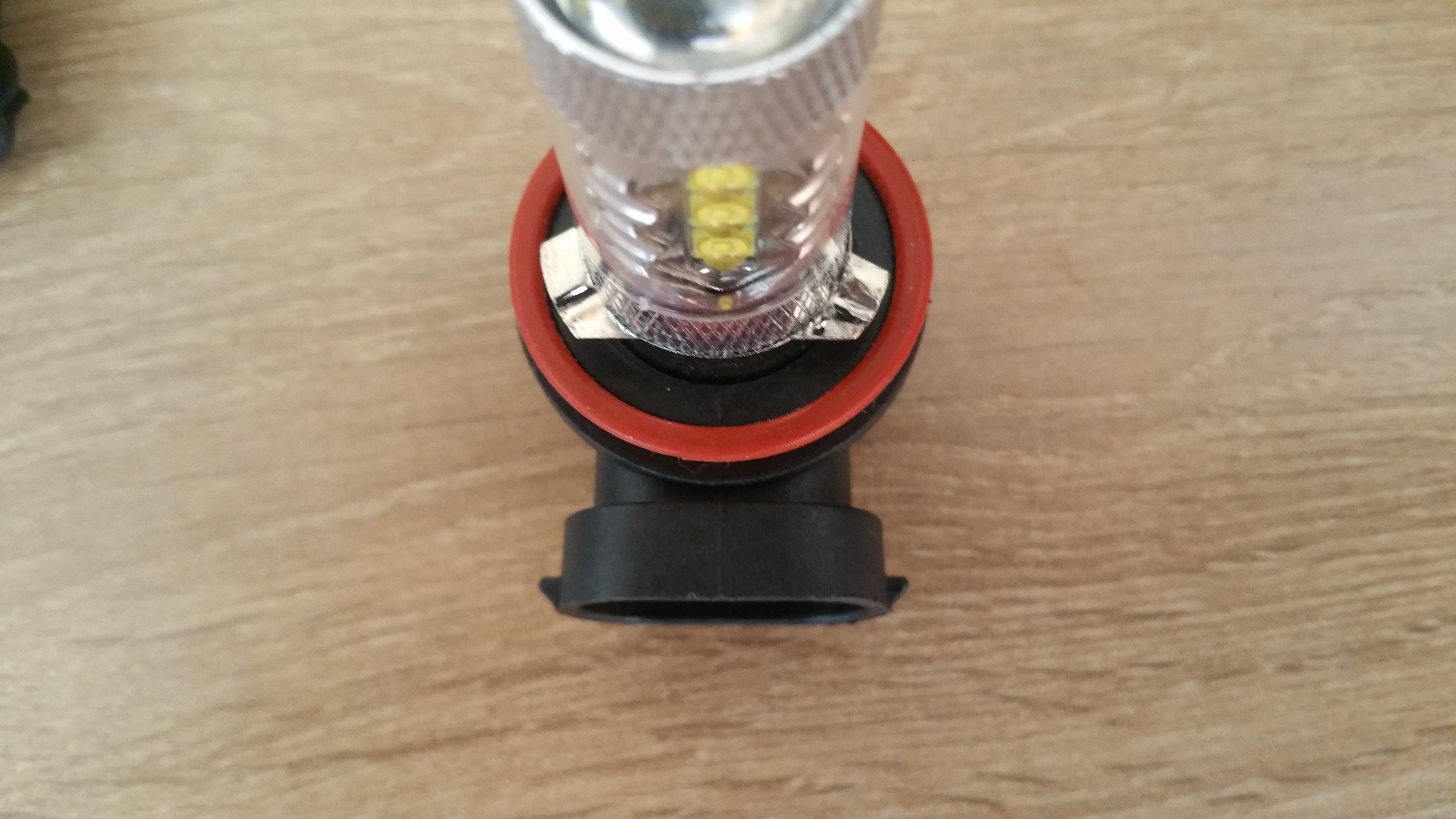

My main problem was the bulb type the VRS uses, H16. There appears to be 2 types of H16 bulb; h16 5202 and h16 (jp). Our cars use the latter one, but trying to find any from somewhere I felt I could trust was a bit difficult. The only branded ones which I found were Osrams, but they would have been £170 for 2 pairs. Not on your nelly!!!
But, I was reliably informed that H8 bulbs are basically the bulb, but they have a slightly larger mounting post. So an ebay hunt later and I found a some which seemed to fit the bill. https://tinyurl.com/yc459kpo
The first picture is the standard H16 bulb and the second is the H8 led bulb. You can see the post on the left is about 3mm bigger. It was easy to cut this down to size, just used a pair of snips.
Fitting the bulbs took 5 minutes, but it was a pain getting the under engine cover on and off, as I've only got a trolley jack to raise the car up, but shimmying under wasn't too bad, just a bit dirty.

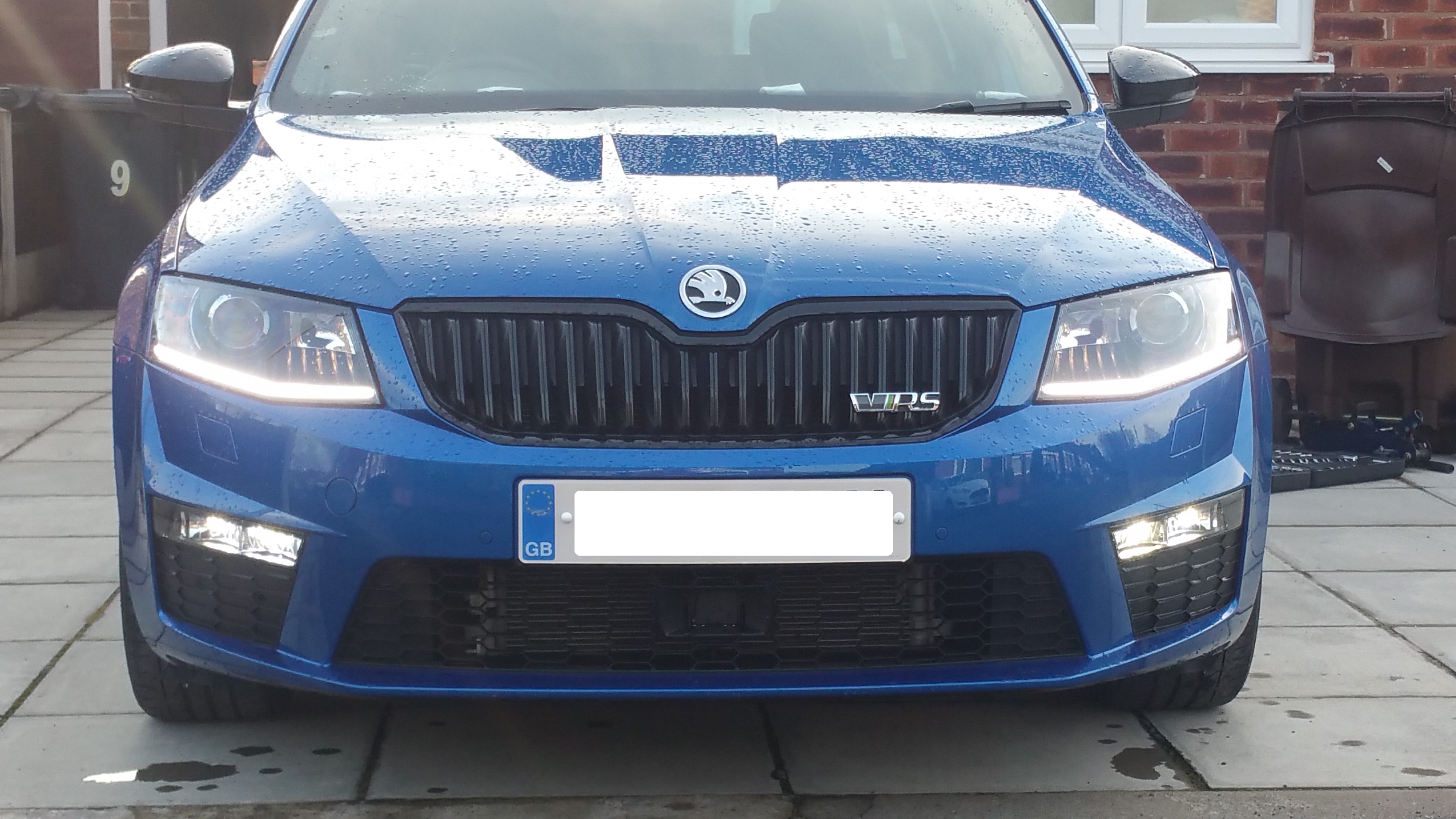

Overall I'm very happy with the bulbs, as I feel they fit in with the standard drl's very well.
You can't really see the colour difference in the daytime photo, but it's certainly a whiter light and much better than the nasty halogen standards.

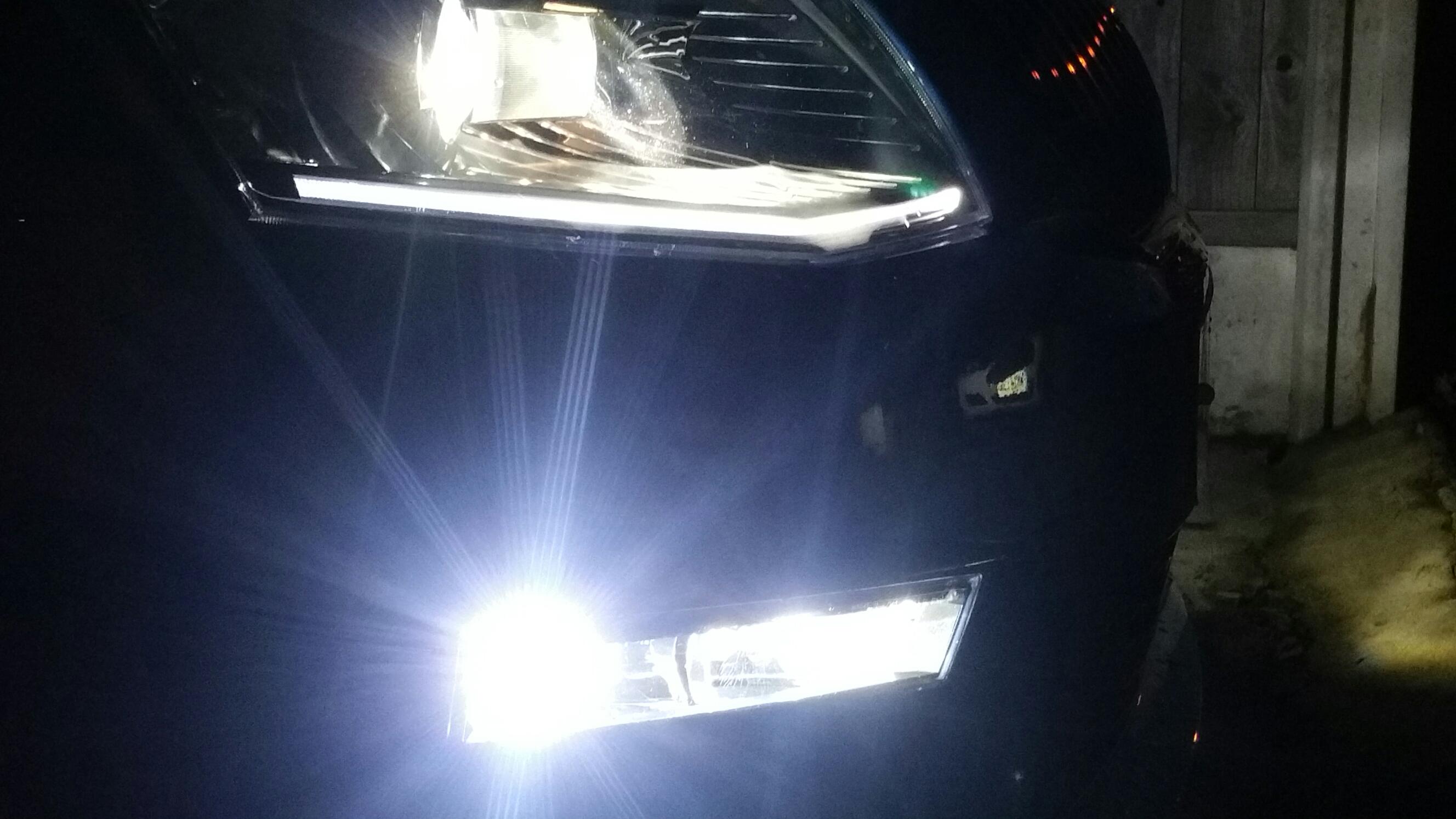

You can see it a bit better in a nighttime shot. Had to take it from the side, as even with the headlights turned off, the dazzle on the camera was quite distorting.

How is the light pattern compared to originals?
Some LEDs that I've tried shatter the light everywhere except were they should.
Nice colour but they didn't put more light on to the road.
These do a good spread of the light both at the front and to the sides, but appear to stay low.
They're intended use is as drl''s and I am happy with they're overall brightness in the daylight.
