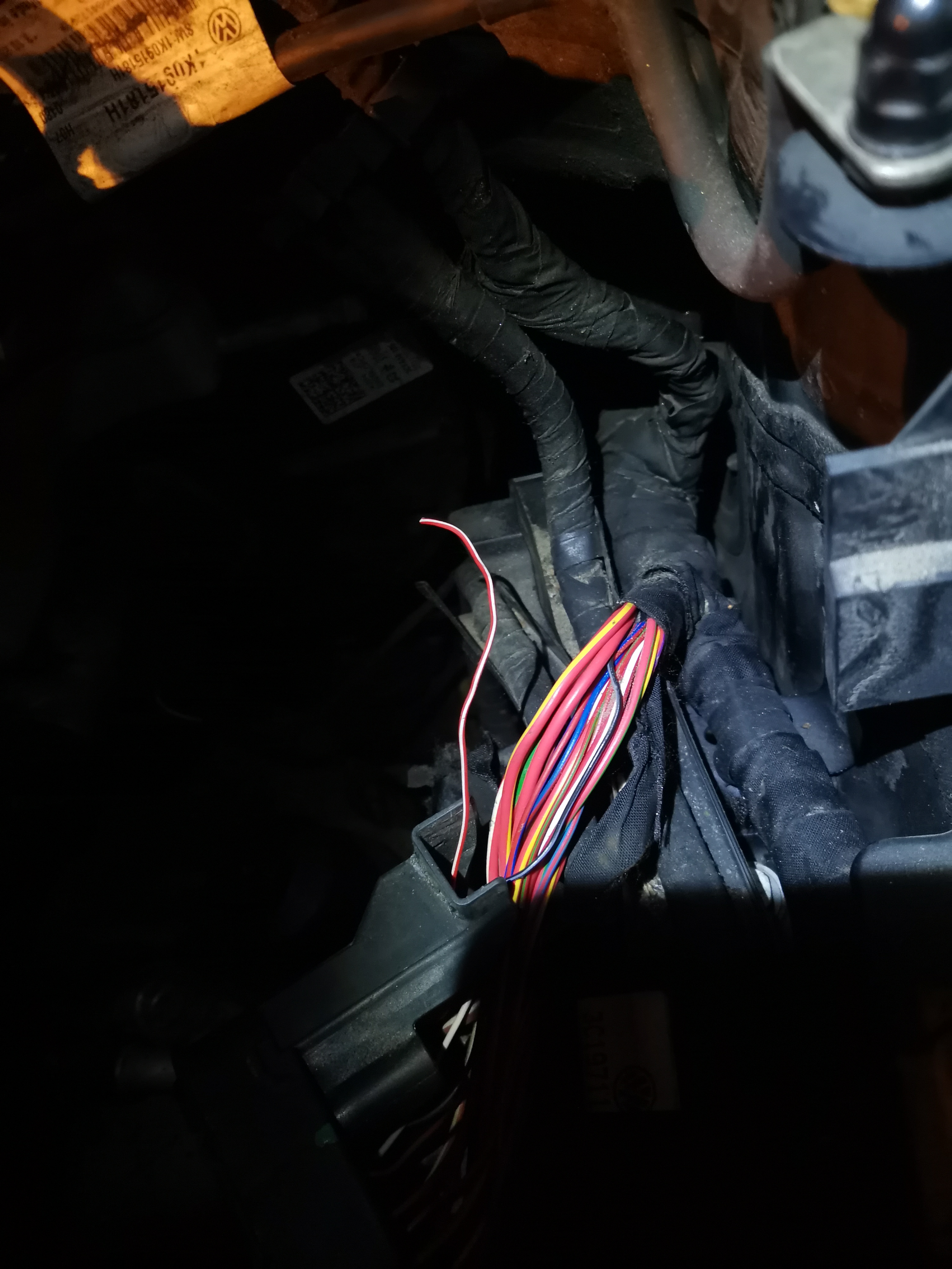

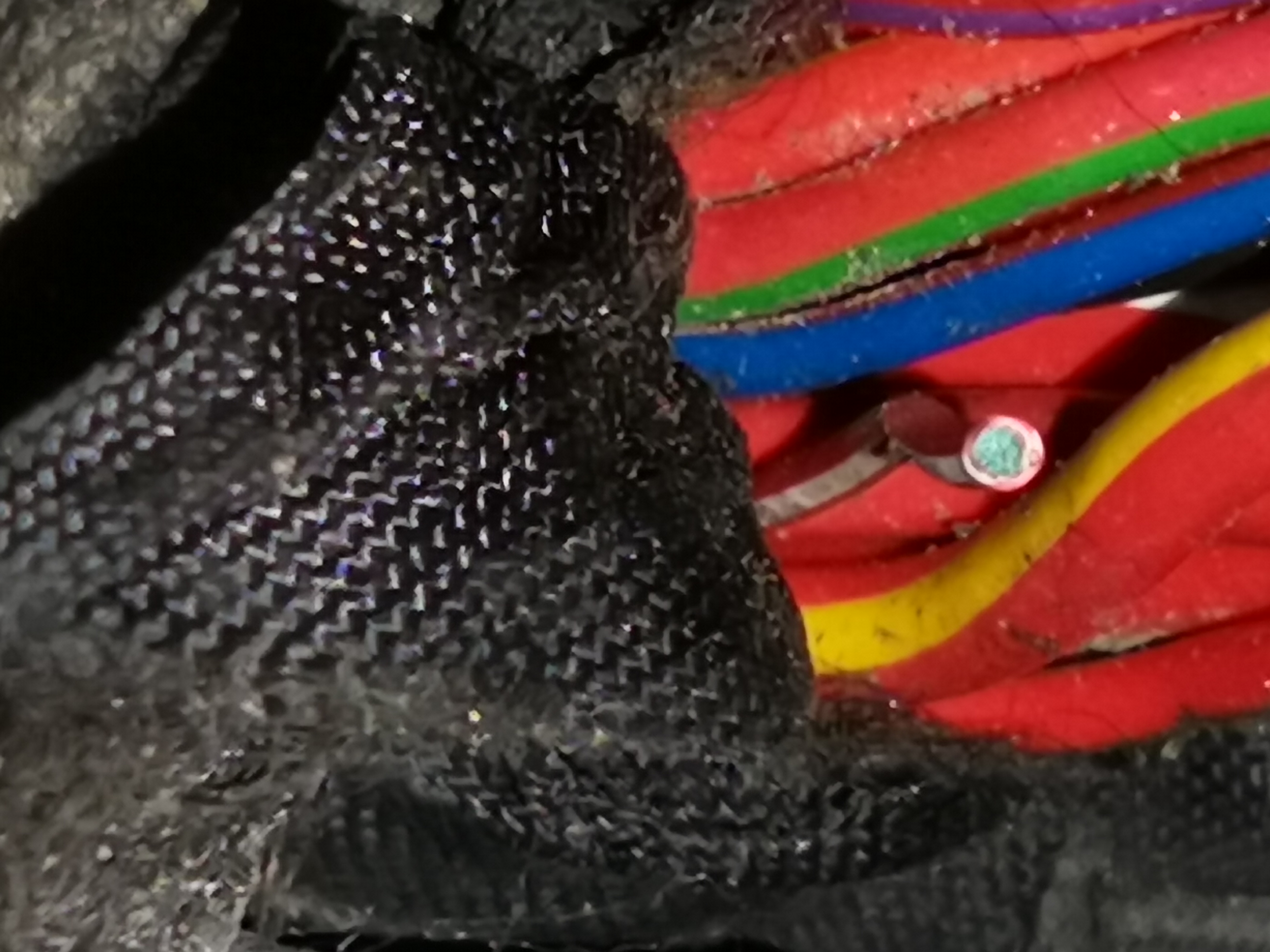

On 31/03/2021 at 15:49, jurgins said:
Found the problem. Oxidation killed CAN gateway power supply cable behind/below battery bracket. Close to firewall.
I will leave this here and hope that this could help someone in future
