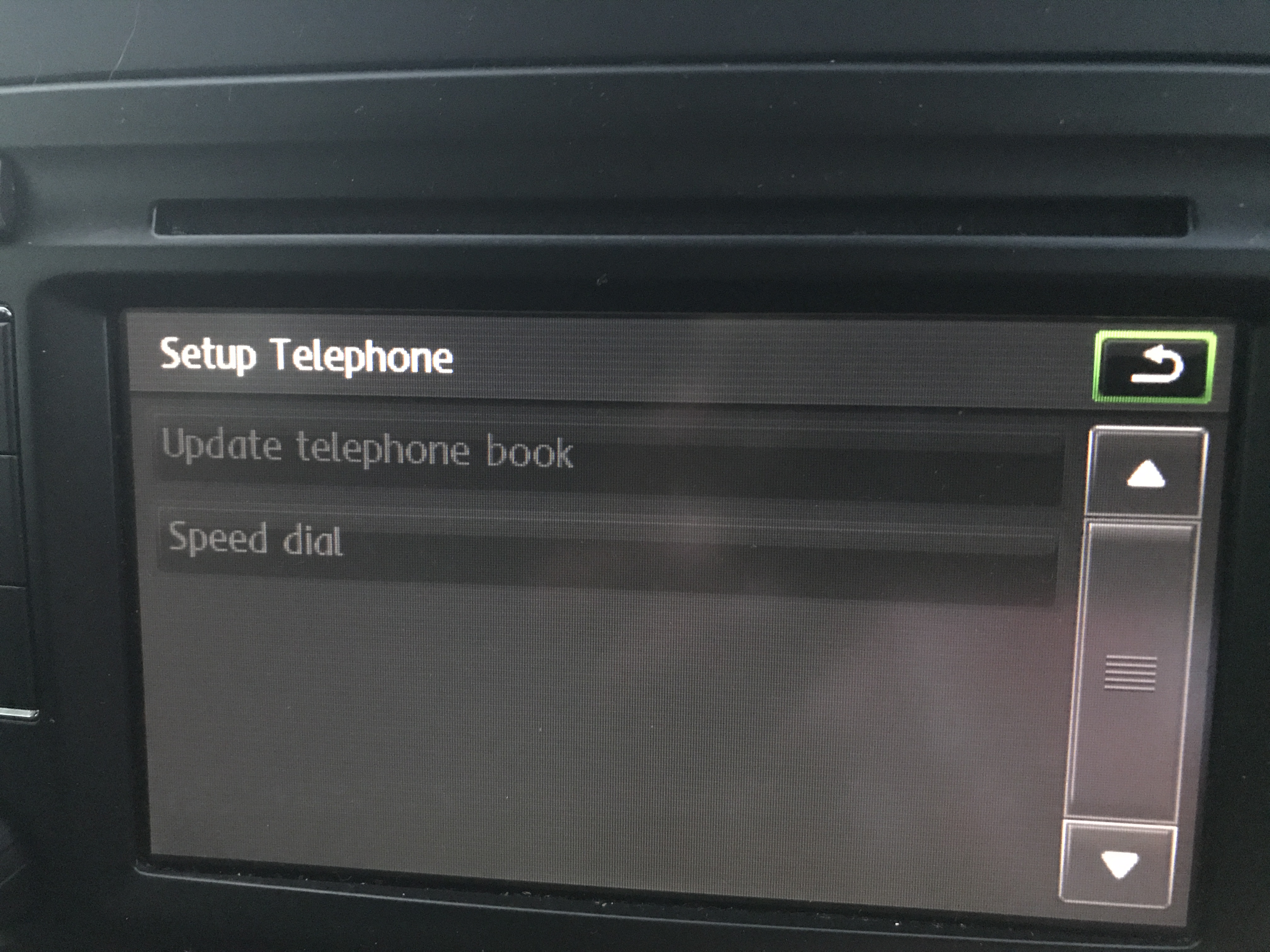

I just got my hands on my Skoda Yeti 1.2 TSI SE 2014 model with the Bolero radio. The manual says to enter Setup and select Setup Telephone to start pairing phone.
However all I get is a greyed out Update Telephone Book And greyed out Speed Dial. I Carriet out a Factory Reset but this hasn't helped.

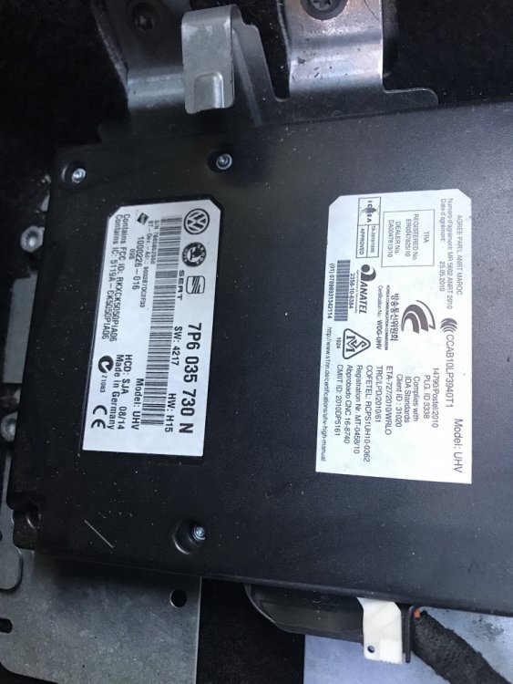

Hi Steve,
I should have asked is there anyway of checking if the Bluetooth module is fitted? Is Bluetooth an option and not a standard fit
Try looking under the Drivers seat, there should be a black box under the seat, on the floor  ( thats if it's the same as an Octavia MKIII )

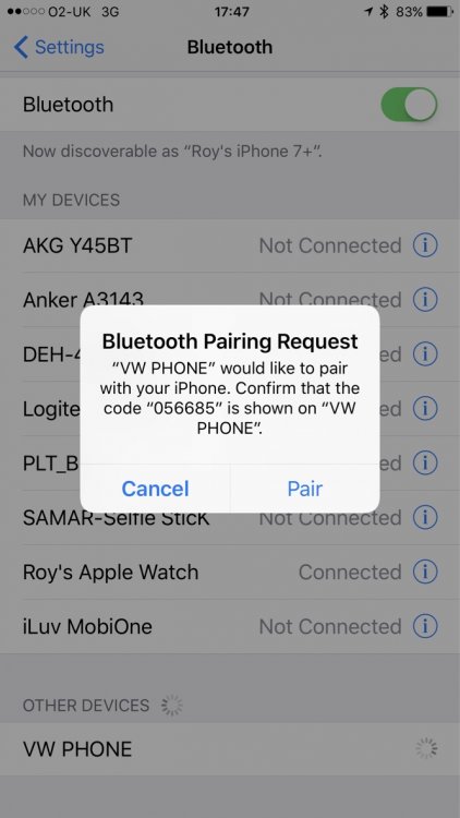

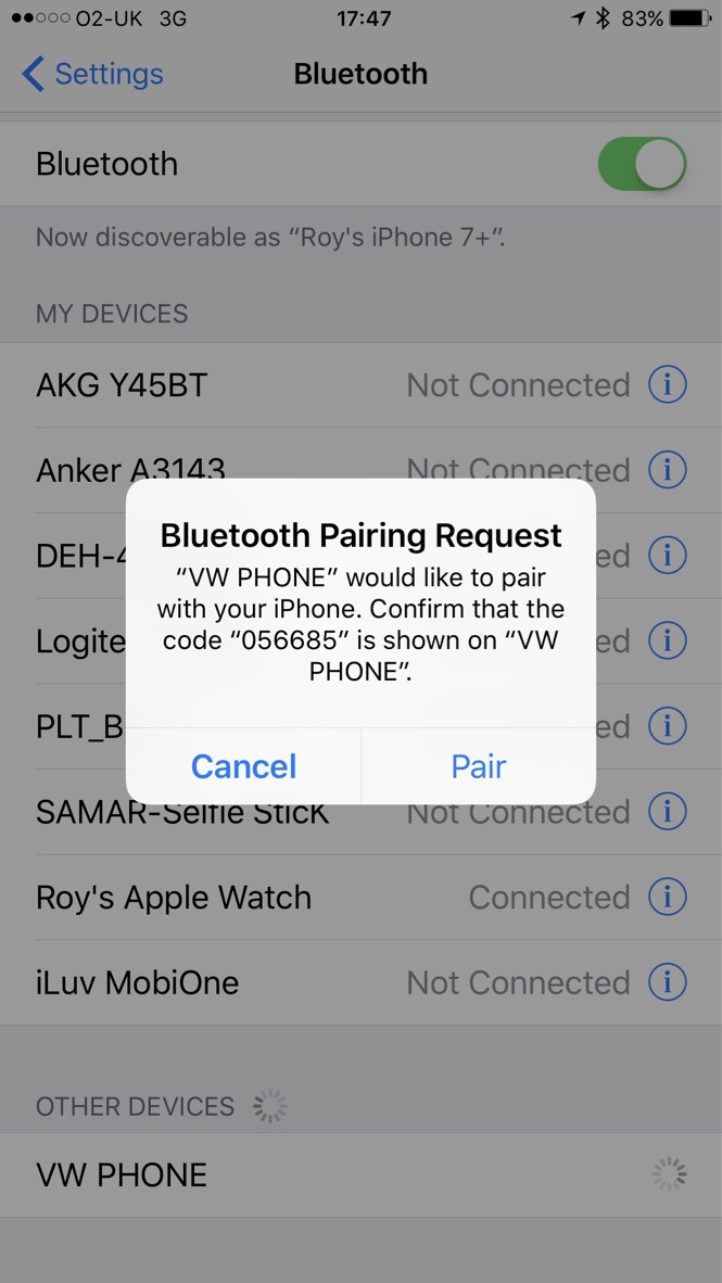

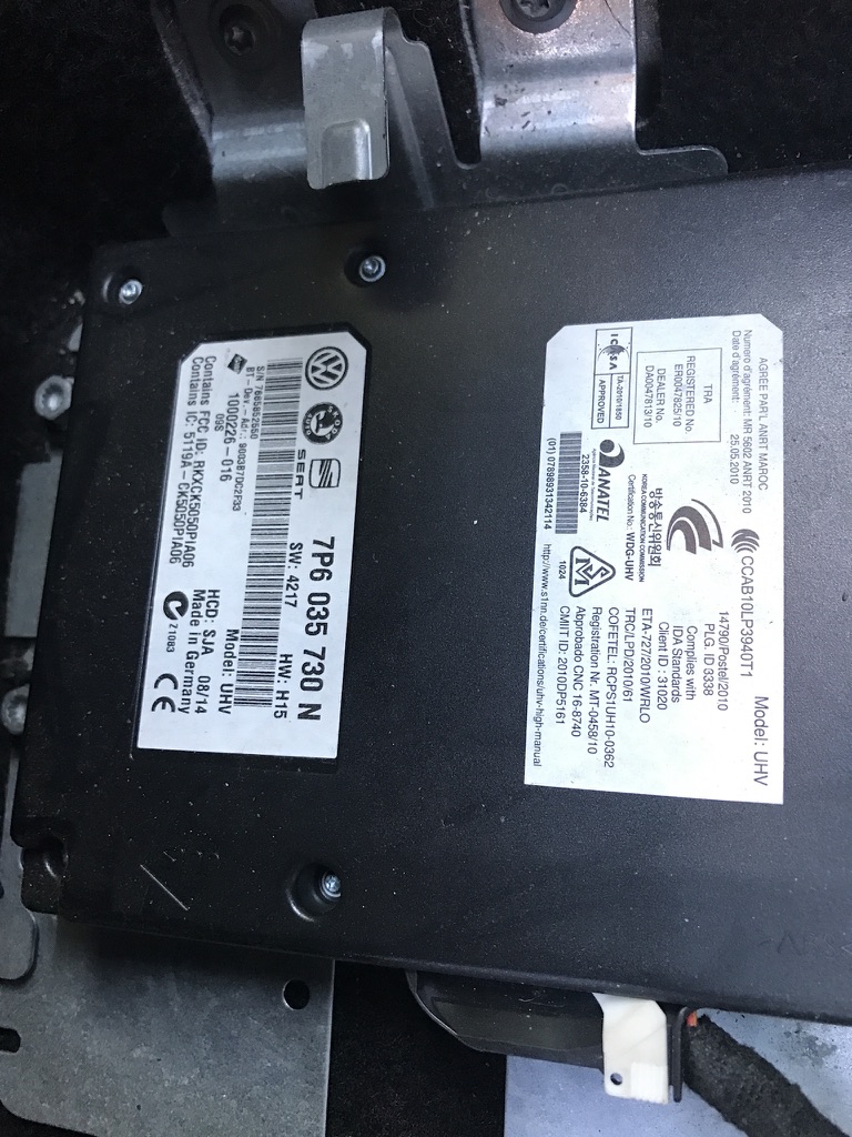

Hi guys,
Update on my Bluetooth situation. I have a Bluetooth module under the drivers seat, see attached image, thanks Auric for pointing this out. I also see VW radio show up on my iPhone when searching for Bluetooth device, see attached image. However as you can see there is a code that should be shown on the Radio, but I cannot see this under setup phone or when I select the phone as a source on the radio. Under Media the BT button is greyed out. I select to pair and the pairing fails, any ideas anyone?
Have you tried pairing the phone by starting with the steering wheel buttons and the Maxidot display?
@Roydj64 As Rustynuts has said the code will appear in your Maxidot display in the center of your dash not your radio.
It will show you a message similar to what is on your phone with the same code, you accept this by clicking your Ok button on your steering wheel or stalk.
