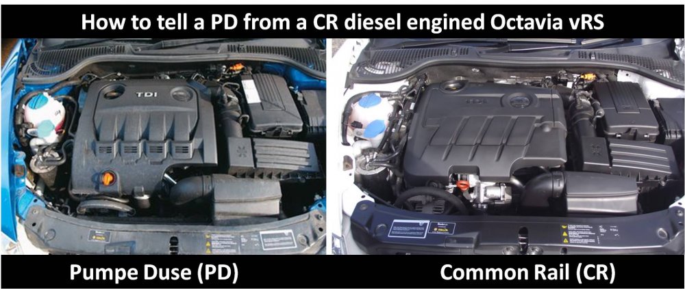

I have a PD170 vRS.
Buy a CR engined one instead, if you can stretch to it.
I had a PD170 and the DPF basically strangled it to death.
Either get one with a proper DPF delete or save up a big longer for a CR170 (2008/9).
