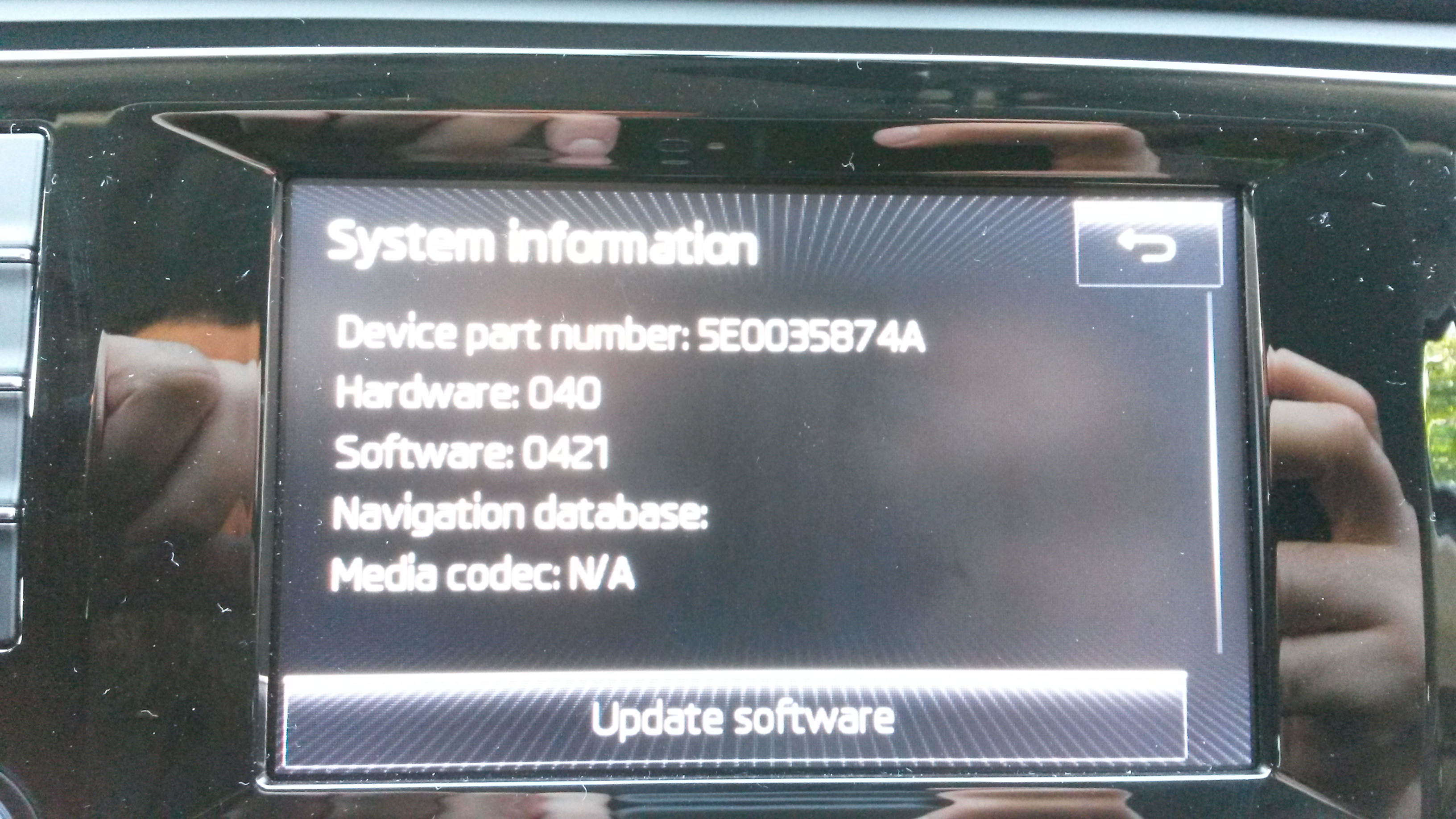

Hi there! I'm new to this forum so I hope i'm posting on the right topic (if not, sorry). I'm from Romania and I recently bought a skoda octavia Mk III (1st registered in september 2013) from Germany. It has the Amundsen infotainment system, but I don't know wich model. Could someone tell me how can I find what kind of Amundsen do I own? It has BT and Navigation, but I didn't recieve the SD card with the maps. I talked to a Skoda representative and he told me that the SD card is ~420 euro. I think it's a bit "spicy", considering that I saw some Skoda Sd cards on Ebay for ~70 euro, but from what I read, not all the Skoda Sd cards on ebay are compatible with my type of Amundsen infotainment system. Here is a picture with the system information. Thank you for your patience, for reading all my post :)
A 2013 O3 will have a MIB1 Amundsen - confirmed by the SW version number shown.
Get a Skoda SD card with part number beginning 5E0 051 236 followed by any suffix letter, then download the latest 2017/18 maps and copy them onto the card (if it's a really old card you may need to reformat it to FAT32 with 4K clusters).

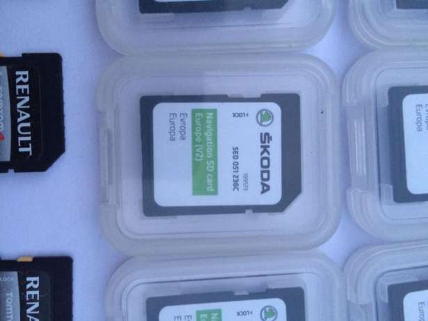

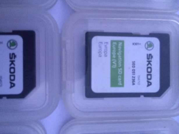

Hello again! I found a guy that has two such Sd cards. One of them is this:
and this is the other:
Can you please tell me what's the difference between Europe v1 and Europe v2? And wich one does suit my Amundsen Mib 1 best? I will use it traveling to Italy, Germany, Austria, Greece etc. I live in Romania, so I want to have that on my card too (so both the western and the eastern Europe). I would very much like if you can shed some light on this matter. Thank you!

41 minutes ago, Daniel22 said:
Can you please tell me what's the difference between Europe v1 and Europe v2? And which one does suit my Amundsen Mib 1 best?
v1 is just older maps than v2, both are very old - since you should (free) download and copy onto the card the newest maps (which cover all of Europe) then it doesn't matter which you buy IMHO.
