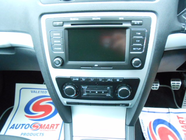

Just got myself a lush Octavia Scout 2010 and the stereo needs upgrading!
I've been used to MP3 folder playback via USB, Bluetooth Iphone connection for calls and music etc on my old Sony head fitted in my old car
I'm looking for a unit that will fit easily in my car and keep the climate control/reverse sensor system working, plus give me Sat Nav, BlueTooth phone connection and also if possible USB music playback

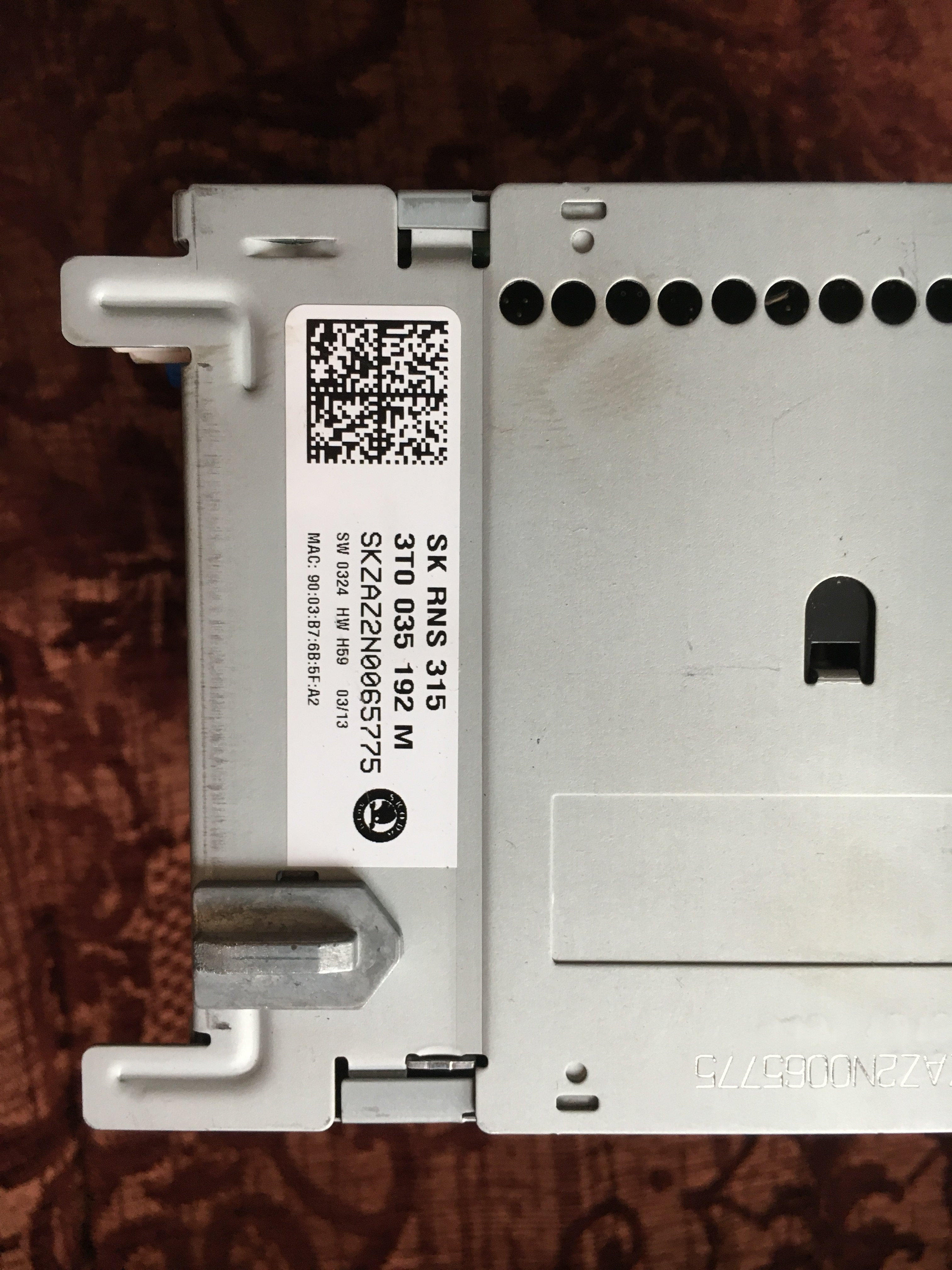

Now see, that one has a listing which says it has Bluetooth, but then further down it states it's "Bluetooth compatible". That would tell me either the seller has no idea what he's selling, or he knows exactly what he's selling and is adding confusion by mentioning Bluetooth when it actually hasn't got it. It's also overly expensive, given that it doesn't have DAB. And the photos show a maps version of V4 which is well out of date. Updates for the Amundsen + are expensive.
This one shows the data sticker in the photo and it confirms the unit has Bluetooth (look for the Mac number being a genuine string of numbers rather than all zeros on the non Bluetooth ones). Shop wisely...

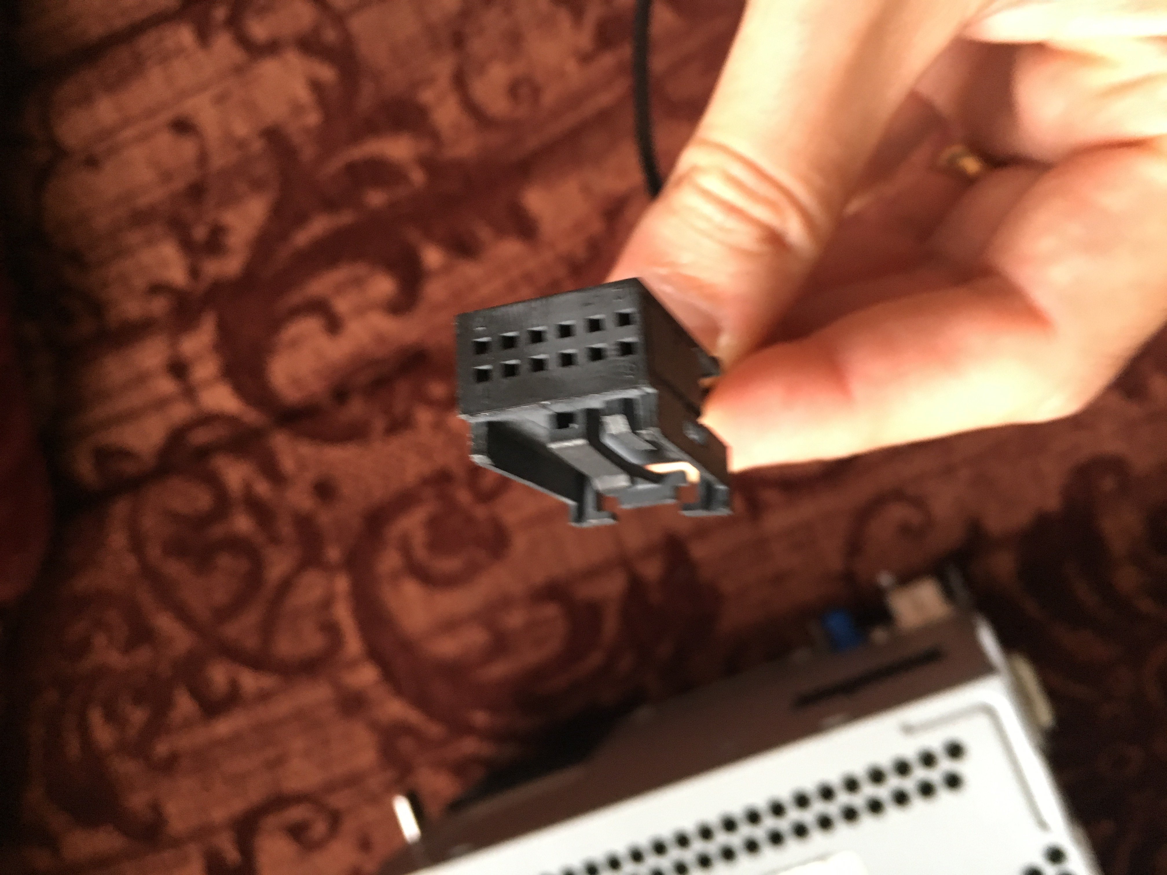

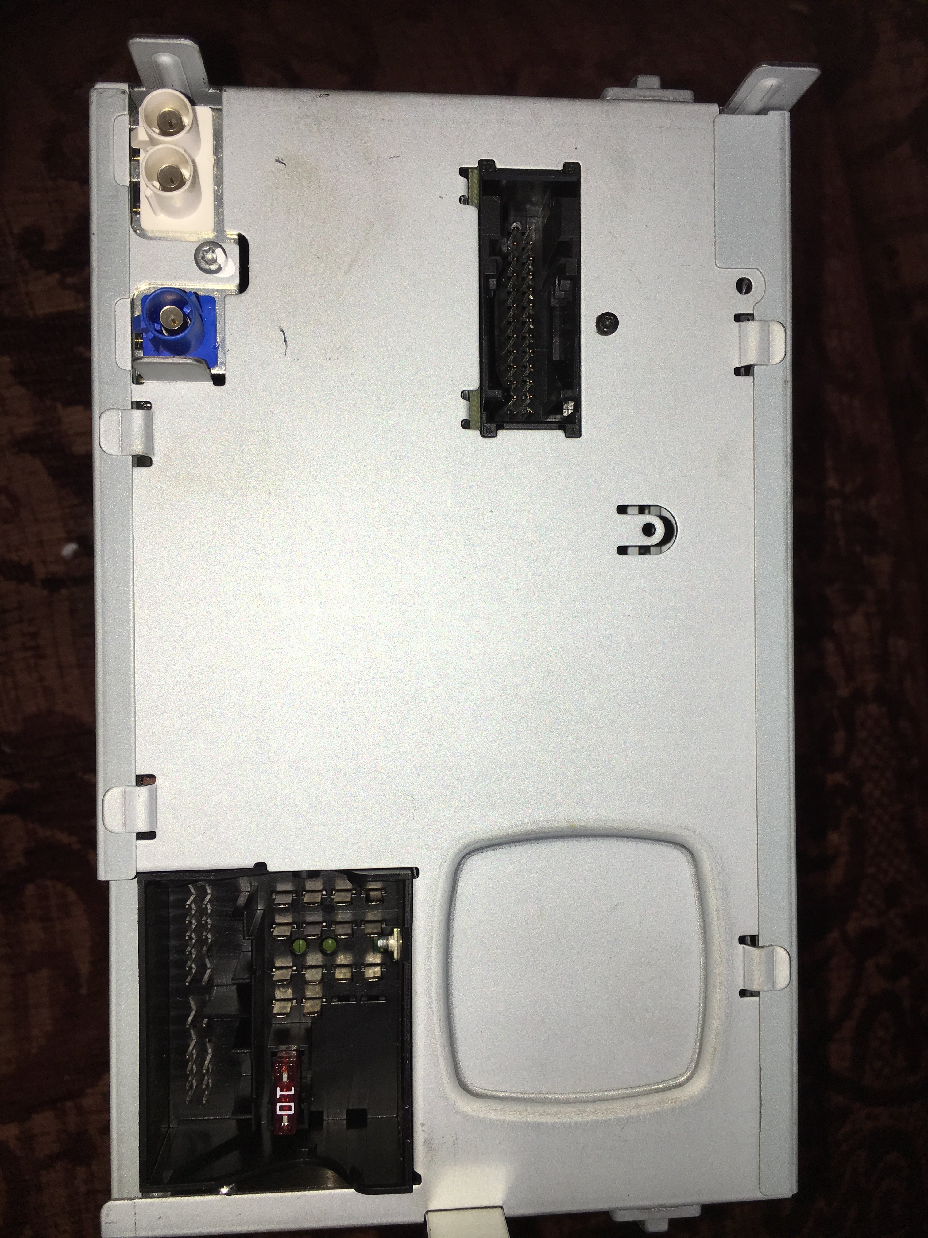

OK - so bits ordered are starting to appear, including the Amundsen+ head unit (see pics), and the microphone bits plus GPS antenna
The GPS antenna looks to have the correct connection to go to the new blue port on the back of the head unit, but the connector for the microphone long cable to go into the back of the unit I can't see where it would go?
It sort of looks like it would fit bottom right? But the standard 2 connectors that go in the existing Bolero go here? Have I got the right connector???
I have a super-helpful forum member on here ( adamal ) who is going to assist me with install and coding, but I don't want to roll down to him to find I've got the wrong bit?
Can anyone confirm how the mic lead connects to the back of the amundsen?
Ta :)596f506b08004_IMG_43481.thumb.JPG.ed73d6219846253b3cdd11d456db908f.JPG596f510166c9d_IMG_43501.thumb.JPG.4abf1095986e6d670b16d766d2c0263c.JPG
The microphone plug goes into the quadlock connector on the cars wiring loom, and this goes into the large square port where that 10a fuse is.
