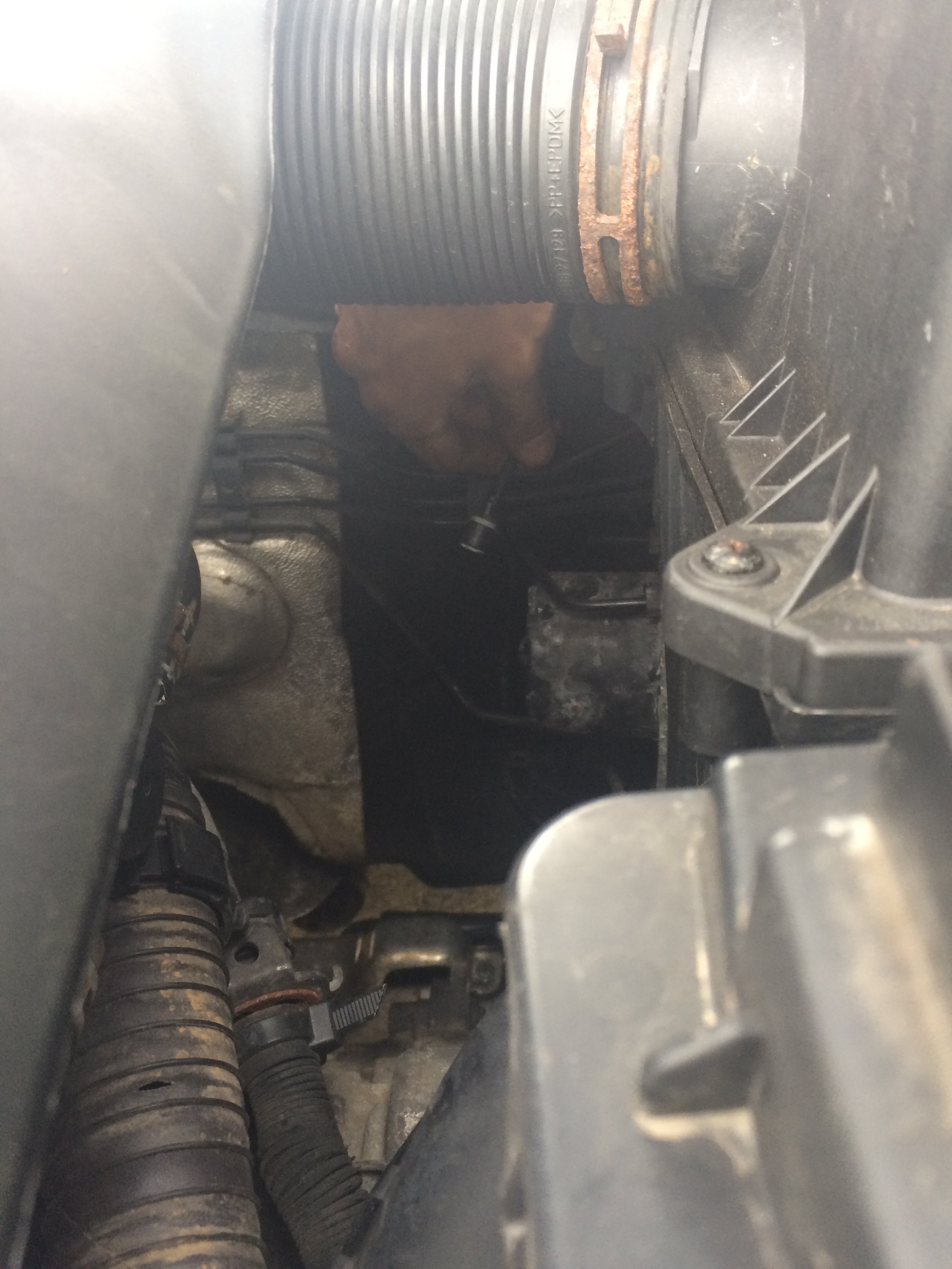

Looking down into the bonnet, thats the link in my hand. It's located underneath the windshield water run off vents, that's the air filter housing in the top right, to give you an idea where it is.

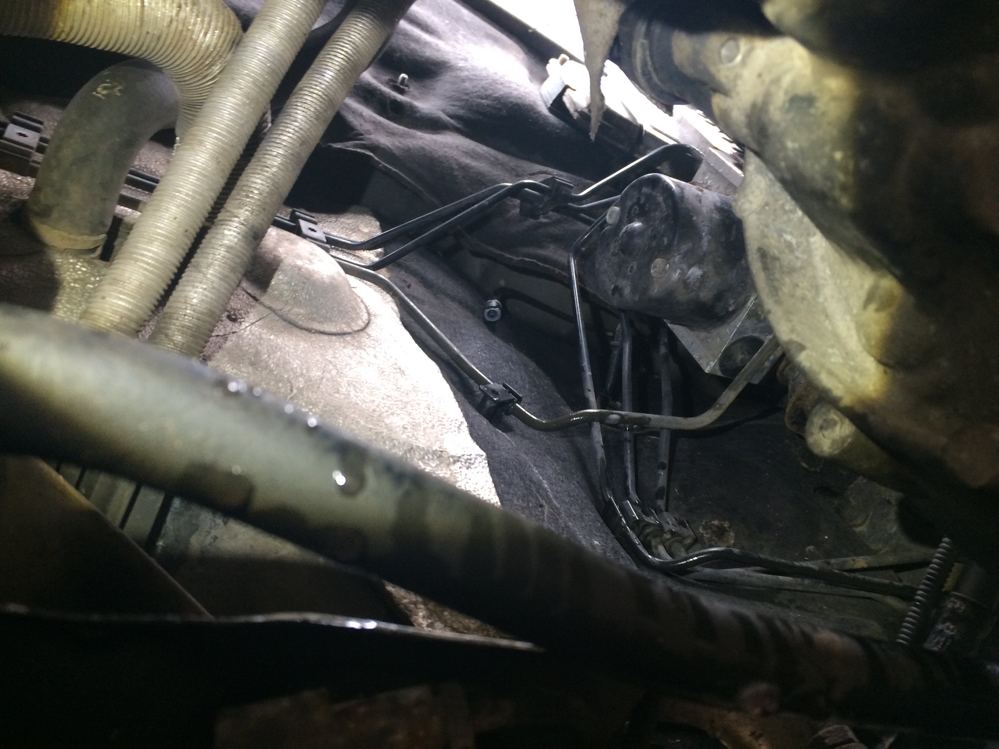

And from underneath, dead central in the photo.
If someone could have a look where this should lead, where it goes for example, and if it's clipped to the car in the bonnet anywhere, or what general path is takes, I can look for that in my motor and just find and reconnect it. I couldn't see any hoses or pipes of the same diameter hanging around in there so I'm thinking it might have fallen into the bodywork of the car somewhere.

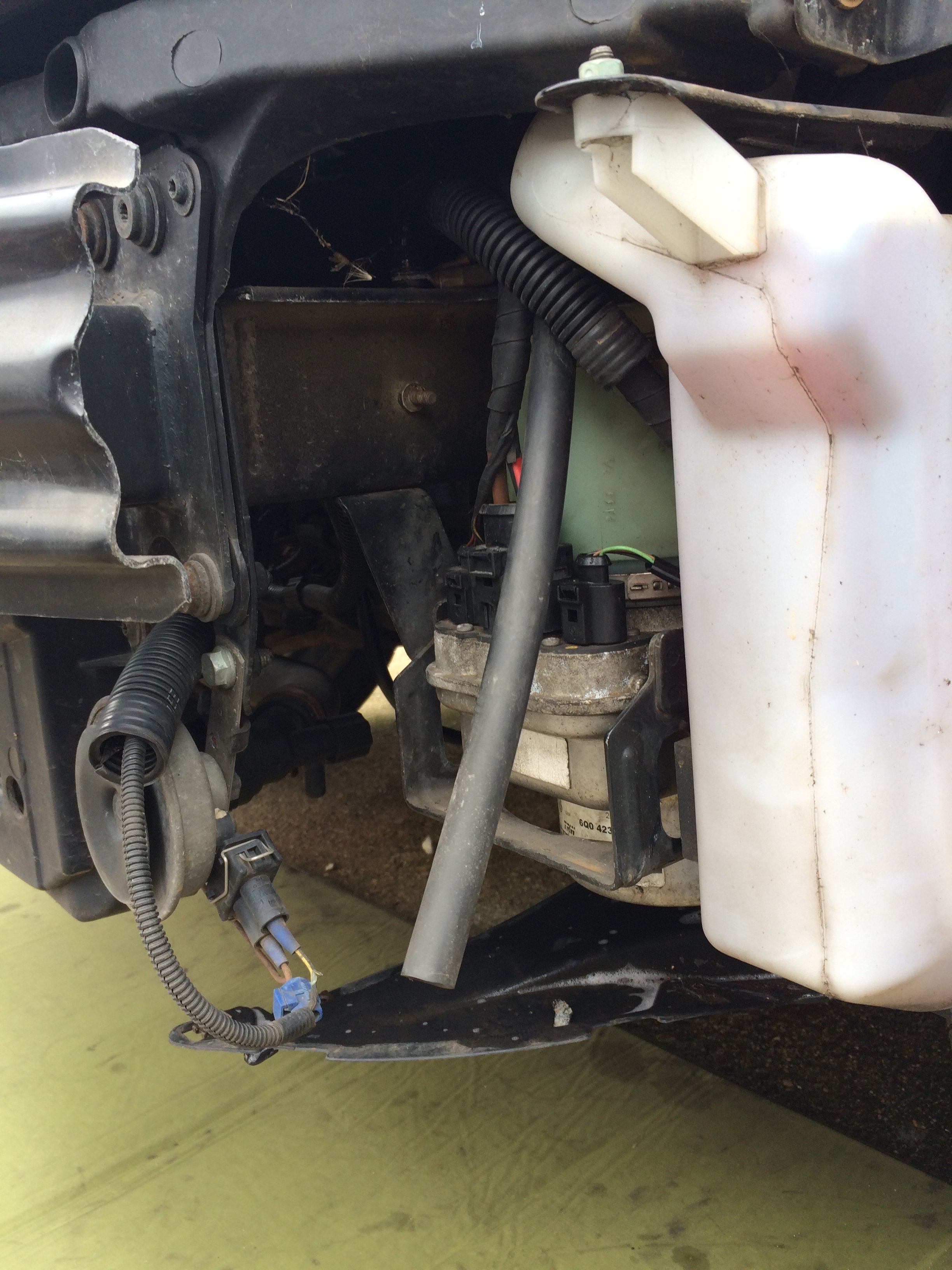

This was a length of thick rubber hosing, I thought maybe an overflow drain pipe for the coolant, but wanted to be sure it shouldn't be plugged in somewhere. That's the coolant reservoir on the right.

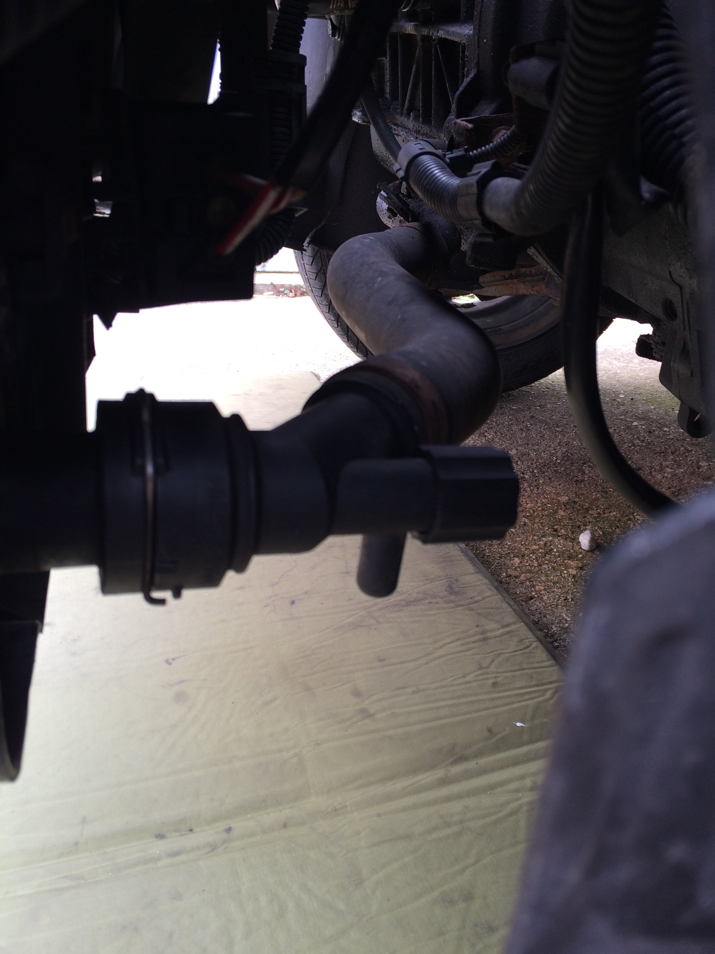

And this, which in hindsight I guess is the coolant drain tap, but better safe than sorry.

The thick black hose is a drain point for the battery tray incase any water gets into the battery tray when you wash the engine bay...
Hi, rear washer pipe work and leaks , absolute pita on ours I've with difficulty and many a bad word plus a fair few scratches managed to join the pipes together just where they go through the bulkhead and get a plastic cable tie around the joints, another place mine leaked was under the carpet in the rear passenger footwell, FYI when the water freezes in the pipe and the rear washer is operated the joints open under the pressure from the pump against the froozen water ( this also takes out a couple of fuses can't remember but you lose your wipers !! pretty well documented on here ) best to ensure windscreen washer bottle water is 50/50 with screen wash through cold weather
maybe not the answers you seek but hope this helps
I cut the pipe connectors off mine and used Halfords 5mm vacuum tube to sleeve them. They have it in packs off the shelf.  Never had any more problems since then. Just make sure to have the correct screenwash strength in cold weather.

TMB, I've had a look at your pictures on the other thread and it looks to me the bulkhead fitting has popped off, cars hot at the moment and I've got 6 episodes of Game of Thrones to get in so I'll have another look in the morning.
Good idea with the vacuum tube as well, I'll get some heatshrink and do a similar job I think, really good idea.
