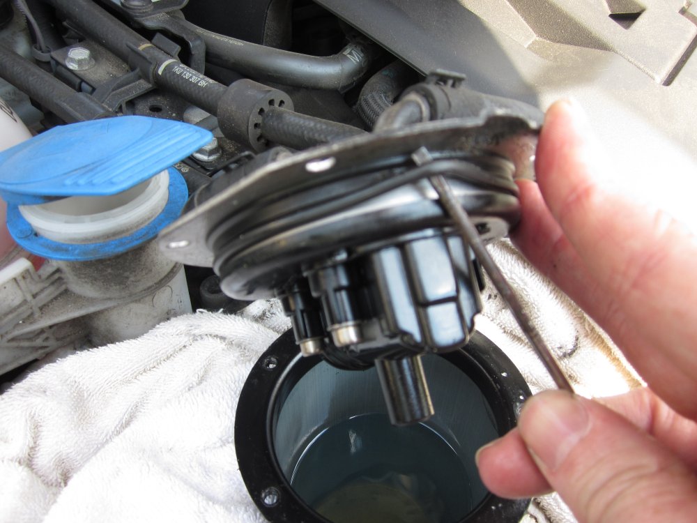

Take a picture of the sticker on the fuel filter housing...
Image result for vag fuel filter housing

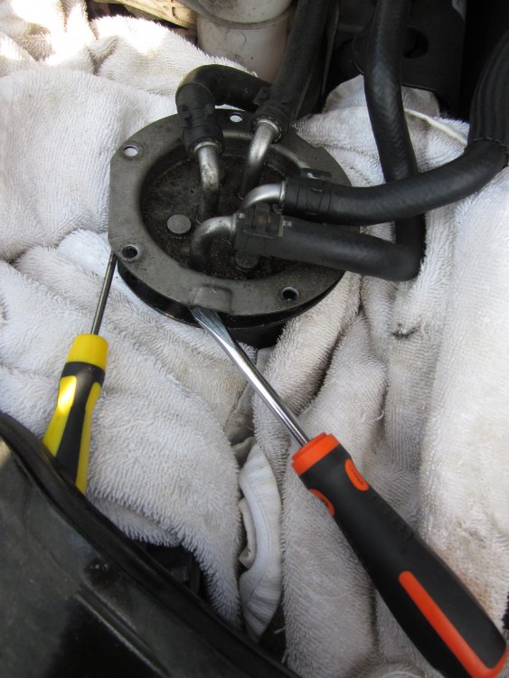

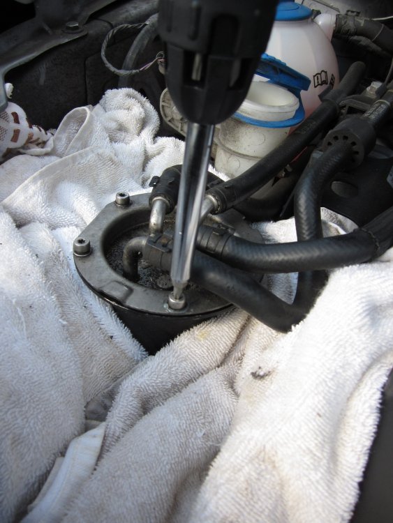

Some people aren't very careful when removing the fuel filter housing lid, it is important to apply equal pressure in multiple positions around the rim to properly distribute the pressure...
Always, always replace the seals...
What works for me when refitting the filter lid is 4 small sets of mole grips around the top applying equal pressure while screwing it down, doing it this way i have never had them leak, and yes always use the new seals provided.
