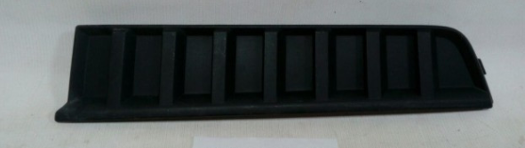

It looks as if you need a couple of these (they're left and right handed and also different if you have parking sensors).

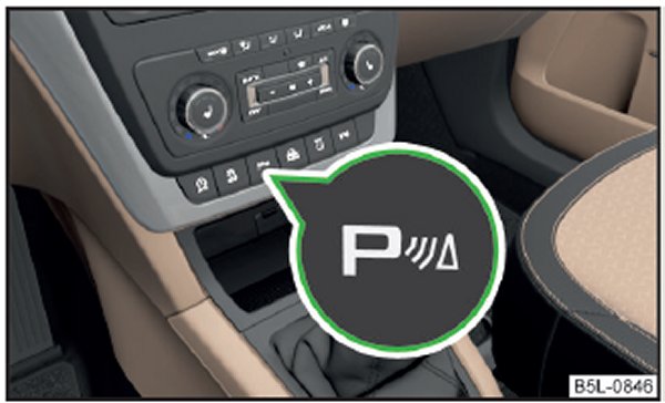

If front sensors required without first putting into reverse just press the switch just in front of the gear lever.
Also if they are on you can press that switch to turn them off.

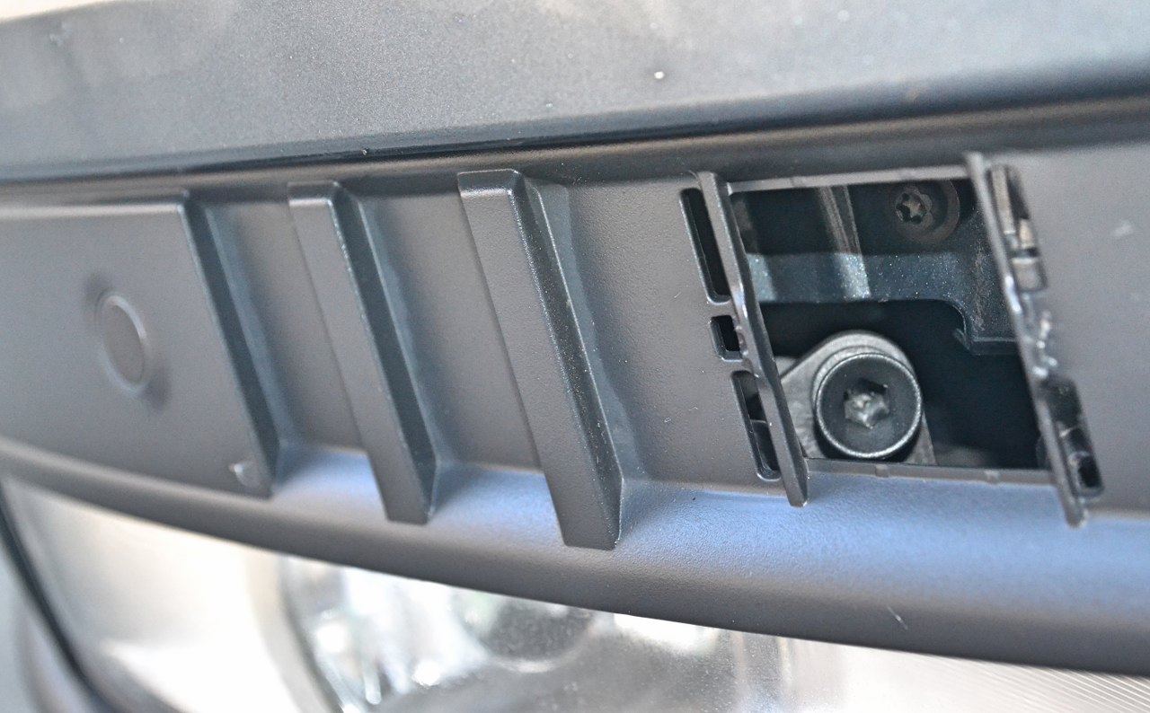

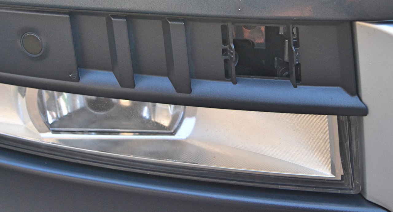

Thanks again everyone, here's a picture of the offside, but the nearside is the same (just the other way around), the little circle is the parking sensor ?, there are two more either side of the front number plate, the issue is the exposed hex bolt, this looks as though it should have a cover, missing both sides.
Thanks, that's great.  Does it have a symbol on it ?
Yes it is a letter 'P' firing rays at a beacon sort of like this P))A
Great, found it, tested it.  It was in the manual which I haven't read yet.  Manual is so much better than my 2011 Octavia which was very confusing.
Any further thoughts on the missing covers and what the hex does  - see pics above ?
No doubt the dealer will fix, but I'm curious to know what the screws do and WHY on a new car would need both to be removed and not re-fitted ?
They are pull off parts to get access to the screw that holds the fog lights in.
Just trim pieces but they should be there.
I had front parking sensors retro-fitted.  When the job was finished the guy who did the work (excellent work by the way) didn't have these two small click in covers which he sent to me the following day - as said before, they just click in place.
