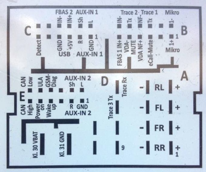

Can anyone tell me if you can fit a reverse camera to the Columbus radio on a 2010 superb estate elegance and also are they fitted with reverse sencers
Yes, you can add both low and high camera.

Where do I fit it on the radio and also what is the spare facro cable behind radio
I have a discover media MIB2 and this cable worked for me to enter a composite cam signal into the radio :
It's FBAS1 in+ and in- pinsIMG_5253.JPG.3f8a63882ae33ce3dece44d669a23924.JPG
Yellow one ?
USB
