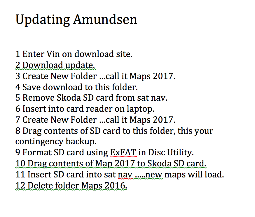

1 Enter VIN on download site and download update
2Unzip and save to desktop in New Folder call it Maps 2017
3Remove skoda SD card from car and insert into card reader on laptop
4Open card and drag contents to desktop in New Folder call it Maps 2016 ...contingency backup
5Format Skoda SD card
6Drag contents of Maps 2017 to SD Card
7Insert SD Card into sat nav....wait to load
8Delete Folder Maps 2016.
Job done.

These instructions worked for me ....Mac Book Pro...Sierra 10.12.6

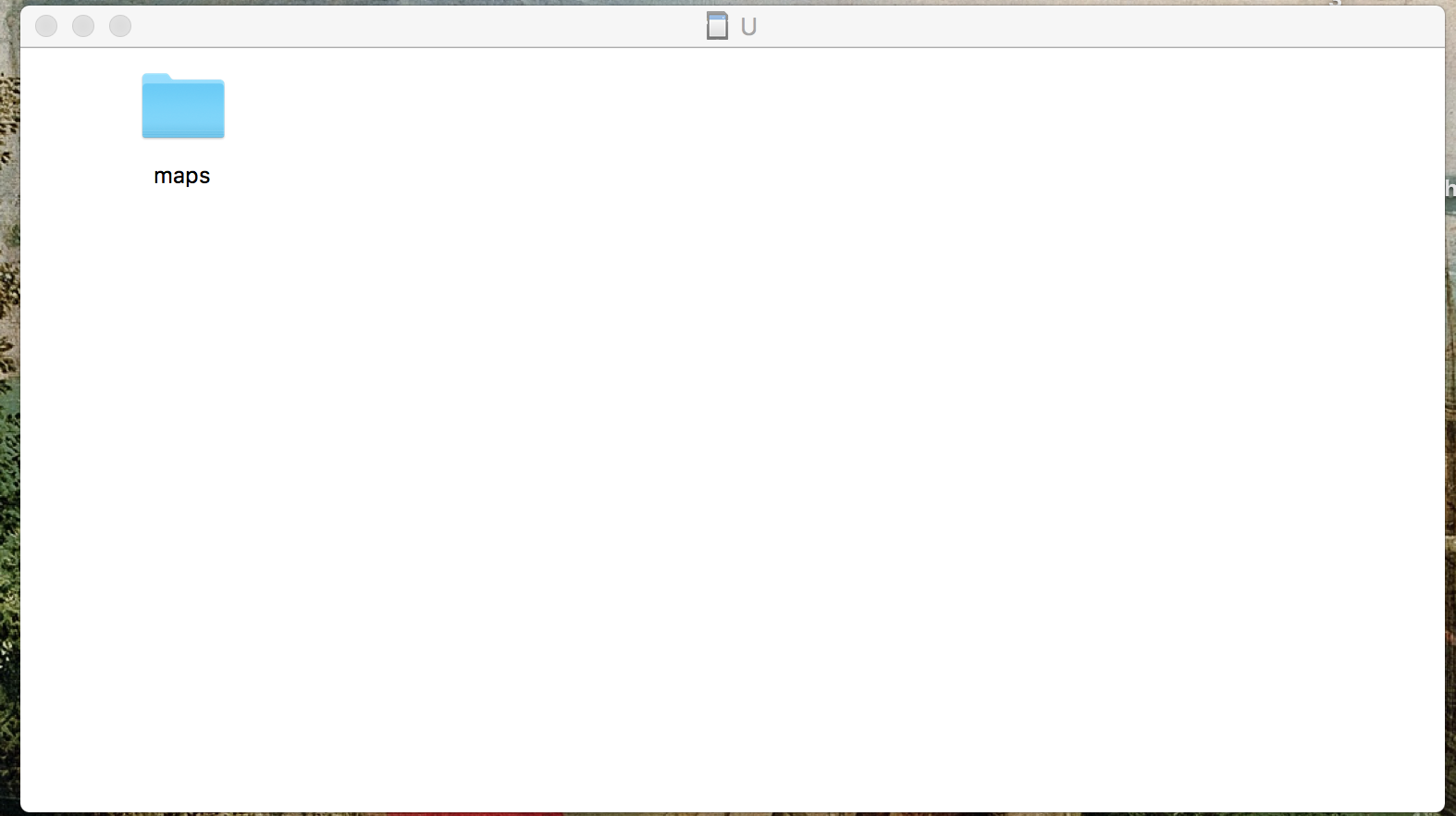

Okay so I drag both the 'Maps' file and the 'text' file in the download to the Skoda SD card?
Hi...text file not needed...drag and drop Maps file.
Have just taken SD Card out of car and put into card reader and taken screenshot of contents

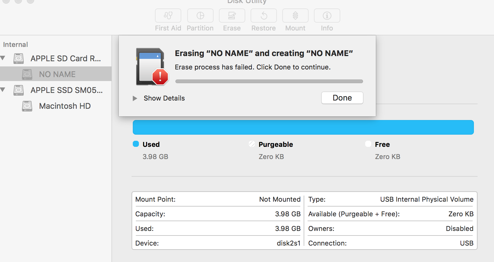

Okay - I have mounted Skoda (No name) SD card onto computer and dragged the maps file to a back-up folder. Problem now is that I can't erase - reformat the card. Everytime I try I get a message saying "Erase process has failed Click done to continue", also image of SD card has a red ! over it in the window.
Tried several times and still get same message. Anyone any ideas?

More problems, now when I put the ~SD card into the computer I get a message saying "the disc you inserted is unreadable by this computer" Now truly in the ****. Anyone able to help or advice?
Is the SD Card locked ?

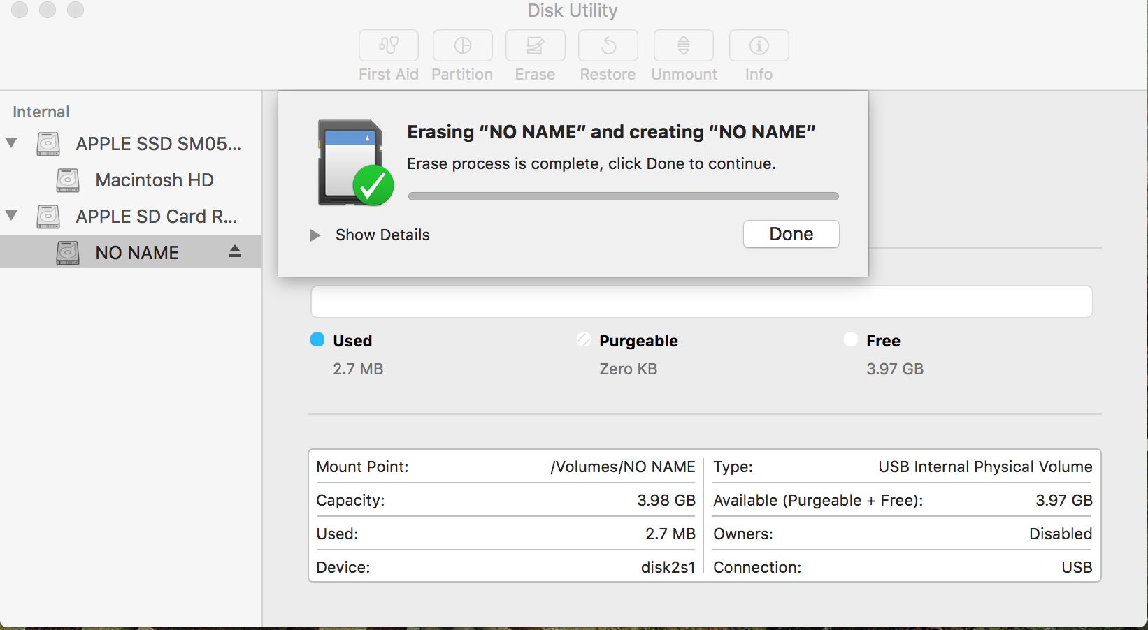

If you put unlocked SD Card into card reader and use Disk Utility to erase using ExFAT it will work.

Thanks - the problem I had was that after trying to reformat the computer would not recognise the card at all. In desperation I reformatted the card in my camera then transferred back to the computer, computer recognised it then I used Disc Utility to reformat the card to ExFAT, seemed to go okay and got 'green tick". Am now reloading the new maps from the folder I saved the downloaded maps to. Fingers crossed and it works now??
