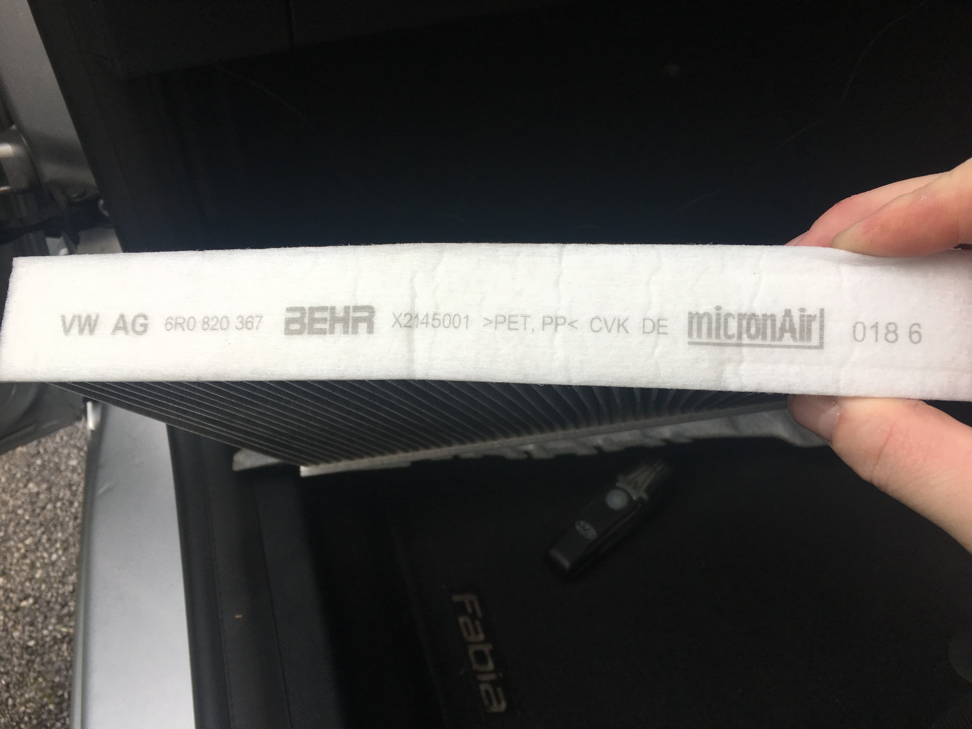

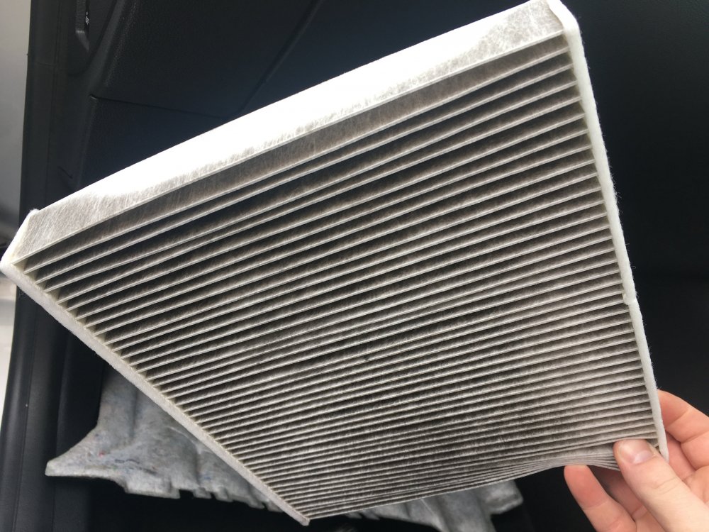

Eyeball the pollen filter first, looking for a manufactured date on it (on one edge I think).  If that really hasn't been changed as claimed by the main dealer, you'd have a good case I should think.
Cant see  a date on it tbh, looks like it probably has done the 5k from the last service though? Doesn't look like its been in there too long?
  • Sponsor
Yeah that looks recent.
