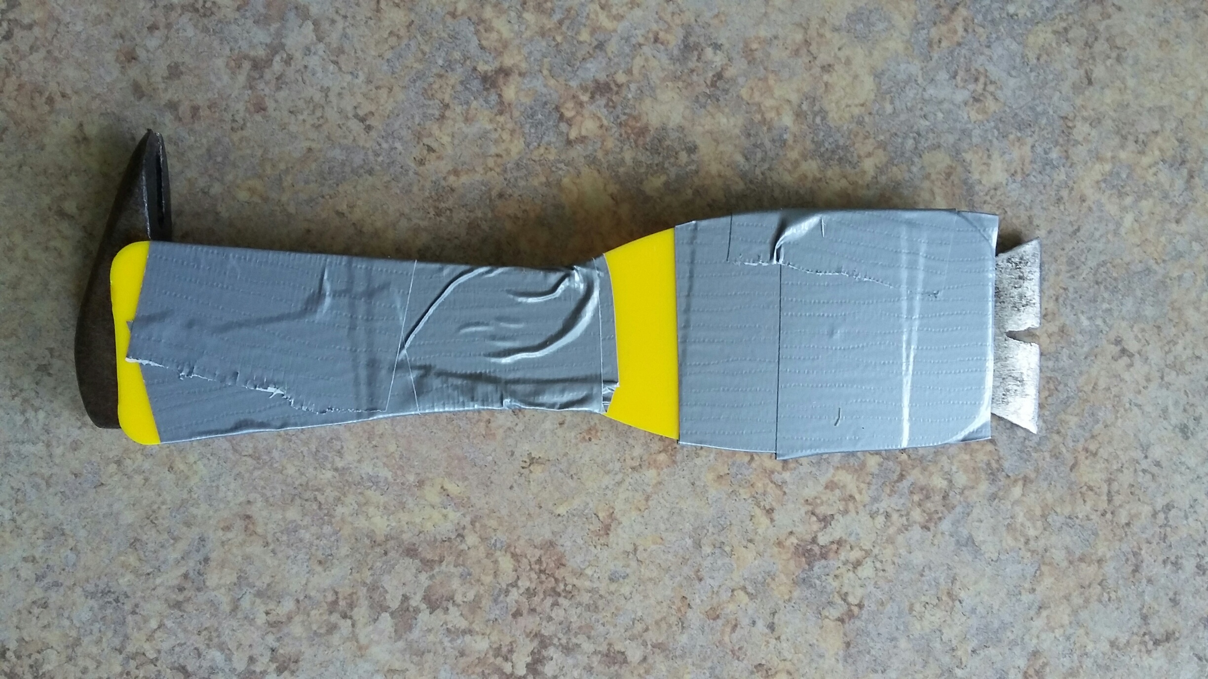

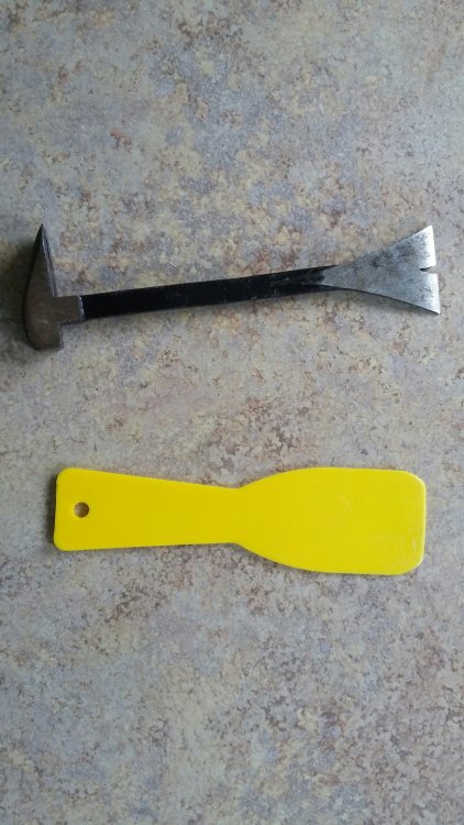

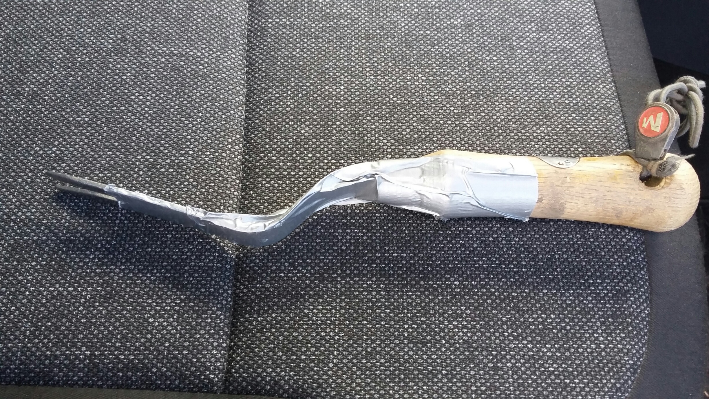

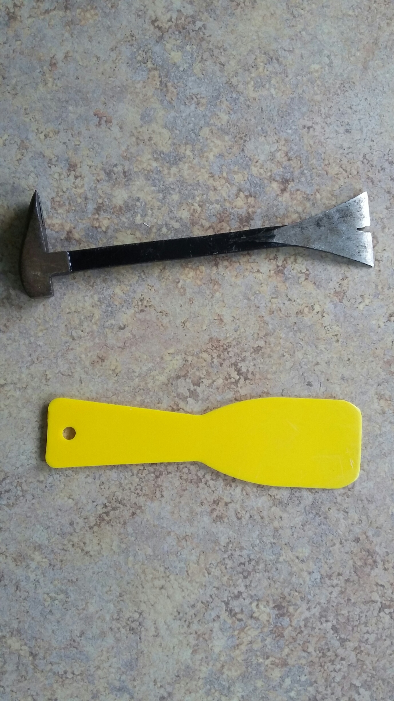

success
improvise a couple of tools as the standard orange plastic trim tools were just not up to the job.
started at nearside top clip as and worked around the edges

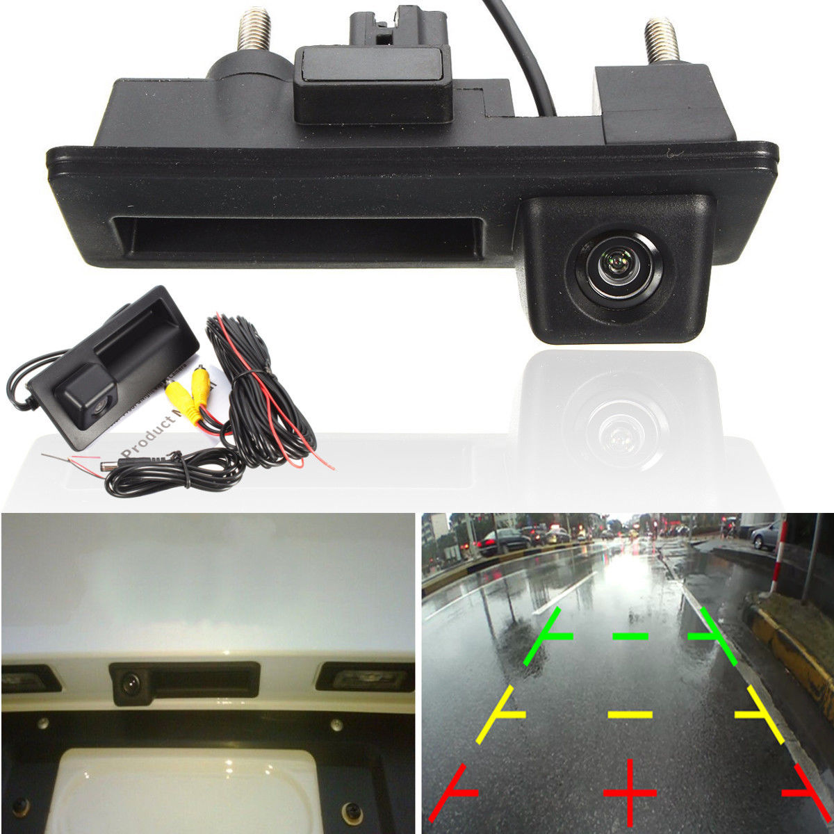

THIS IS THE CAMERA
http://www.ebay.co.uk/itm/Rear-View-Reversing-Camera-Kit-for-VW-GOLF-JETTA-TIGUAN-RCD510-RNS315-RNS510-12V/361991947880?ssPageName=STRK%3AMEBIDX%3AIT&_trksid=p2057872.m2749.l2649
works great until I switch the engine on ...................
need to sort out a stable 12v supply (not reversing lights) or use capacitor and diodes, will post another thread when sorted
