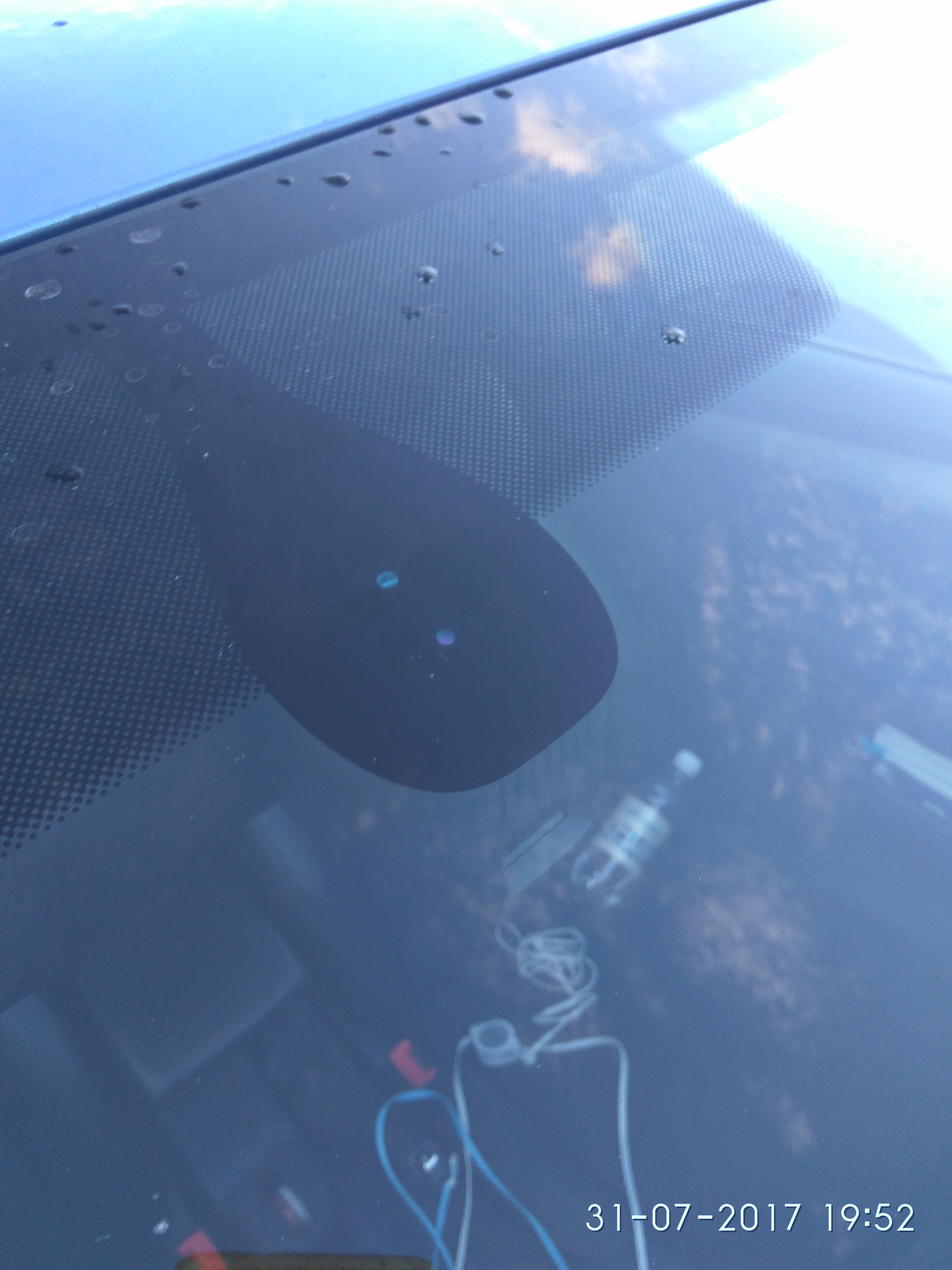

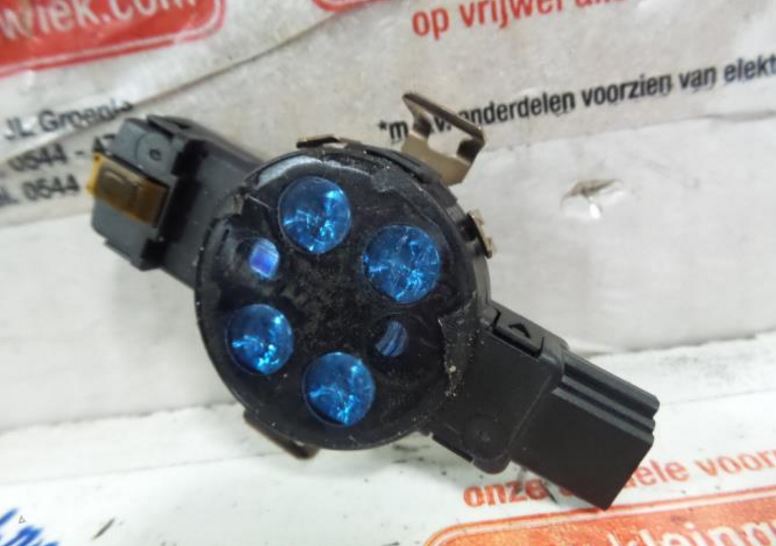

As some of you know that I had a light/rain sensor and hba controle module faulty..so my seller replaced the Light/rain sensor plus the whole rear view mirror to get these issues fixed..apparently I have noticed that the light rain sensor they put is quite diifferent the one I had before..original one had total six blue coloured sensors in a circular look, like all the Octavia has. the one they put has two sensors only..
look at the pictures below please. 2nd one was the one i had.
Is there anything I am missing? Like humidity sensor,card reader anything like that..why this one has two sensors where the original one had six..could anyone tell me whether I should challange them to get the original one..or they all functiins same..

No, you're not missing anything. The one you had before was fitted up to MY2014 or MY 2015 (not sure) - part number is probably 5Q0 955 547. Later it looks like the one you have now - part number is probably 8U0 955 559C. If you would take it off, you would see it has same number of sensors, just that the 4 big ones are not blue colored, but are dark and you can't see them thru the windshield.

My Octavia has rain/light sensors and is the same as the new one fitted to your car. It works fine and my car was registered in September 16.
Nice to know this..its a great relief..thanks for your chip in threadbear.
