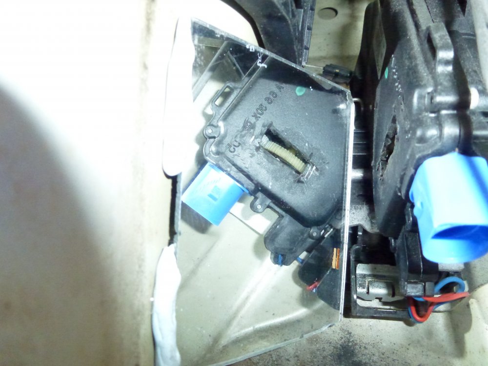

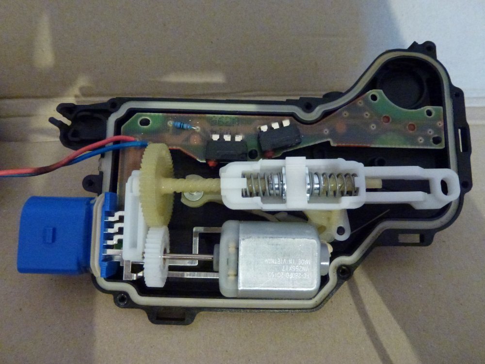

I have done it on 2 rear doors and it can be a pain,After removing the door card I tried one by trying to bash it out with a hammer and chisel and it was a right pain to do and made a mess ! the easiest way is to have a small dremil drill with a blade/disc in it that will cut plastic and you cut an opening in the side of the plastic casing to reveal the edge of a gear wheel, you then have a small screwdriver to turn the cog one way buy about 1/2 inch and also have a piece of small rod to hold the cog in position/tension and then turn the cog another 1/2 inch and you keep going until the lock mechanism comes out of deadlock (see pics) ! cheers Stuart
Edited by sparky2
added pics
Thank you very much! I have a Dremel mill, and I will certainly do this. I already ordered a new lock mechanism from Germany, it was less than 30 euros.
Edited by kansalainen

I succeeded in making a hole to the lock and moving the bigger wheel with my finger.  It moved back to its position,  did not open yet.  Post brought me a new lock mechanism.  Continuing tomorrow.
if you are trying to move it with your finger you HAVE to lock it in that position after turning it with say a small screwdriver as it is spring loaded ! you have to just keep on turning it in one direction until you hear a whirring noise as the deadlock disengages !
