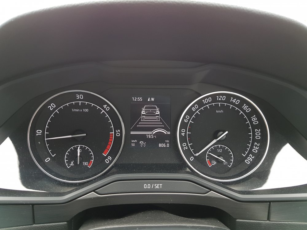

Hi. Retrofitted ACC to my Sup3. If anyone interested , can tell the story with details.

This was quite a painful project :)  A bit expensive too. Not much for parts , but for some parts of the coding. Have to ask for assistance from peoples who have an access to VW SWAP codes and etc.  My part with VCDS and ODIS was not as difficult :)

OK. Just finished story on Russian , will translate and adopt for Briskoda.  If anyone understand Russian - https://www.drive2.ru/l/479561618254987428/

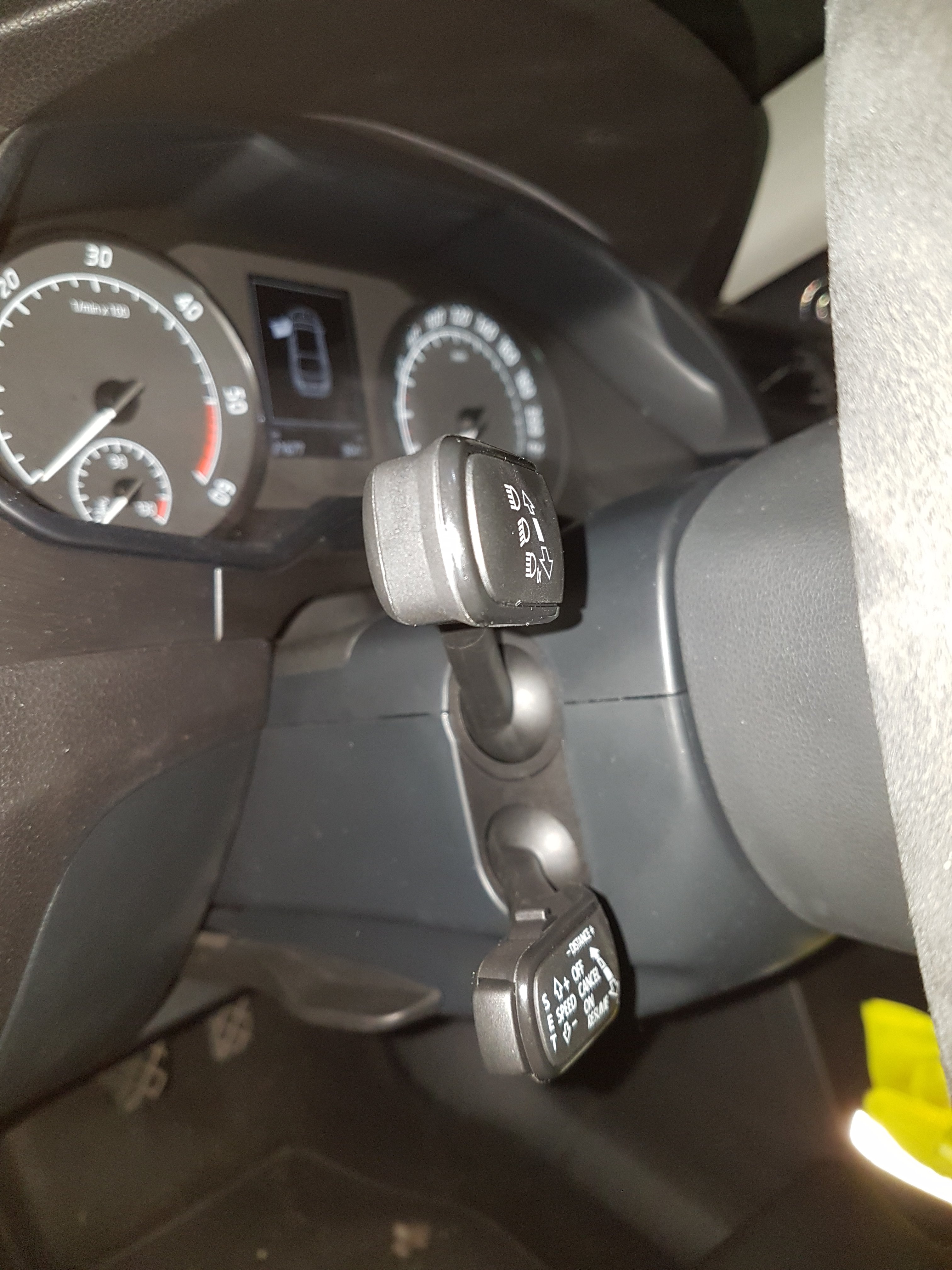

All I need to know is how you can change ACC into 'normal' cruise control.

You can't change it - it is designed as ACC. If you wanted normal cruise control then you'd have to strip it all out and install a different version which kind of defies the point.
Having had ACC for over 18 months now I wouldn't switch back. Drove a colleagues car with normal cruise the other day and it's just awful in comparison - had to keep switching it on and off to maintain flow / change lanes etc. Whereas with the ACC i just let it run.
In my MY18 superb hatch I can have regular cruise or Acc , if I push the cruise stalk away from me it acts as a regular cruise , pull it towards me and it's Acc
I was maybe to quick to comment, Just got the car a few days ago and I was sure it acted like a normal cruise when the stalk was pushed in, but now on my way home from work I found out it just turns off cruise , would of made a lot more sense if it would disable Acc but still work as a cruise.
Not that I mind, Acc works fine in my car
The only difference is that ACC brakes if front car (or car on Right lane from you in RHD if you have this feature enabled)  do the same.  The rest of functionality is exactly the same
