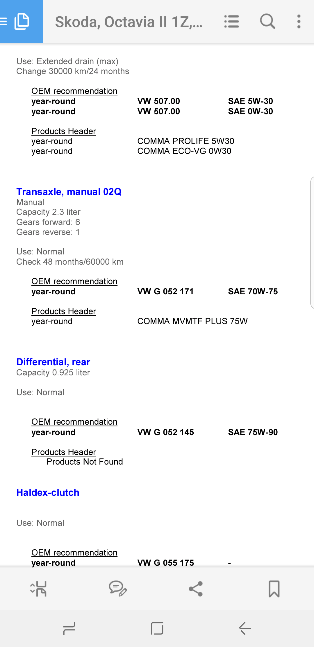

hope some one can help im looking for the oil  specs to change my 2012 octavia II 4x4 1Z driveline oils so, manual gearbox oil, transfer box, rear diff. i know the Haldex oil is a specialist oil so no probs there. ive been on auto data and comma website and google. alot of conflicting info. tried phoning skoda but they are being secretive a holes!!! thanks in advance.

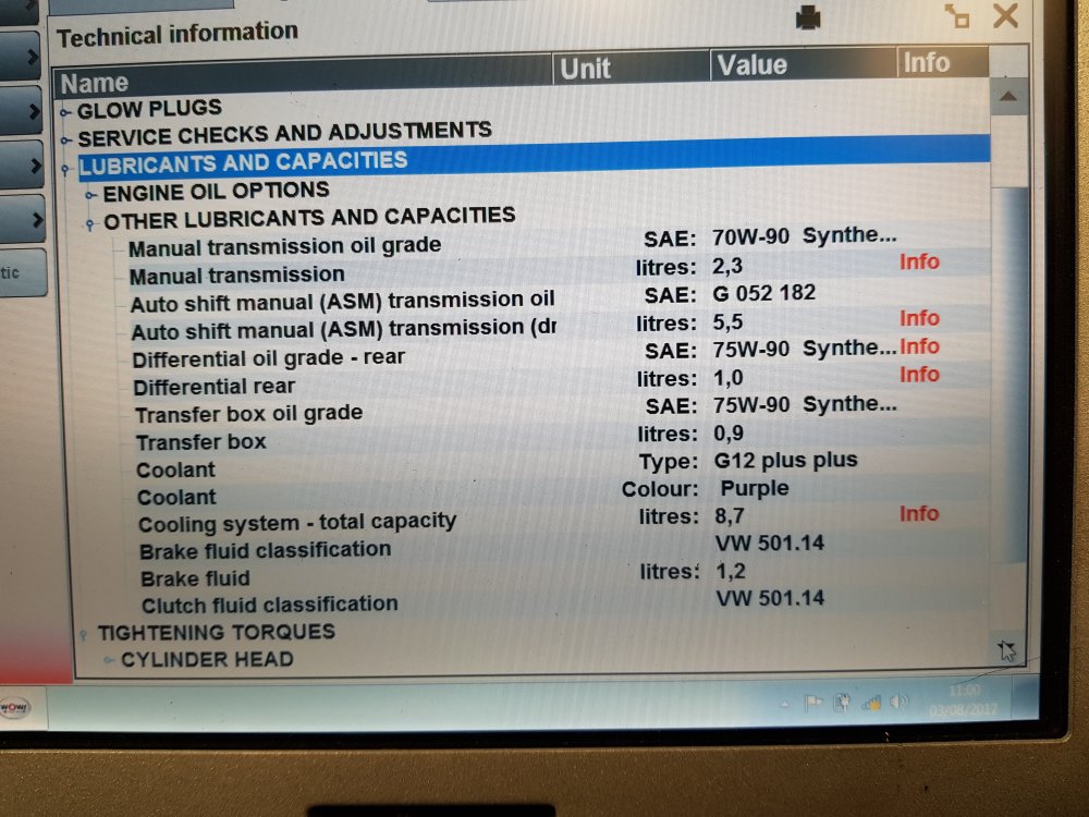

first image is off the auto data program, and second is from comma oil technical help.
mine is MK2 facelift  reg 09   no problem with Comma   but I used Fuchs  Titon Sintopoid FE front and rear diff  -- gearbox Titan Sinto FLUID  g'b' type W04    the haldex on mine is GEN IV obviously double check the haldex and rear diff fill/drain  I guess they have been mixed up by someone in the past
