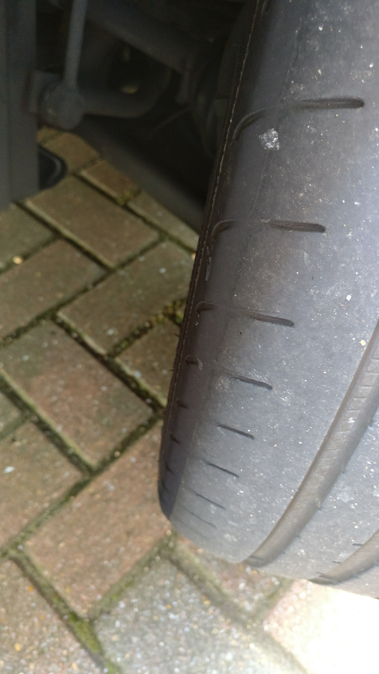

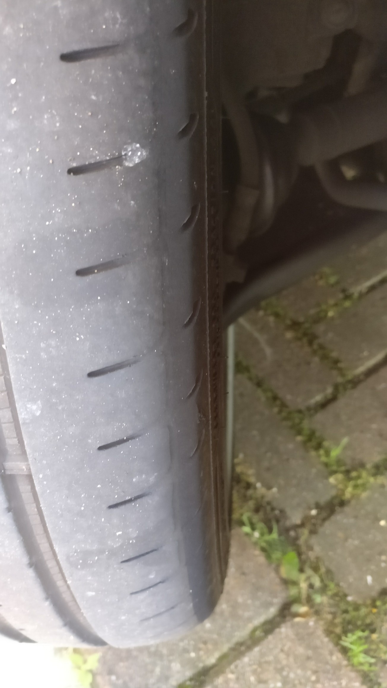

Car has been in for its MOT today and had an advisory for inner tyre wear. I was expecting the usual across the shoulder but this seems a bit odd to me.
Both are the same, inner shoulder but a very tight bit of it is worn. It almost looks like rubbing but can't see on what. Wear is even across the entire tread otherwise.
14,000 miles old and under a year old.

I do have 21 (or maybe 23) roundabouts on my journey to work. I was wondering last night of the tyre is folding under cornering load and allowing that inner edge to scrub. I know these have a soft tyrewall so maybe it isn't quite enough pressure. But then wouldn't you expect the outer shoulder to look the same too?
Looks like inner edge scrub from the roundabouts. Once killed a set of fronts on a Mondeo diesel, very heavy front, in about 10K miles whilst living around Telford many  roundabouts and front end pushing caused the wear.

Thanks all. I've upped the front PSI to 36 (rears are at 36PSI and not got this wear characteristic). Was at 31.5/32PSI (left and right) so a little low. The F1A3 is known for soft sidewalls and so wondering if folding under load. Not sure why the outer edges wouldn't have corresponding wear.

When did you last get the alignment checked? Toe out would cause the inside edges to wear like that.

My last pair of front tyres were both worn on the inside edges which I put down to the tracking being out. Not sure how long it was out for but they lasted 15k+ miles in total.
The other possibility is worn suspension bushes which could cause the front wheels to toe out under braking, but the tracking is where I'd be looking at first.

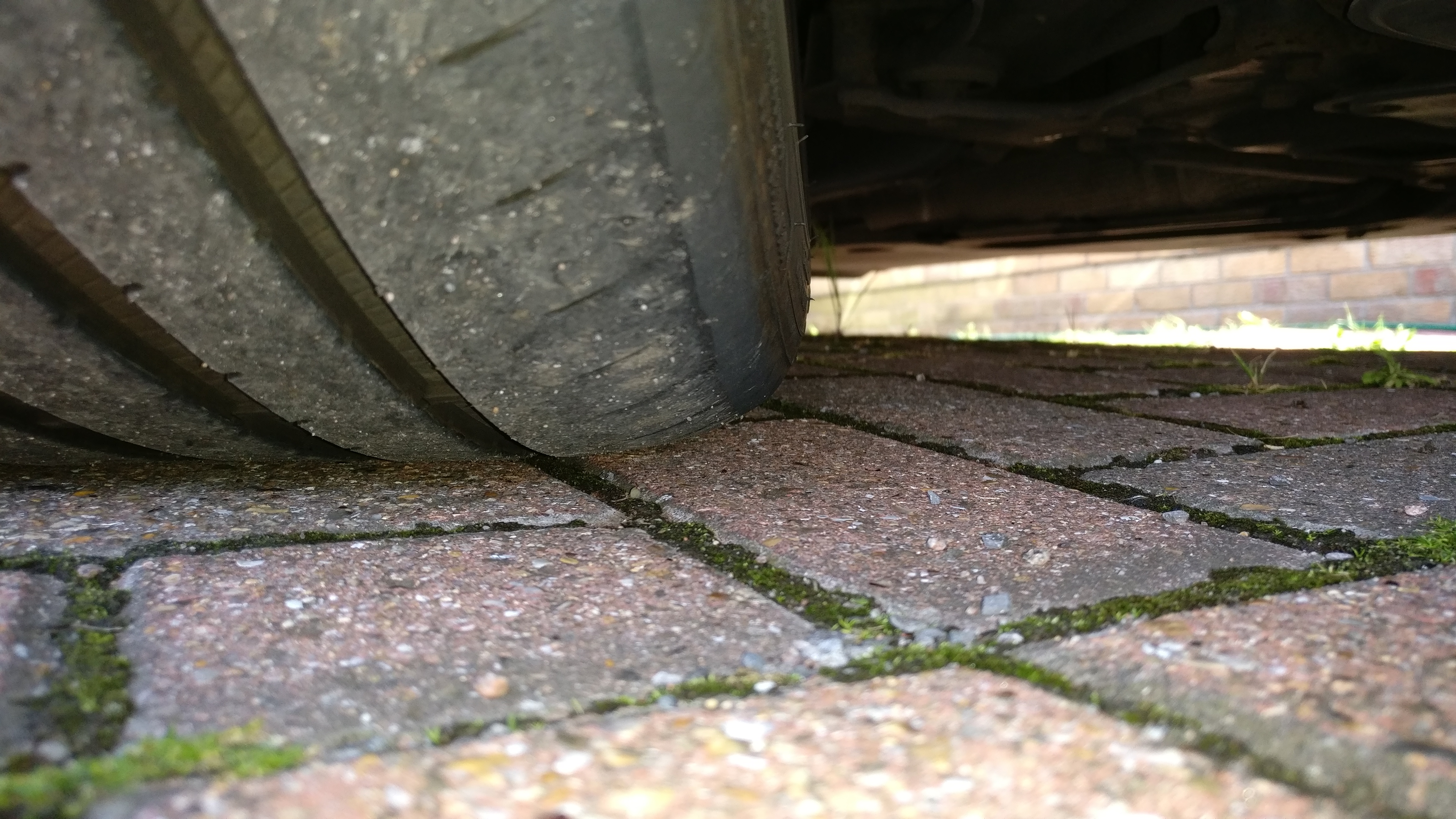

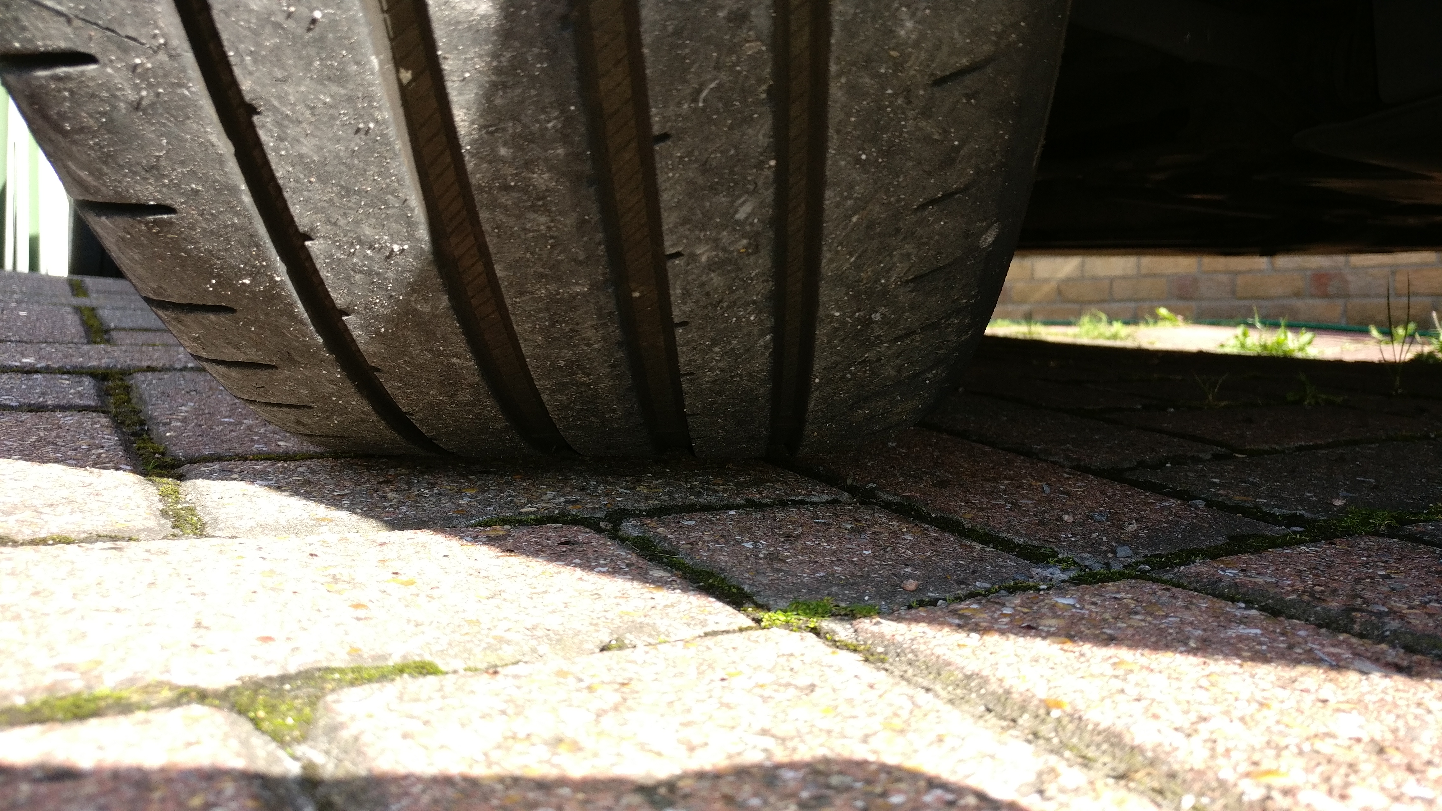

Thanks to all for more input. Here are a few more pictures of the tyres in perspective of the tyre on the ground. As you can see the wear is not in normal contact with the road
This is why I think the tyre must be folding over during cornering rather than tracking being out. Otherwise I would have expected more wear from the shoulder to the first channel (from right to left).

On 8/11/2017 at 10:42, Nathanio said:
Thanks to all for more input. Here are a few more pictures of the tyres in perspective of the tyre on the ground. As you can see the wear is not in normal contact with the road.
It looks like your steering is turned for those photos. The kingpin angle might make it look like the inside edge of the tyre isn't in contact with the ground, but it would be different with the wheels pointed straight ahead.

I don't think sidewall stiffness will have anything to do with it. If it was under inflation you'd expect the outside edge to be worn excessively as well.
