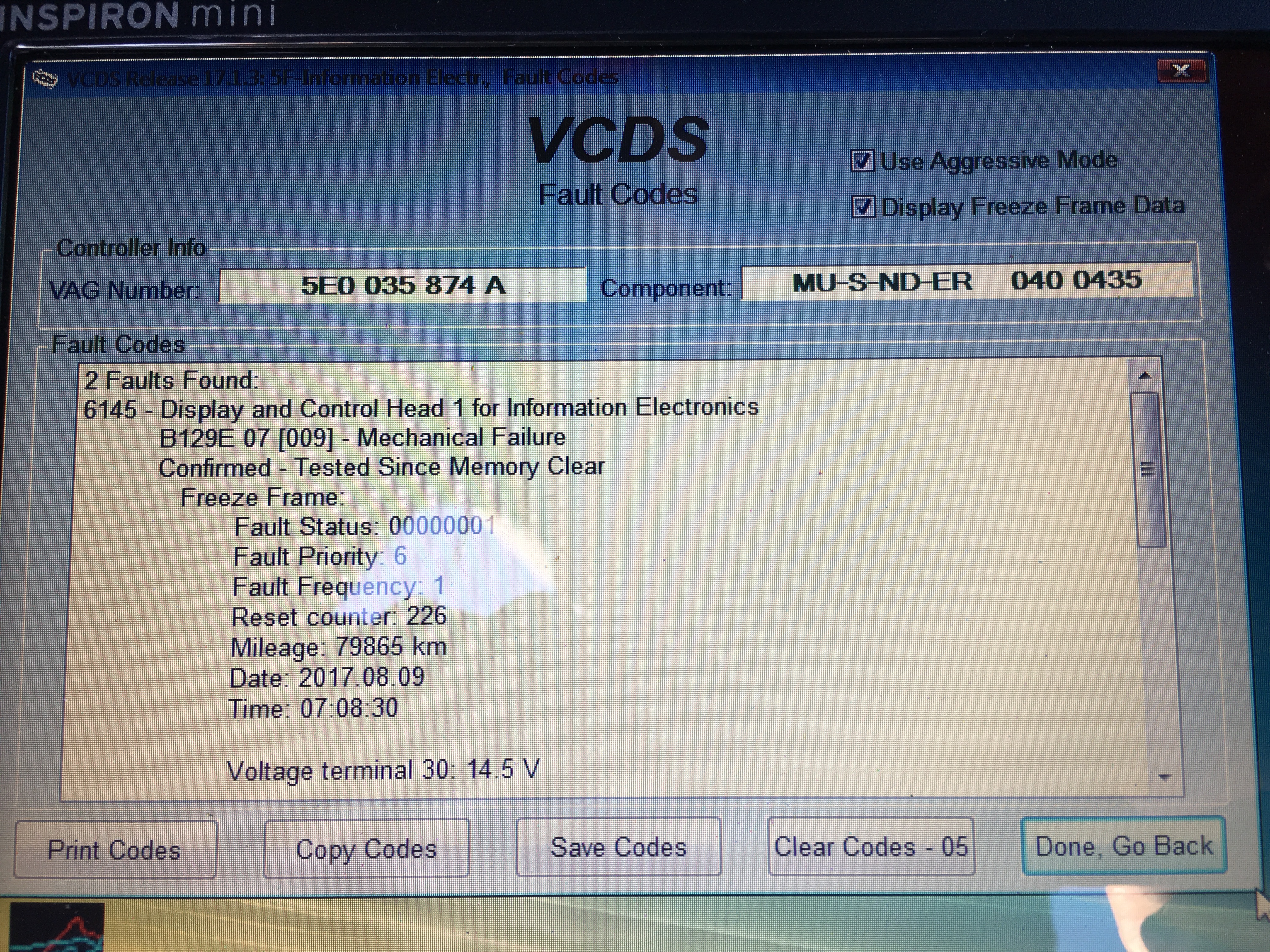

Has anyone ever experienced there Amundsen head unit freezing?
The past two days in the morning going to work the screen has been unresponsive and today all the buttons were also unresponsive. By the time I get to work leave it 2 mins and go back out to the car it is working fine.....
Scanned the car and get (See Below)
Cannot find any information on this though?!
