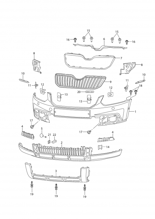

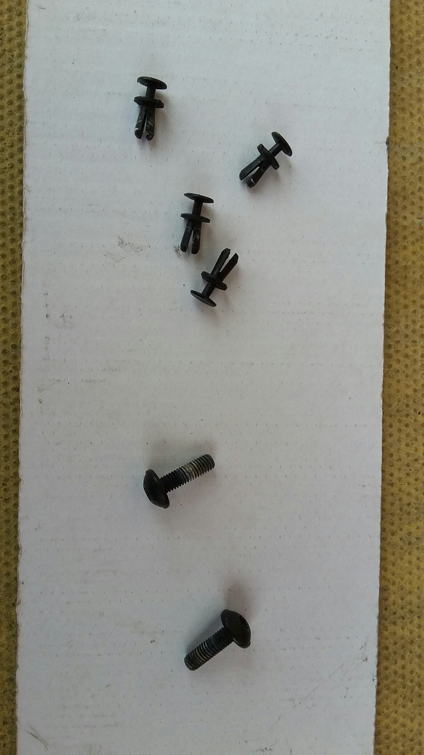

first you have to remove the top black plastic cover (ITEM 6 = 4 plastic rivets (ITEM 15 - lever up the inner circular disc and pull it up then th whole thing comes out the metal hole ) and 2 torx bolts (ITEM 16)
after that, you can now see how the grille bit is clipped in - good luck, doesn't look easy to unclip it all without any breakages.
