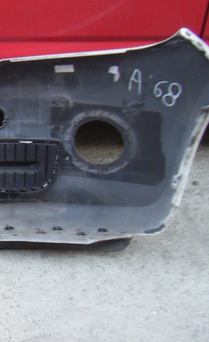

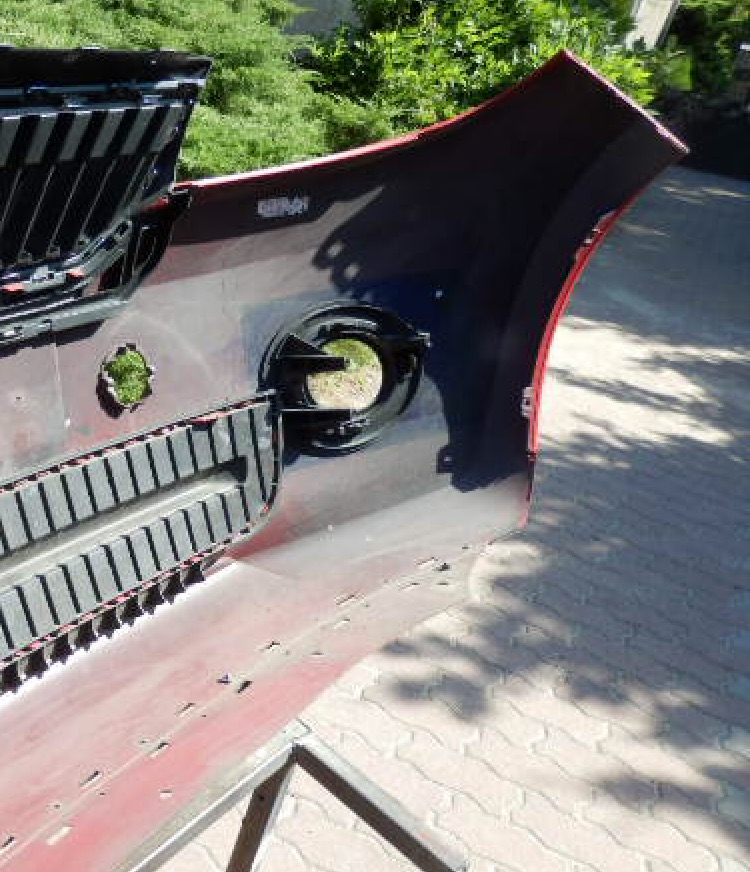

Boom, think I've sussed it, its surprisingly held on with tape (3m by the looks of things) my suggestion, is buy a brand new one (confirm it comes with the tape, which it should), clean the hell out of the area it has to stick too and then stick it on, clamp it for 24hrs then hopefully it will be good.
Here's the part number(s)
1ST807261 (Passenger side)
1ST807262 (Drivers side)
Couple of photos too of what seem to be new ones -
http://www.ebay.de/itm/Skoda-Citigo-Stosstangenabdeckung-Klammer-Frontlampe-NEU-original-1ST807261-F0-/302006768905?hash=item4651019509:g:cfcAAOSwOVpXfU~r I have no idea if this is the correct side!

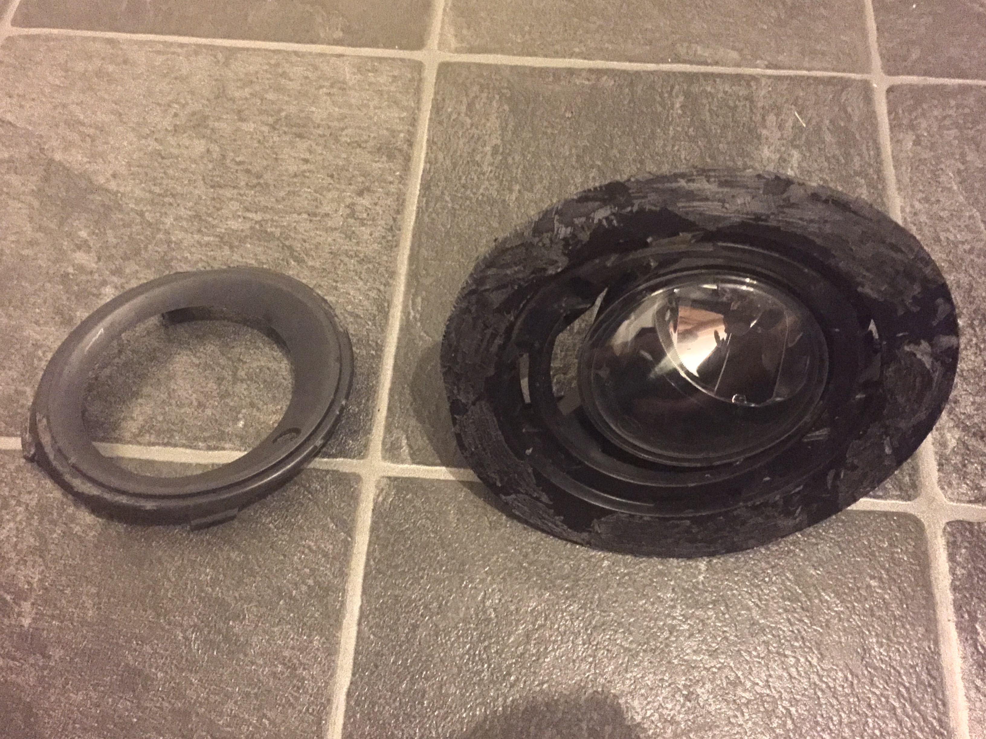

I took it out today. I removed the double sided tape that was left on the unit. It looks like there are 3 and not 2 parts.
The bumper will be cleaned up during the week.

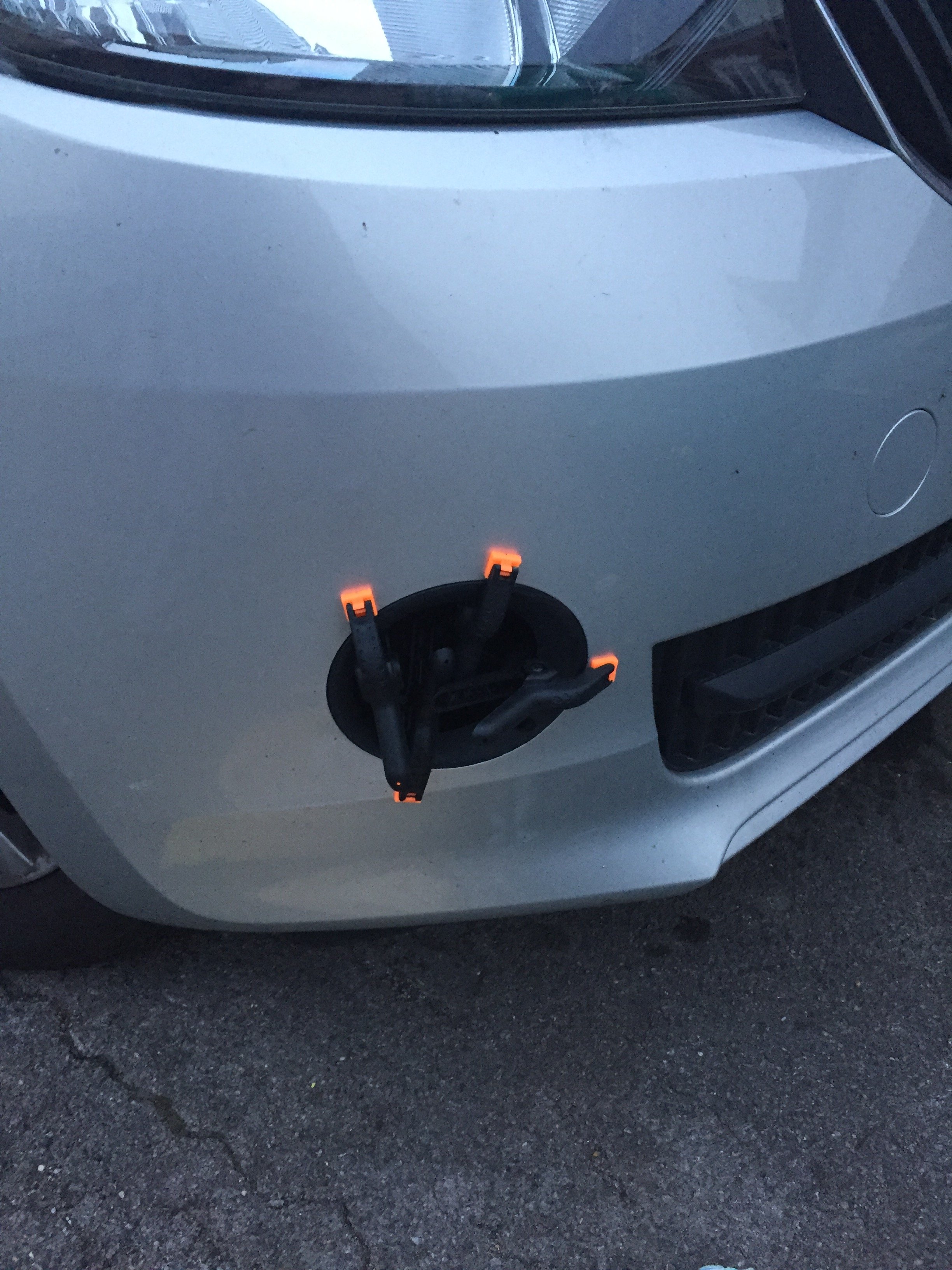

Cleaned the bumper and the light frame put some StiXall (loads) and bought some cheap clamps (just in case someone would want to nick them).
