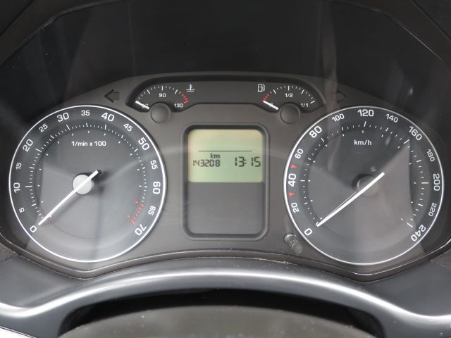

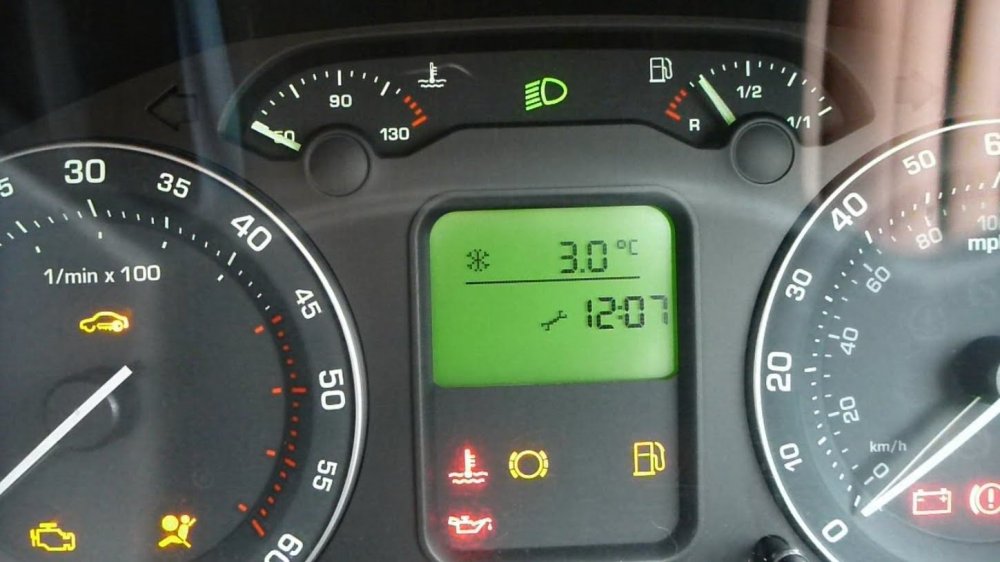

I don't know enough about the pre-fl to say for certain, but I believe these images show a non maxidot cluster, with and without the onboard computer.
Without:
With:
Assuming you have the latter, then it should work as per the manual:

If it's not working, then it's possible the stalk needs talking apart and cleaning. Might be worth finding a local member with VCDS as that might show any errors that could be causing it.
What's currently shown on the LCD between the dials, might be worth a picture? :)
Thank you. Mine is very similar. I have a slightly different layout on the screen but in general, that's what I've got.
All three options above work fine.

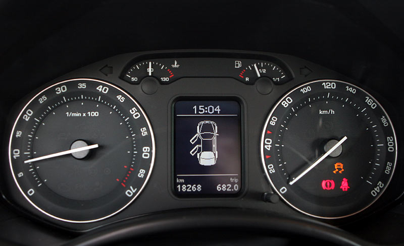

Correct, the main menu is only for cars with maxidot which will be a full screen rather than half.
It would look something like this:
