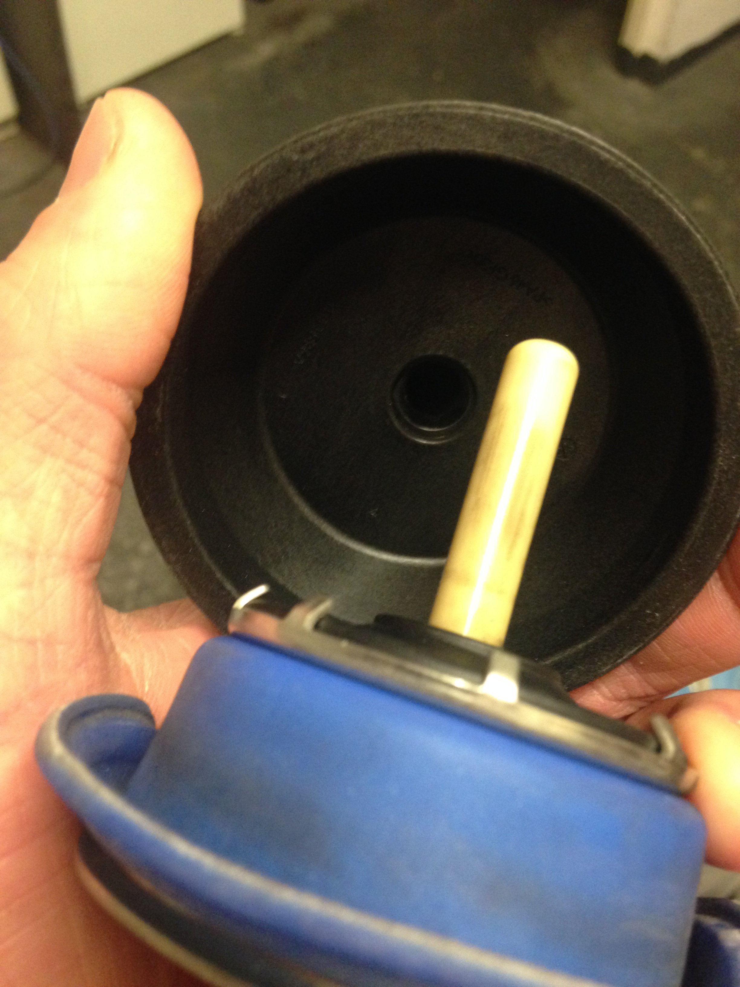

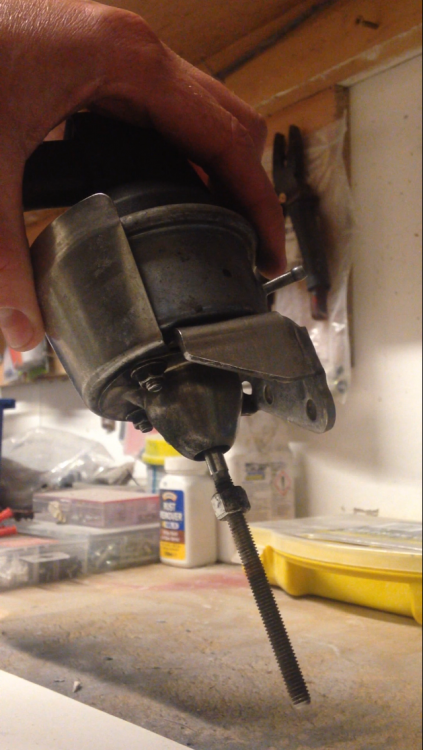

Separated my broken turbo actuator. Amazed that a tiny broken part can lose you hundreds!!
Few weeks back I was getting limp mode and no boost. Eventually worked out it was my turbo actuator.
So I replaced it (£135) new.

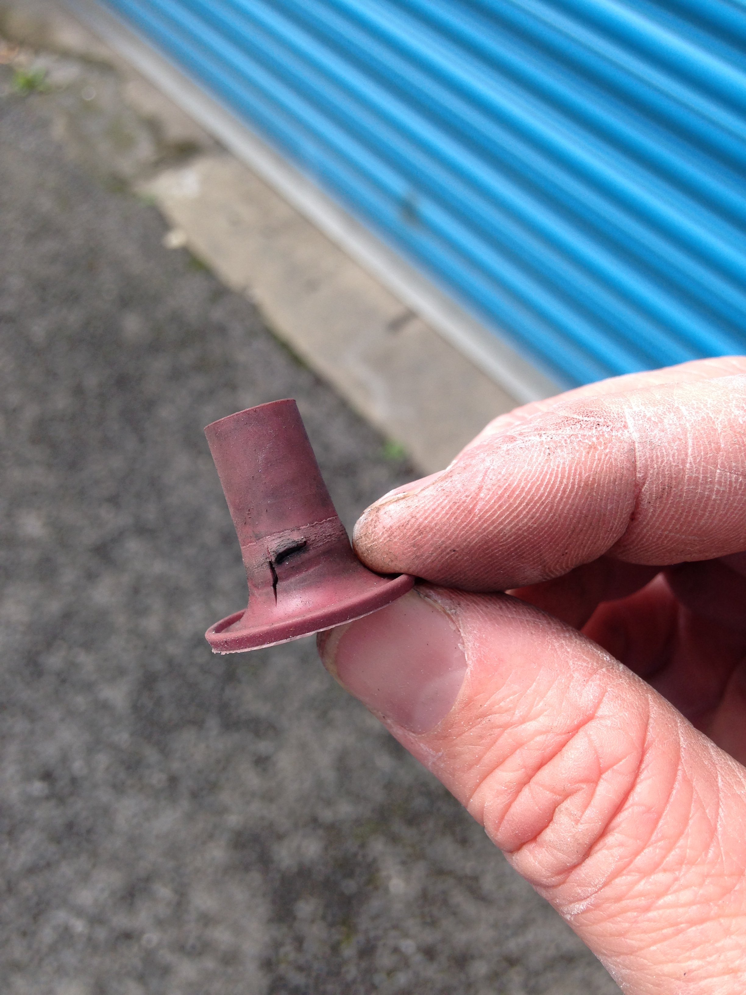

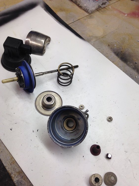

Today I stripped my old one down amazed to find that the culprit to my boost problems was a bit of rubber that possibly costs less than a £1!!
Please see pics.
(actuator is off my vrs cr tdi)

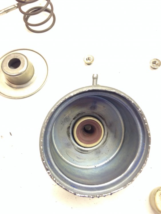

I was expecting the blue rubber diaphragm to be split but it was fine!!
But it was this little one...
3 weeks of limp mode caused by this. VW replace the whole turbo unit and not just the actuator. You'd shelling out over a thousand pound just because of this little culprit.

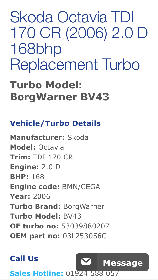

Anyone know how I can get the part number for this???

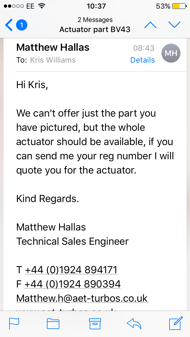

Until someone else chimes in I would suggest you get the turbo specifics and ask the manufacturer or a rebuild specialist, I doubt Skoda will have a part number for the part on its own.

Yes I've bought one and fitted. I was just making a point that vw themselves will not just supply and fit an actuator on its own, they will only replace the whole lot which costs over a grand which is crazy when the problem is just that little rubber piece.
So far my response from turbo specialists is 'no' basically.

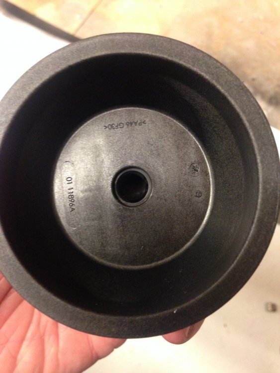

To be fair, it looks like you had to be reasonably brutal to disassemble the thing enough to get to that broken rubber bit, so it wouldn't be what you might call 'serviceable'?

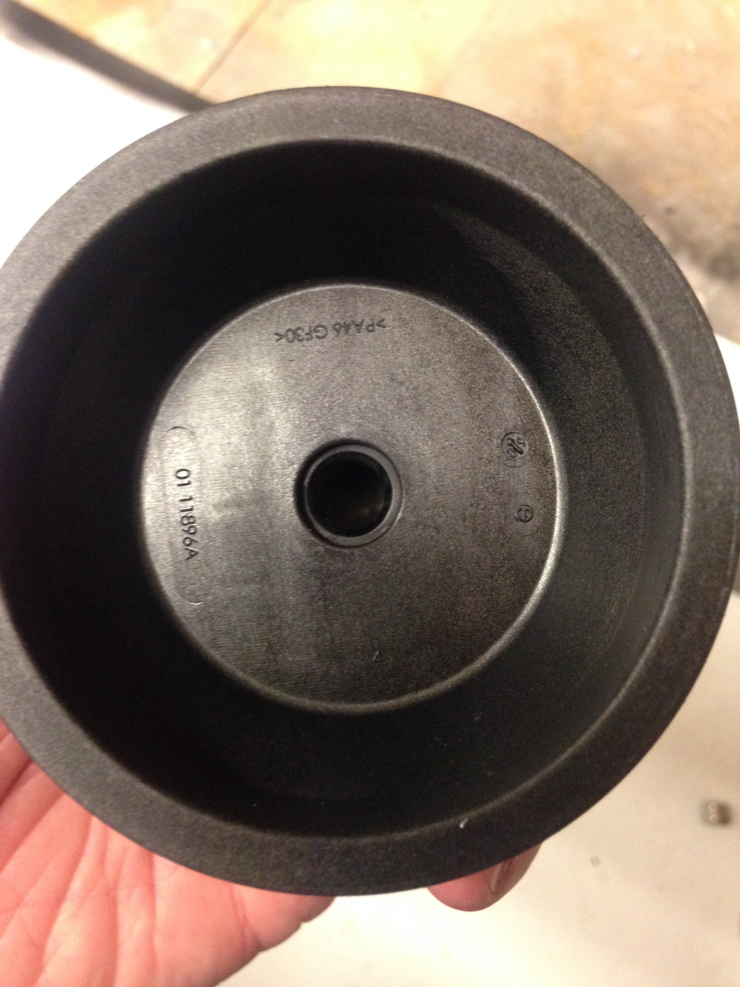

I agree that it is near-criminal to expect to have to buy a whole new turbo just for that though.   What's inside the black plastic bit at the top, in your palm in the first pic?
Potentiometer for position feedback?

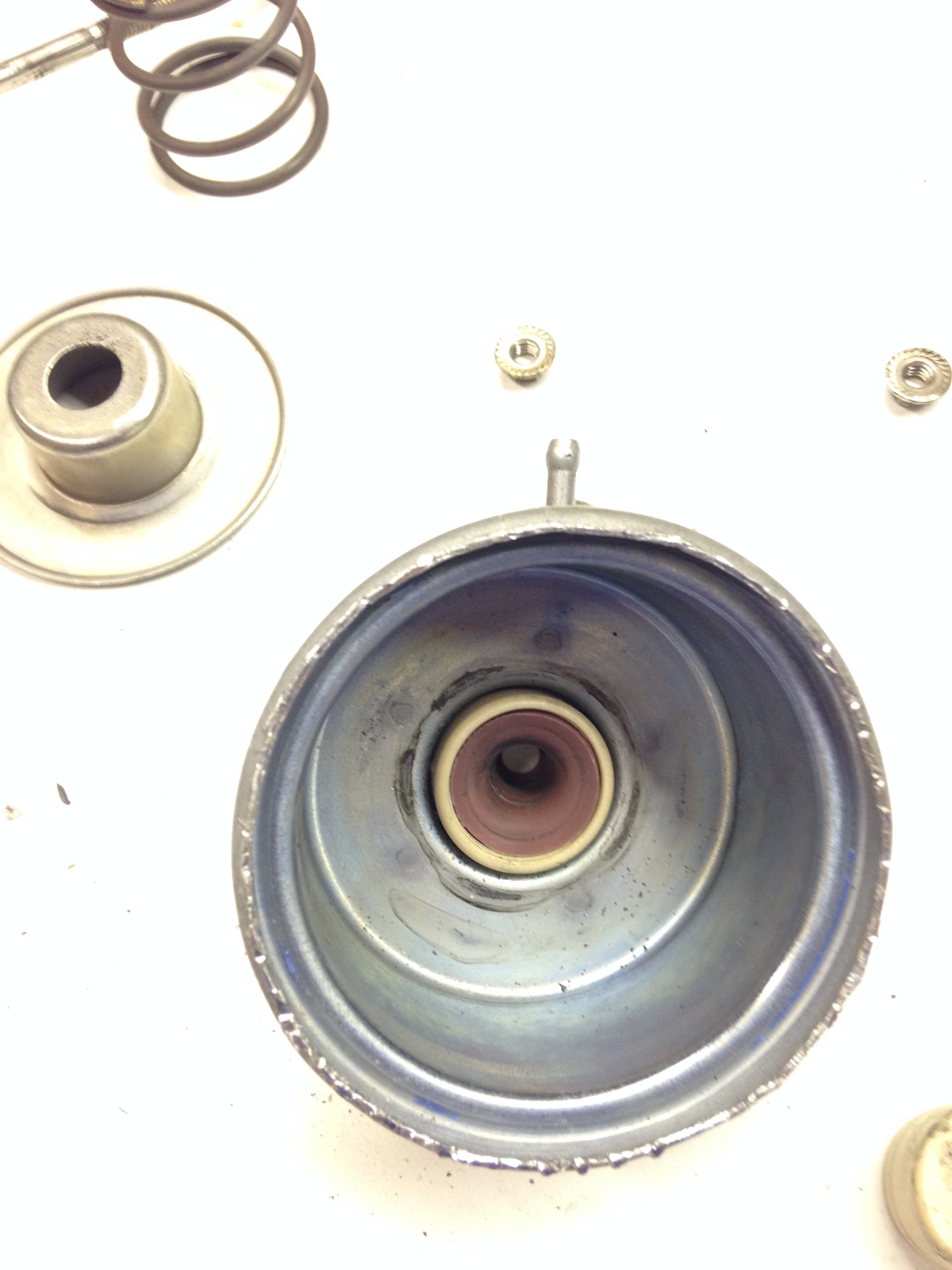

It was a pain opening up but as there are companies selling reconditioned ones I thought the parts inside must be replaceable.
The black plastic at the top has nothing in it at all, actually looks fake but obviously not.
Ill post pic a bit later for you.

Inside plastic plug/sensor...

Well, they should when ETKA give them PN 03L198716A for the actuator (ETKA state 131€ without german VAT), which is not openable=serviceable part. When VAG service replaces whole turbo in such case, that is a robbery in daylight or incompetence, not sure what is worse ...
