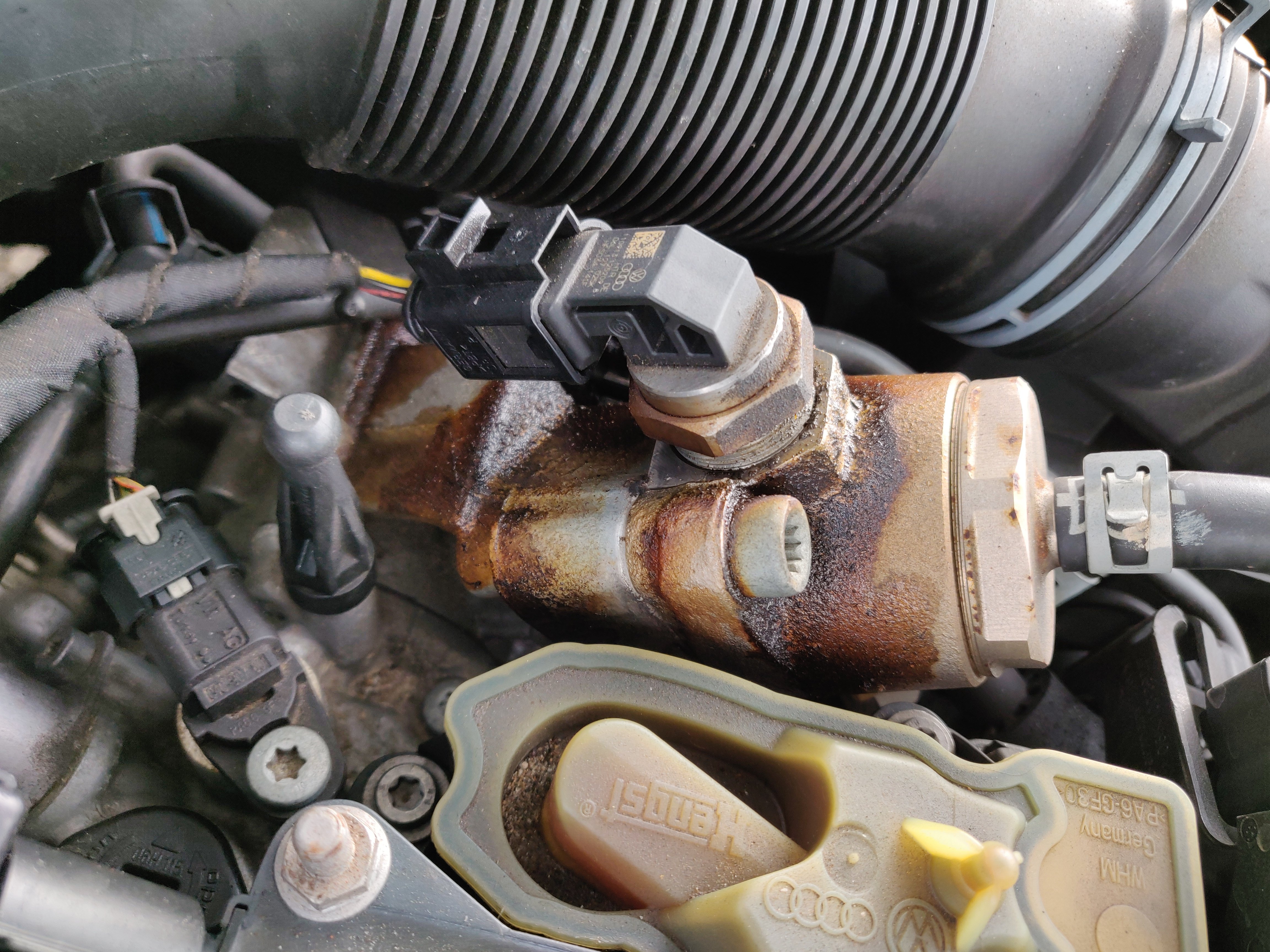

The outcome is there is a leak that looks identical to yours and apparently the only option is pump replacement. Our air engineers would always go for an O-seal replacement on a component like this. Maybe the ones VAG use are just not designed that way; In-built obsolescence!? The dealer have quoted £385 Inc VAT for the pump and fitting (and to include the diagnostic time fee). I'll take a photo to add here, hopefully may help others trying to diagnose the elusive petrol smell.

The dark staining on the pump is from petrol leaking and being cooked off by heat from the engine!!! The pump's hidden under the plastic engine cover so you won't see it unless you go looking for it. If you've got an early MK3 vRS petrol I'd recommend having a look. The cover just pulls off, no tools required.
