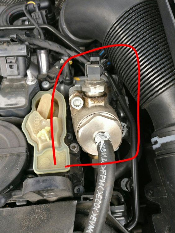

Was cleaning the car over the weekend and noticed a whiff of petrol near the front of the car.
Took the engine cover off and noticed that there seems to be a slight seepage (based on the darker staining) of something from the area highlighted in the attached image. The smell of petrol seems strongest here.
What is that part of the engine? Is it normal for there to be a slight seepage and a faint petrol smell?

That's the high pressure fuel pump mate. And is not right

Thanks for your response. Was researching online since posting and thought it is the fuel pump. Looks like a couple of people with similar age GTIs had the same issue on the mk7 forum. Anyone else had the issue with their VRS TSI?
Under warranty still so dealer will be getting a call first thing in the morning.
I have been driving it for the past couple of days, but does this present a safety risk if it's leaking (a small amount of) petrol?!

Judging by the accumulated dirt I think you have had the weep for a while (months), so you should be ok for another 500 miles.
I'm assuming the nut is not loose and it is just a permeable seal causing the problem
Keep your fire extinguisher handy though
Yeah the nut is not loose; it won't tighten any further without a serious amount of effort applied. The weep as you say could have been there for some time; I've never taken the plastic engine cover off in nearly a year, and it was 3 years old prior to my ownership.
Inspecting one of the flex hoses attached to the pump close up, it looks like there might be a slight nick in it where the clamp is tightened on it. This may be where the petrol smell is coming from, and the brown residue on the pump might be a false alarm. The residue on the pump hasn't come back after a fast drive home of 23 miles. Today the smell is only noticeable close up to the pump and related pipes, rather than from outside the engine bay when I noticed it the other day.

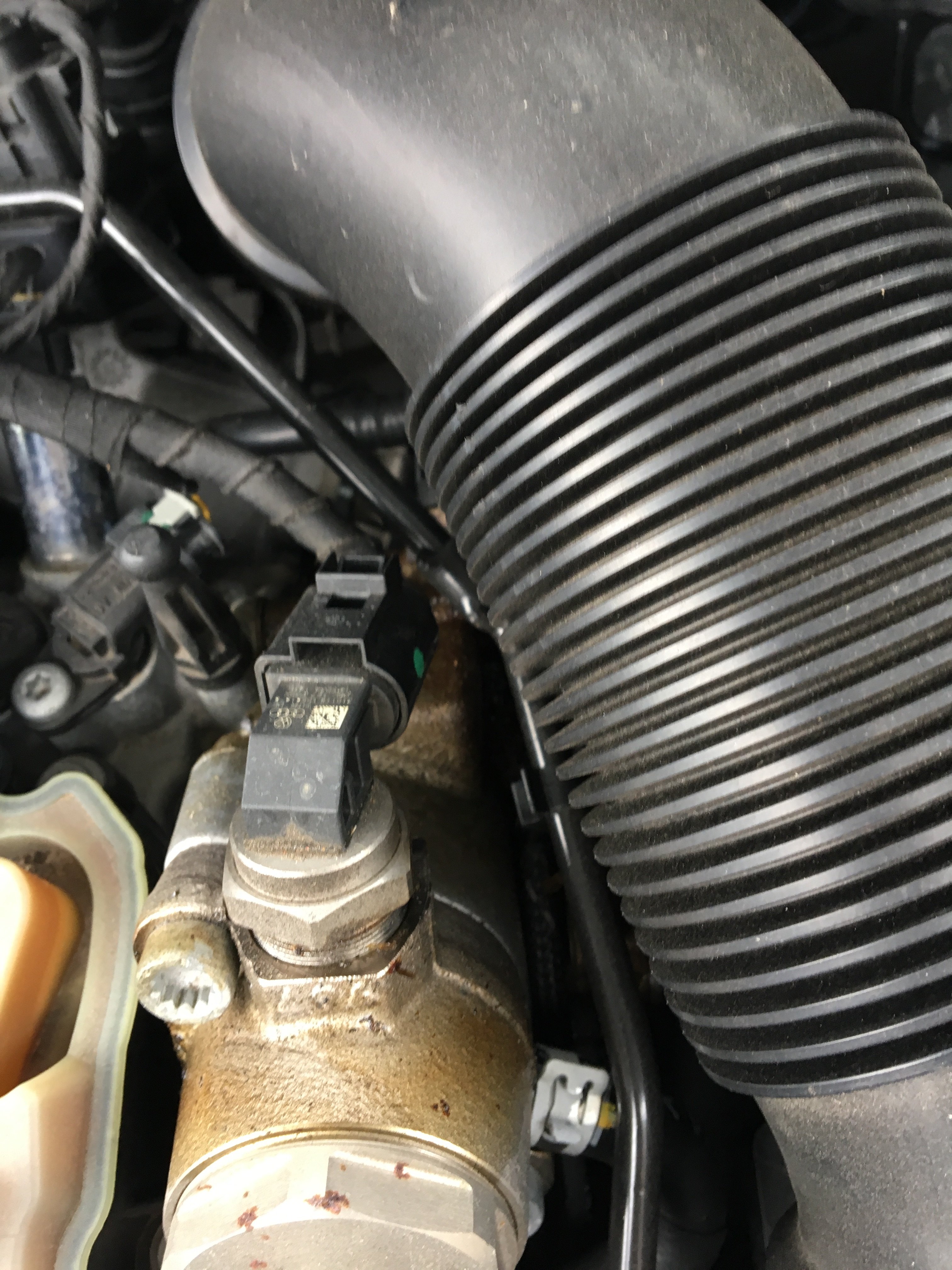

I’ve had same. Now in garage. thanks to this thread I found out the problem
  • 11 months later...
Got the same problem on my car, but the dealers are quoting £680 to replace the pump (car is 5yrs old) There must be a seal or something under that thread to replace? Has anyone taken the sensor out at all? Workshop manual doesn't mention a seal...
