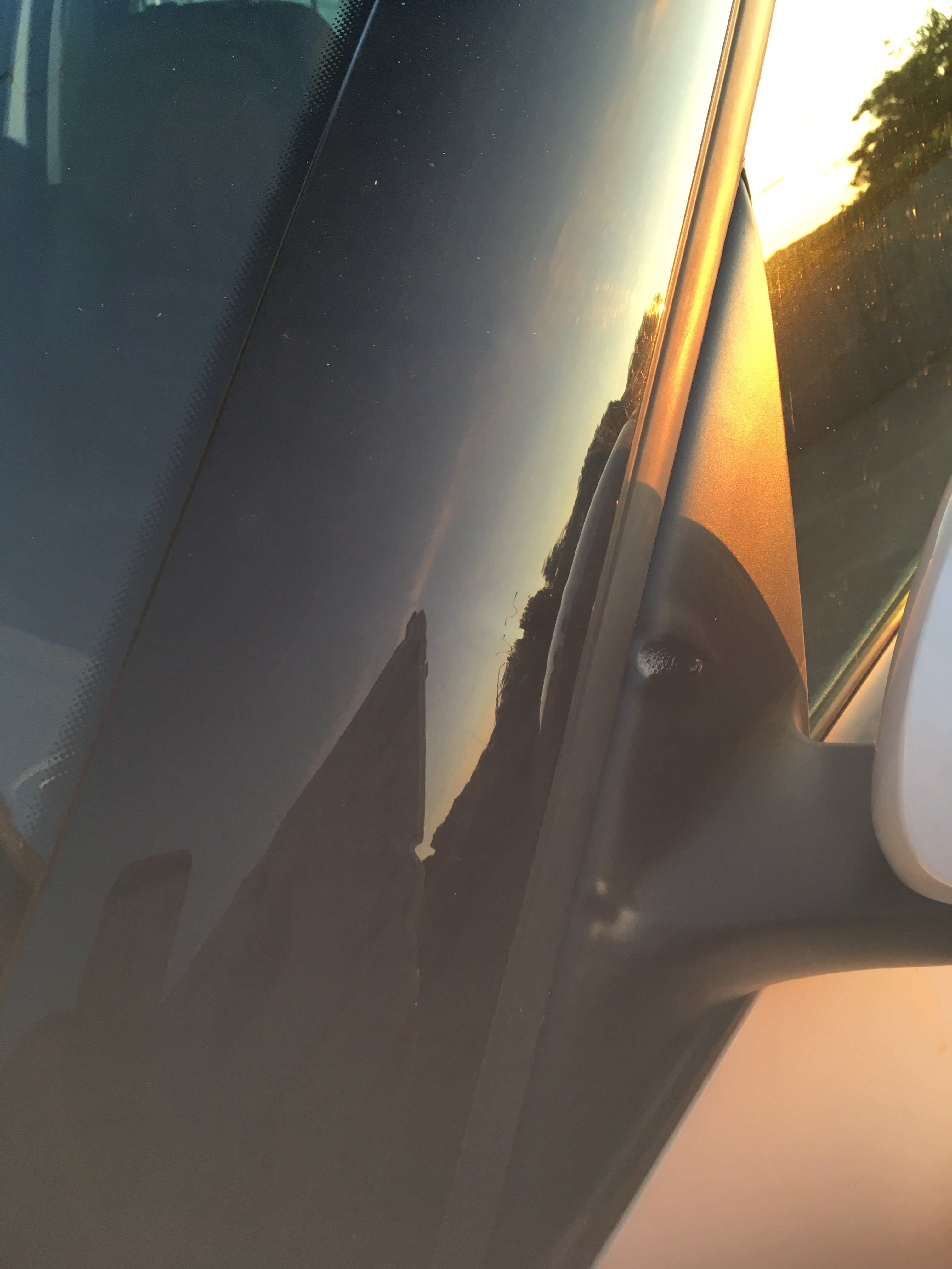

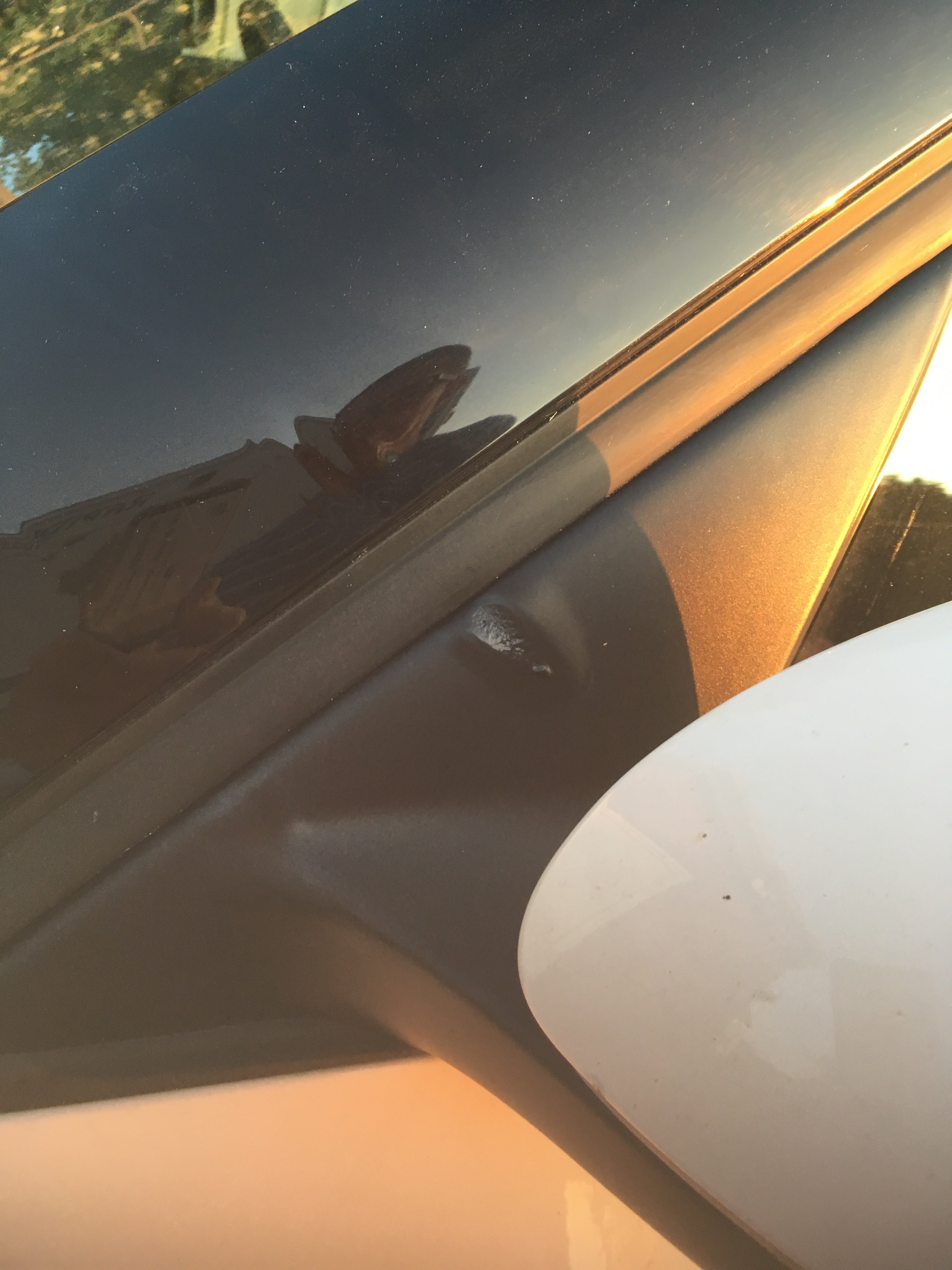

Well after my last post, I'm sorry to advise that it's happened again. Yeti parked as normal, and continuing to apparently melt before my very eyes. Actually not quite true as I haven't seen it melting. Last time it was the o/s rear door trim. This time the n/s front screen plllar and door mirror. Any more ideas please? Thanks, John.

I think if it was done with a lighter the damage would be more vertical but the 3 marks are in the same direction and on an angle. I have doubts if it is caused by some 'feral bacterial no mark' even with a magnifying glass.
Its deffo not the sun reflecting from the door mirror. if it is the sun it must be at an intense focal point from somewhere else.

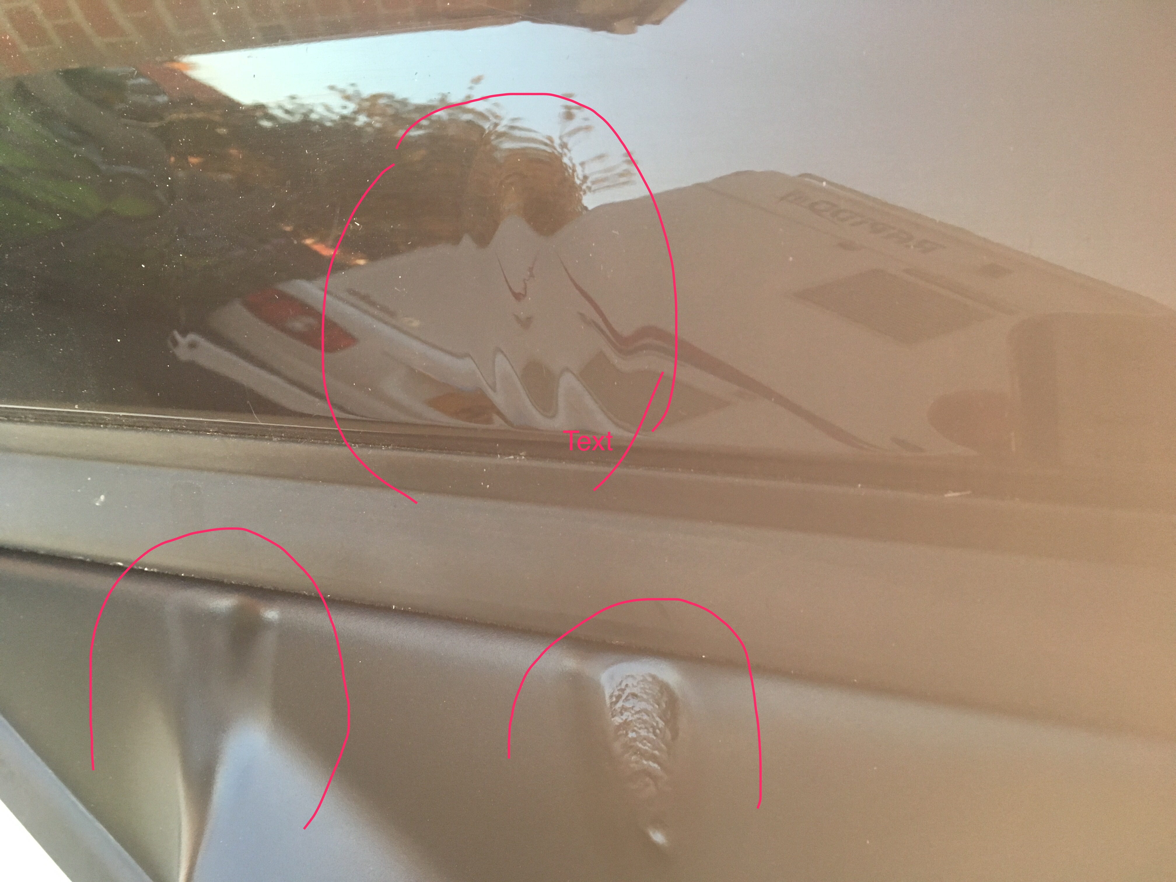

Hi guys, thanks for your input. Yeti was parked the other way round, alongside the motorhome. The damage is to the side furthest from the motorhome (as last time). Therefore you could say the damage occurs in the same area. It really does looked burned by a heat source, but the rubber parts are completely untouched. Could a laser do this? Whilst I had not considered vandalism, maybe need to reappraise my thoughts.....

those marks start from a sharp edge but the one on the pillar trim is across a curved surface is less severe. This makes me think it is the sun reflection from something and moving across. The theory that it is easier to ignite paper from the edge than it is in the middle.

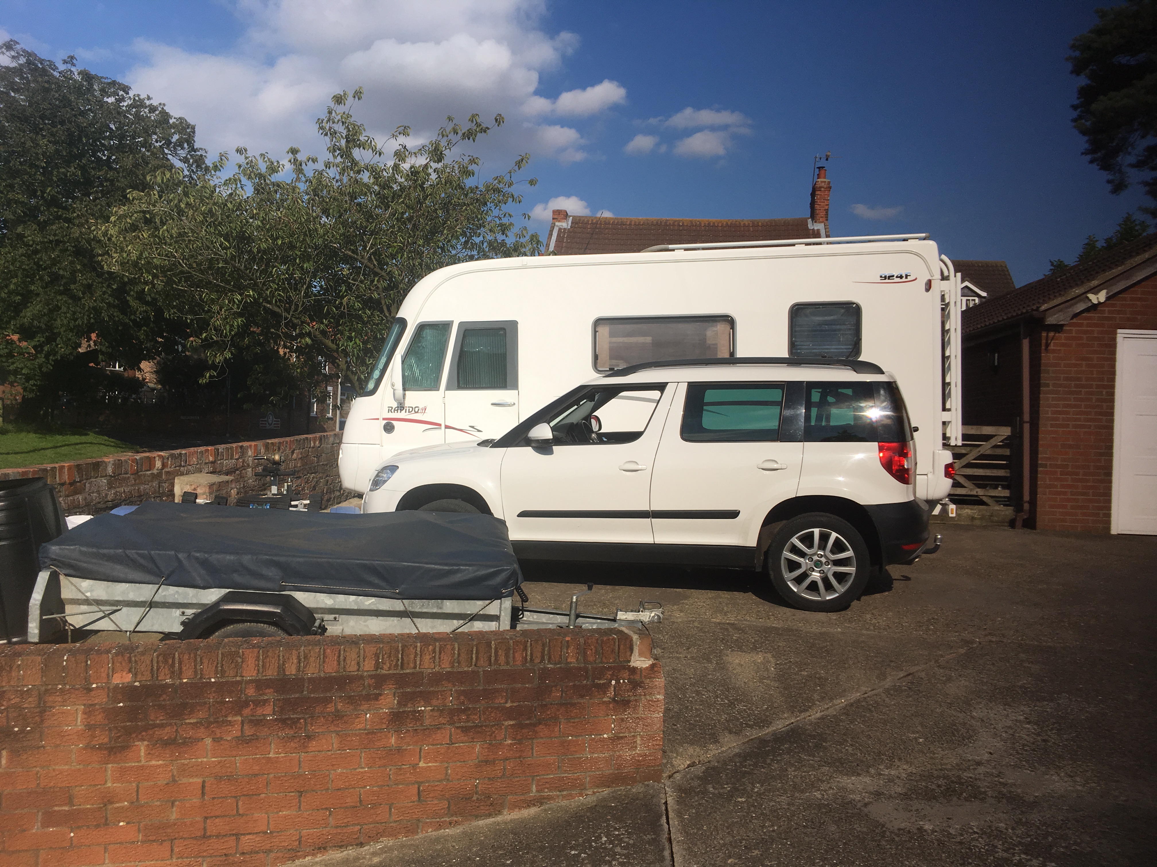

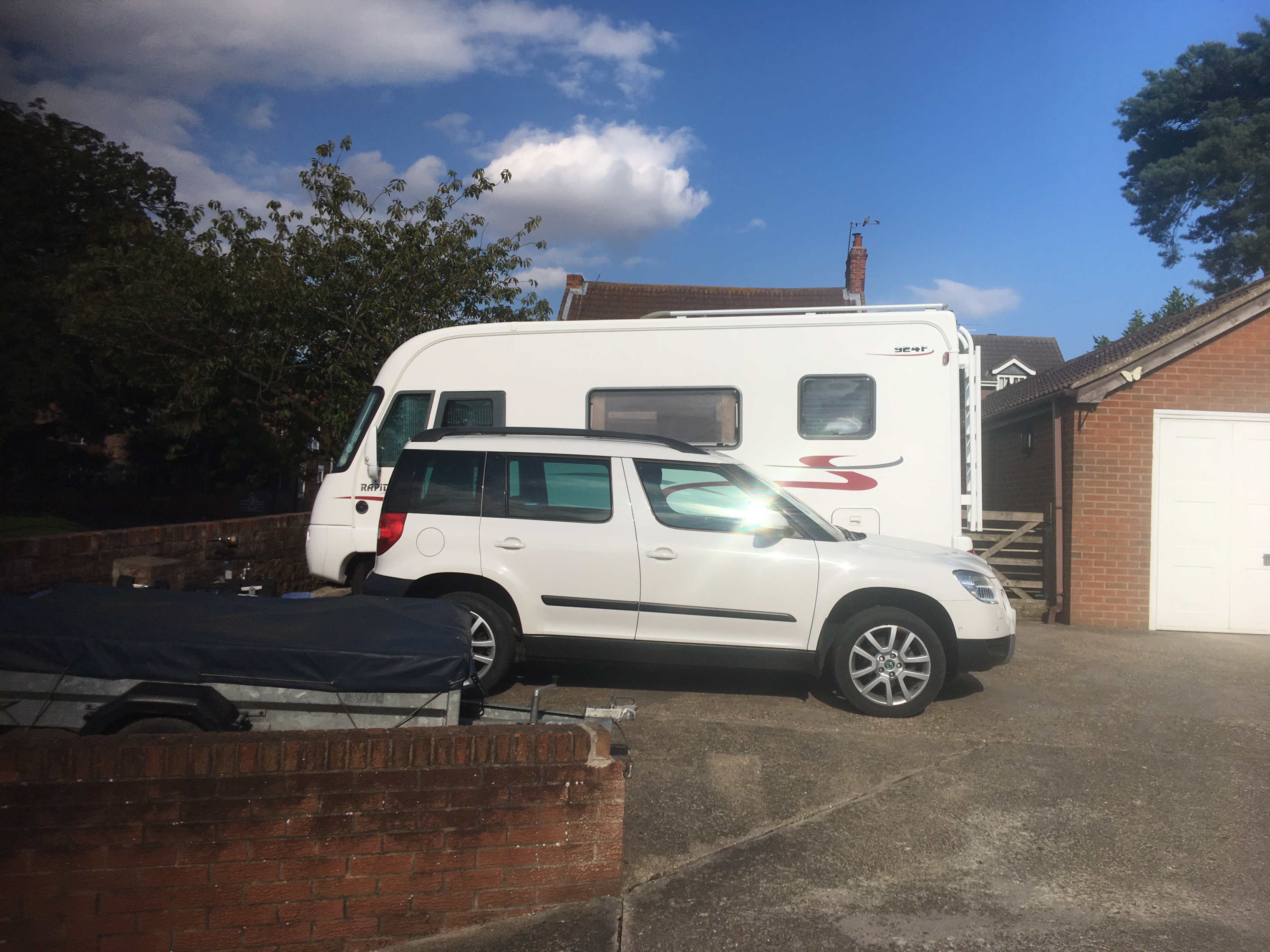

Yeti is usually parked as per these two pics. More often than not, with the tailgate facing the wall. Any further ideas. I don't believe it is vandalism.

Are you  certain that the damage was caused on the opposite side to the motorhome? If so I reckon you would need to look for something reflective around the area at the rear of the trailor.
If the damage was caused to the side of the car nearest to the motorhome I can see that an Ideal candidate for this would be the rearward squarish window on the motorhome - is it slightly concaved?
Jim

The marks on your car look like they're about 8mm diameter?

Jim, you are correct- they are about 8mm wide. Thanks for the utube video link by the way.

If you have time, it might be worth on a sunny day holding a large piece of paper up near to your car and moving it around to see if there is any form of image of the sun being reflected - I would strongly suspect the motorhome as your most likely candidate - especially that squarish window....
Jim.
