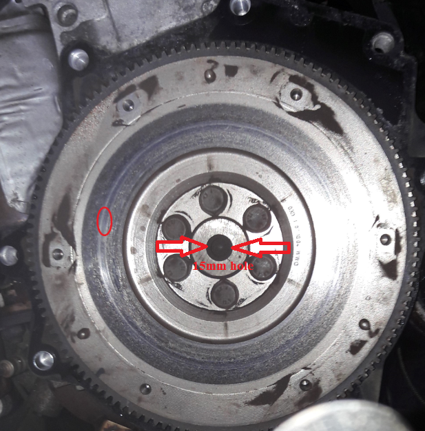

Thing is mate, on these the input shaft doesn't 'enter the flywheel'.
I did the clutch on the missus's 1.2 at Christmas (I know, generous present, right?!) and had to make an alignment tool whose key diameters were a shade under 15mm and a shade over 20mm. The crank has a 15mm dia hole in it that such a tool can go into, but there's no bearing there. The spline drive on the input shaft is 20mm dia, and there's no projection on it that could fit into the 15mm hole in the crank.  Ebay pic of input shaft end and (poor) pic by me of flywheel on the car:

This is interesting stuff, thanks for the info.  So instead of front support for the shaft, it depends on the accuracy of the clutch plate to ensure a 90 degree fix to maintain centralization of the first motion shaft.
Would favour an extended shaft into the rear of crank to establish fixed accuracy. Guess I'm just old fashioned.
Still the prospect however of partial seizure along the splines is a possibility.
