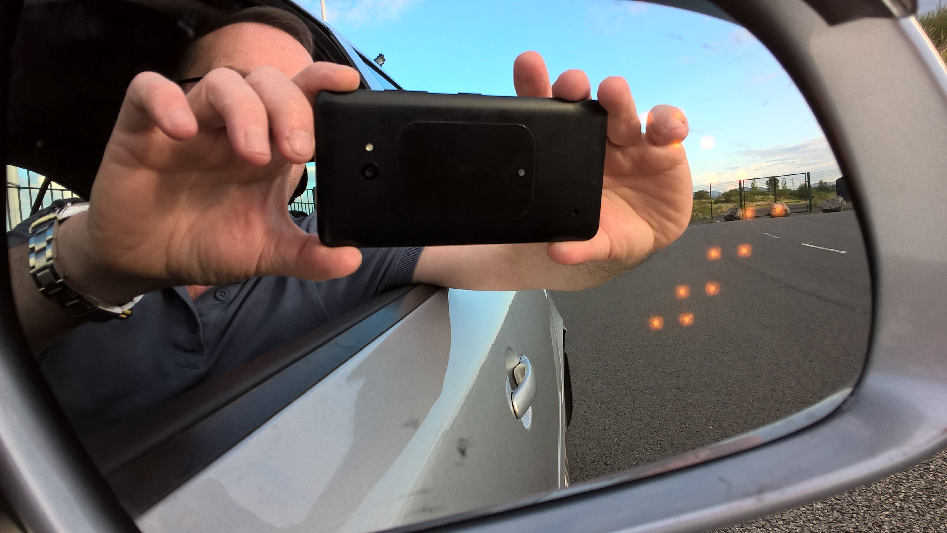

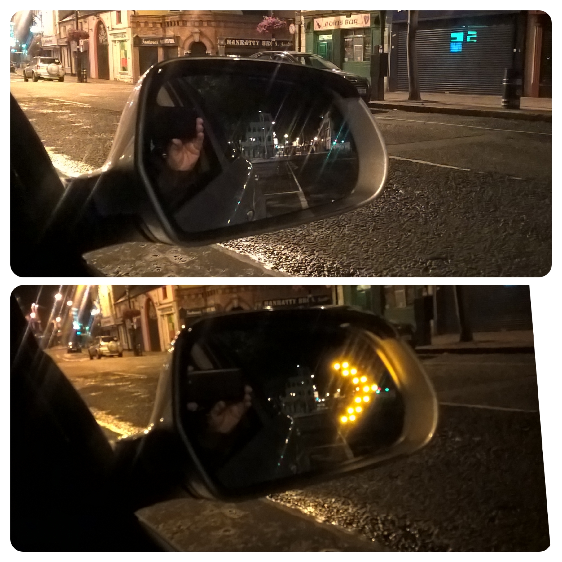

So been driving around 2 days and 2 nights with my new wing mirror indicators and I can say>> during day light there is absolutely no way that the indicators effect or lessen my view of the road, in fact the soft orange spots are barely visible from my driving seat position..... Night driving>>> the soft orange spots of the indicators are clearly visible but again do not interfere or impede my view or judgement of the road or surrounding immediate area!? That said... I can see where an over zealous or strict tester or Garda would be of the view that these 'added' addition to any car may not be legal and therefore should be removed!? If that's the case and as a professional driver I would without hesitation remove said indicators and wait for clarification....
This is a daylight pic.. I tried to take the photo straight on and close to the light, my seated view means I see even less brightness and colour, actually barely able to see them flashing at all, all I really see is a clear mirror!?
