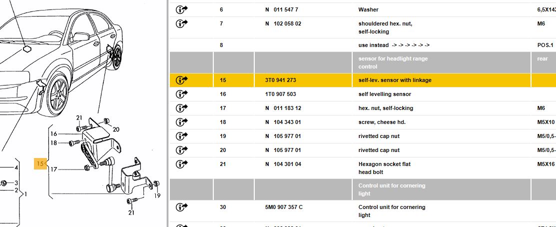

Just had the MOT on my Superb, past without problem although the guy did mention that the headlight alignment was a little out, later when up on the ramap noticed that the droplink on the rear ride height sensor has snapped, I think  this is only used to control the self leveling lights. Does anybody know where I can find the part number for the broken part or possibly the who.e sensor if it only comes as one part.
can you pm me the chassis number, I can check to see if it is separate
Pm replied to, here is the image though from the catalogue - only available as a complete unit, may be worth trying to track down a breaker
Thanks for the help guys, the part which has gone is the drop link type part in the a over diagram, it's just a couple of plastic ends with a metal tube clamped between them, one of the plastic ends has broken where clamped. Unfortunately i can only get thd whole unit (how crazy is that), I could probably fix it but would cost me more in time.
