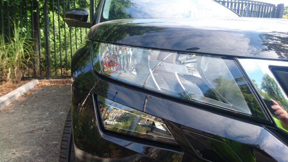

This is where Eurolites say the deflectors should be placed. Good luck.
