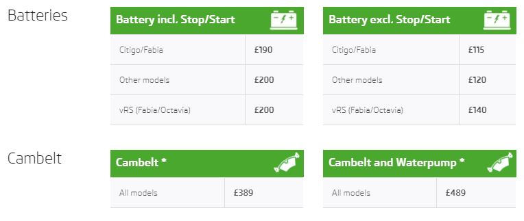

Skoda do quote pricing for the cambelt and cambelt plus waterpump here (click on the maintenance tab halfway down the page)...
http://www.skoda.co.uk/owners/service-and-maintenance/simply-fixed

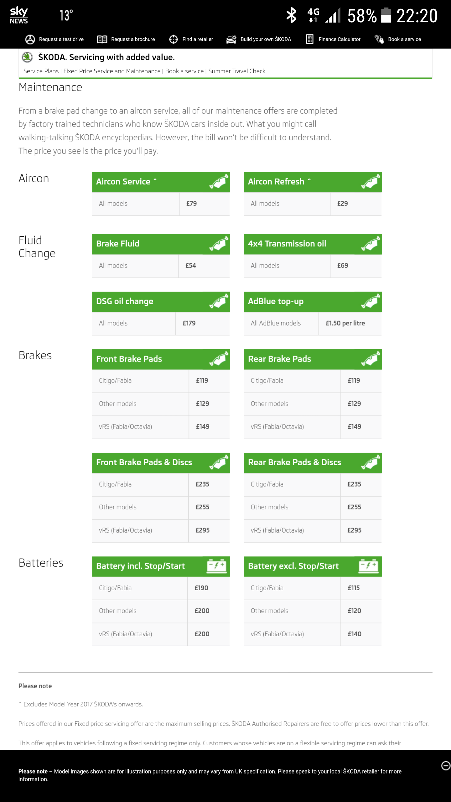

Unless I'm doing something drastically wrong, I cannot see the Cambelt/Waterpump price ;
