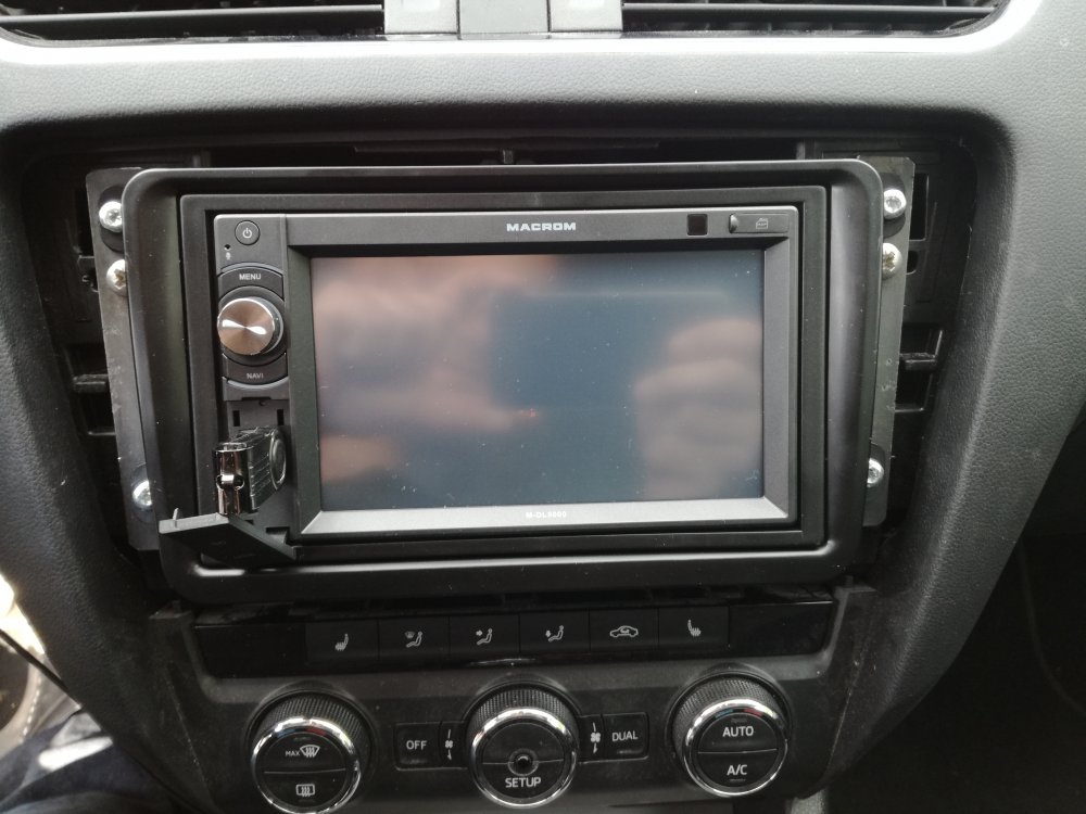

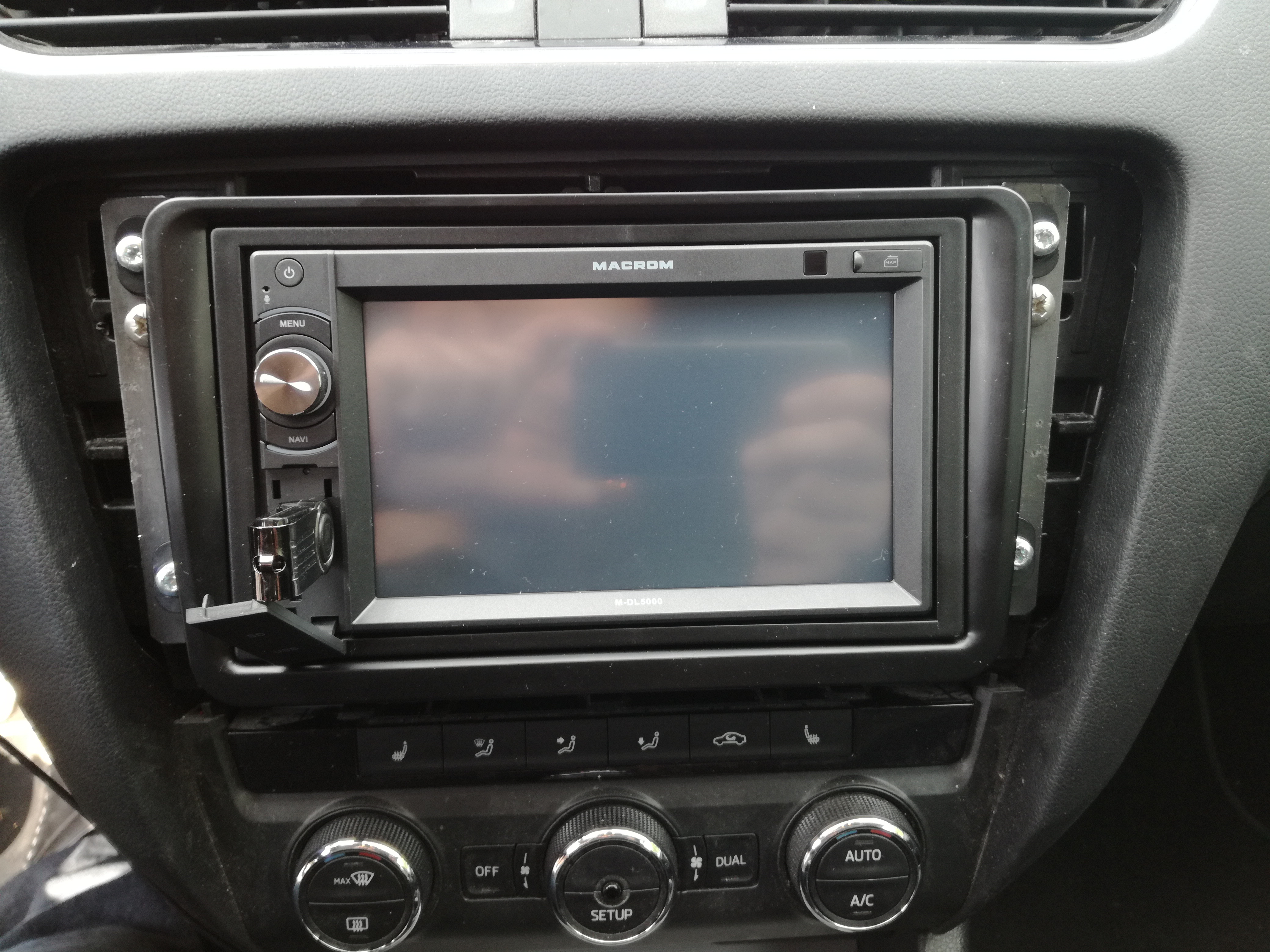

Well it looks good and fits, but I had to make my own mount with two pieces of 5mm think metal, so I would be able to bolt the basic frame to the car.
Also because I did not wan´t to cut or drill in the dash.
With the frame mounted I could install a standard double DIN radio, I bought wiring loom that goes from quadlock to iso and an antenna adapter thats goes from the two plugs in the car to a standard antenna plug.
The wiring loom I got at the store where I bought the radio, cost about 15 euro, and the antenna adaptor from CARAV, though ebay, where I also bougth the frame for the radio.
The radio I installed is a Macrom M-DL5000 with navigation included.
It was a very tight fit because of the depth of the radio, so if you do this, be sure to measure before you buy :)
There is about 150mm of depth, but remember room for the wires out the back of the radio.

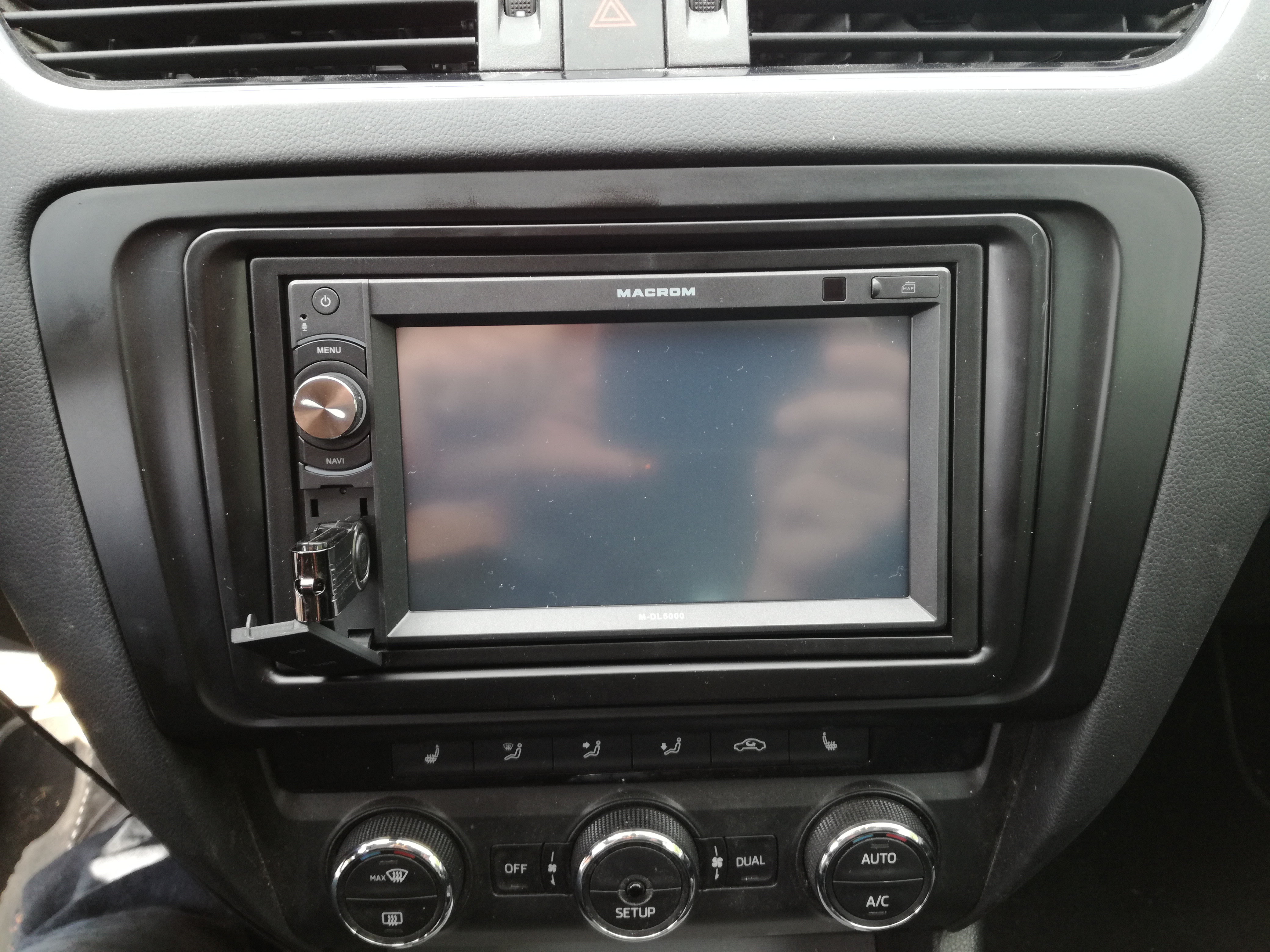

I only (so far) have the original speakers in front, but what an improvement!
Much better sound.
I have attached pictures of the installation.
Thought someone else could use this.
