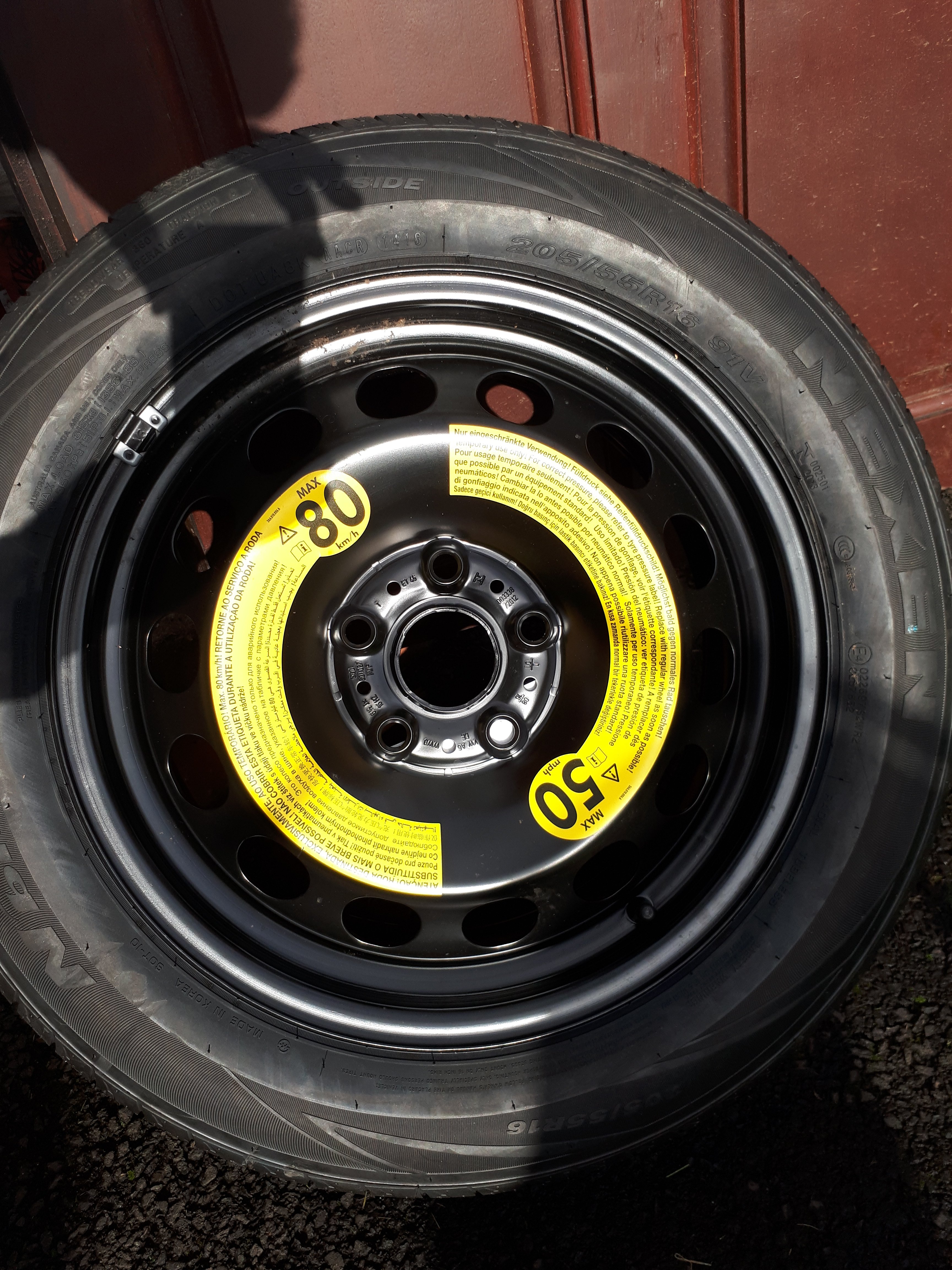

Thank you all for your advice, I've ordered the Spare Wheel + Tyre (7.5J x 16”) – £141.40 inc.vat from local dealership, looked on e bay but most seemed worn or slightly damaged  so opted for safe choice from dealer, costlier but at least I have peace of mind now. (hopefully)
Just checking before I try fitment over weekend, is this tyre suitable??

Yep...
91 load index might be too low.
Is it 92 recommended?
15kg difference
The dealer supplied tyre is a 94 rating (670 kg) which would be a 55kg difference from the 91.
Prior to the facelift, the lowest load index homologated for the 2.0 TDI was 92 for 18" rims only. Following the facelift, 91 was homologated for 16" and 17" rims.
Would it be suitable as a spare??
Brand new tyre and rim, haven't bought yet
just checked my car tyres, they are 92
That's a question you would need to ask your insurer I think. If it failed on the vehicle and caused an accident, they might take issue with the fact that it is below the manufacturer's specification. In reality, it's probably fine but it's easy for me to say when it's not my car :)

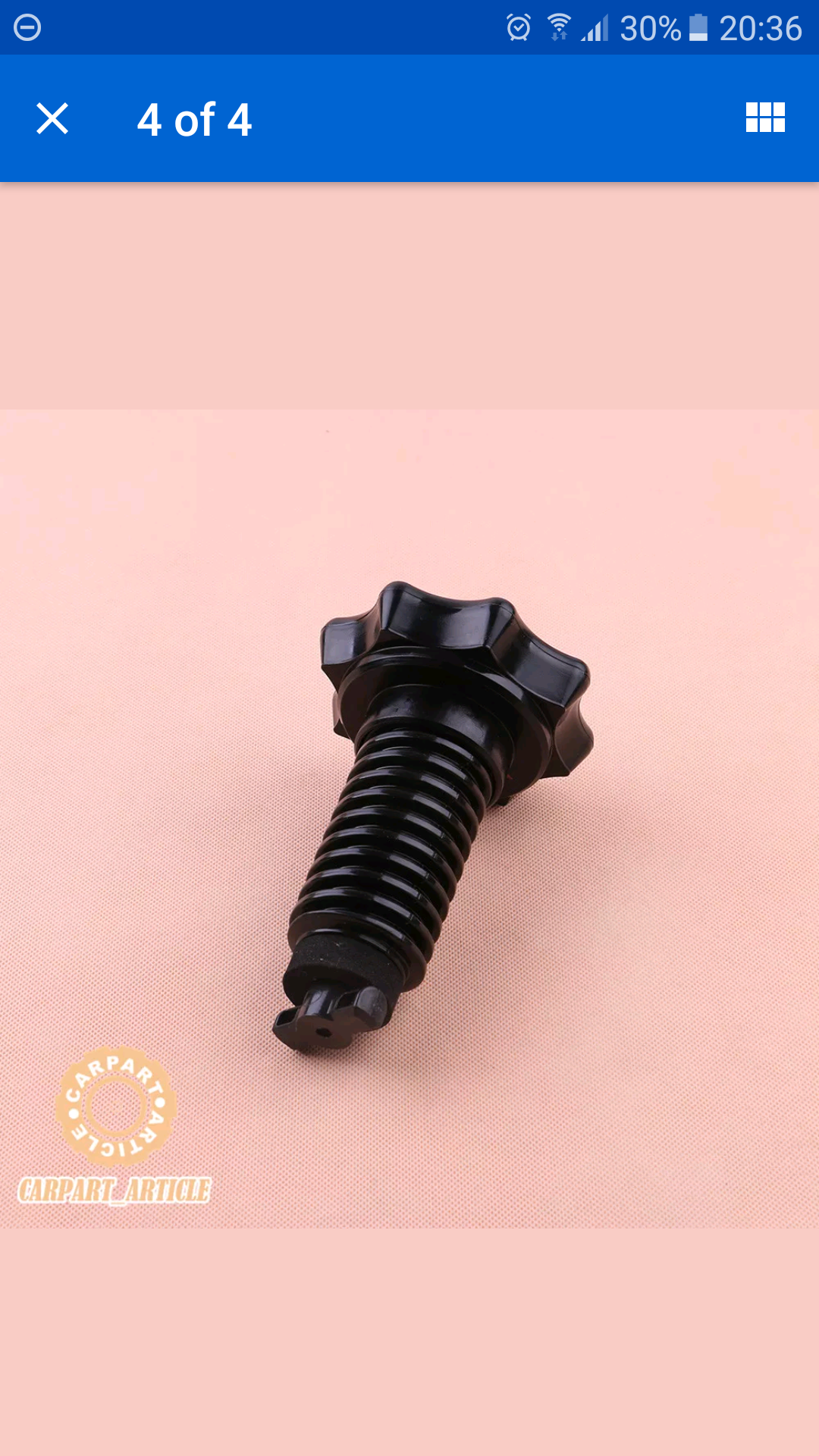

Is this the correct screw??
Looks about right.
