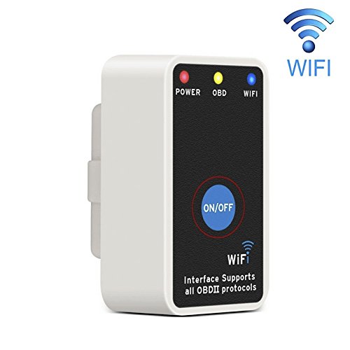

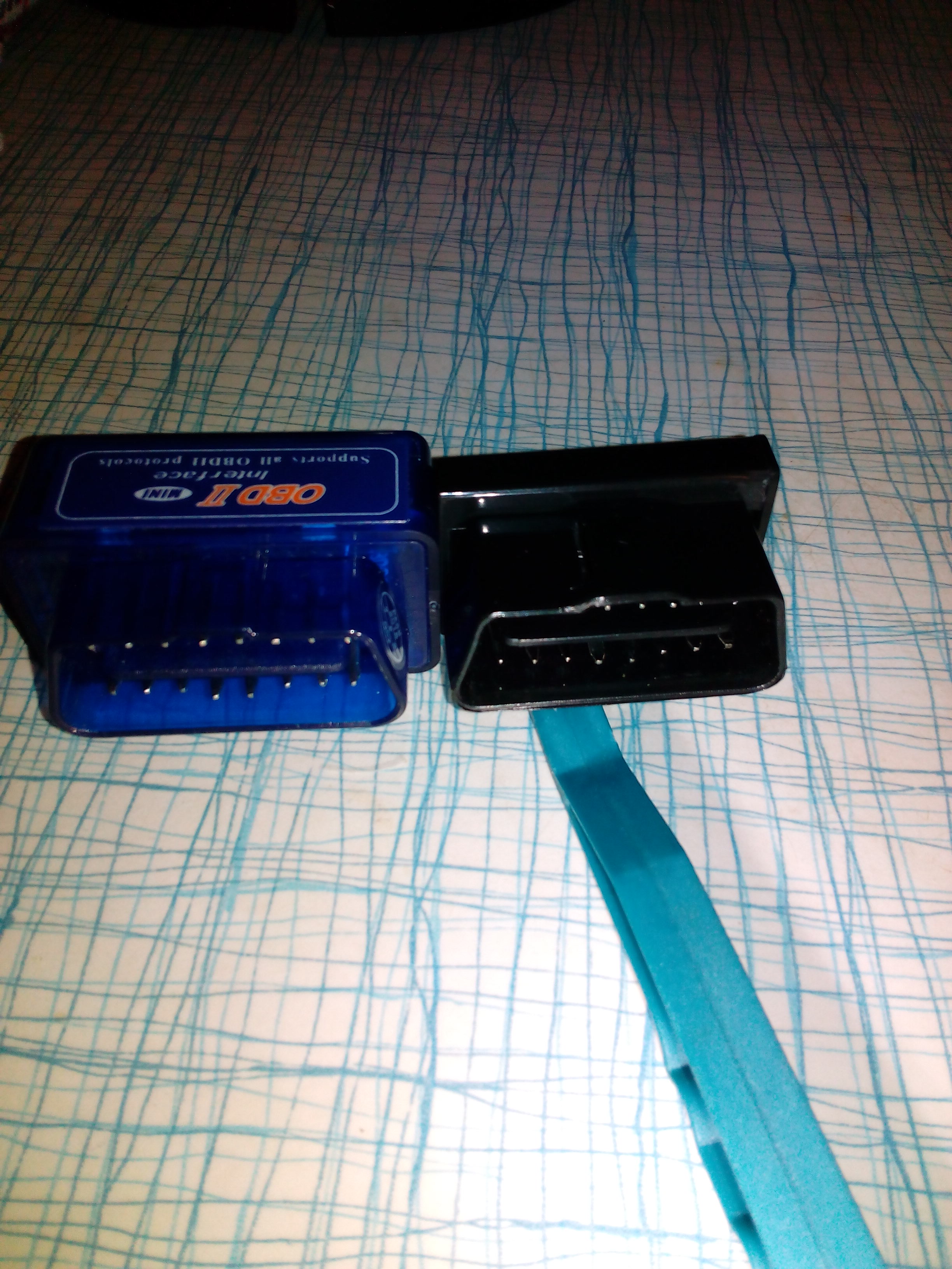

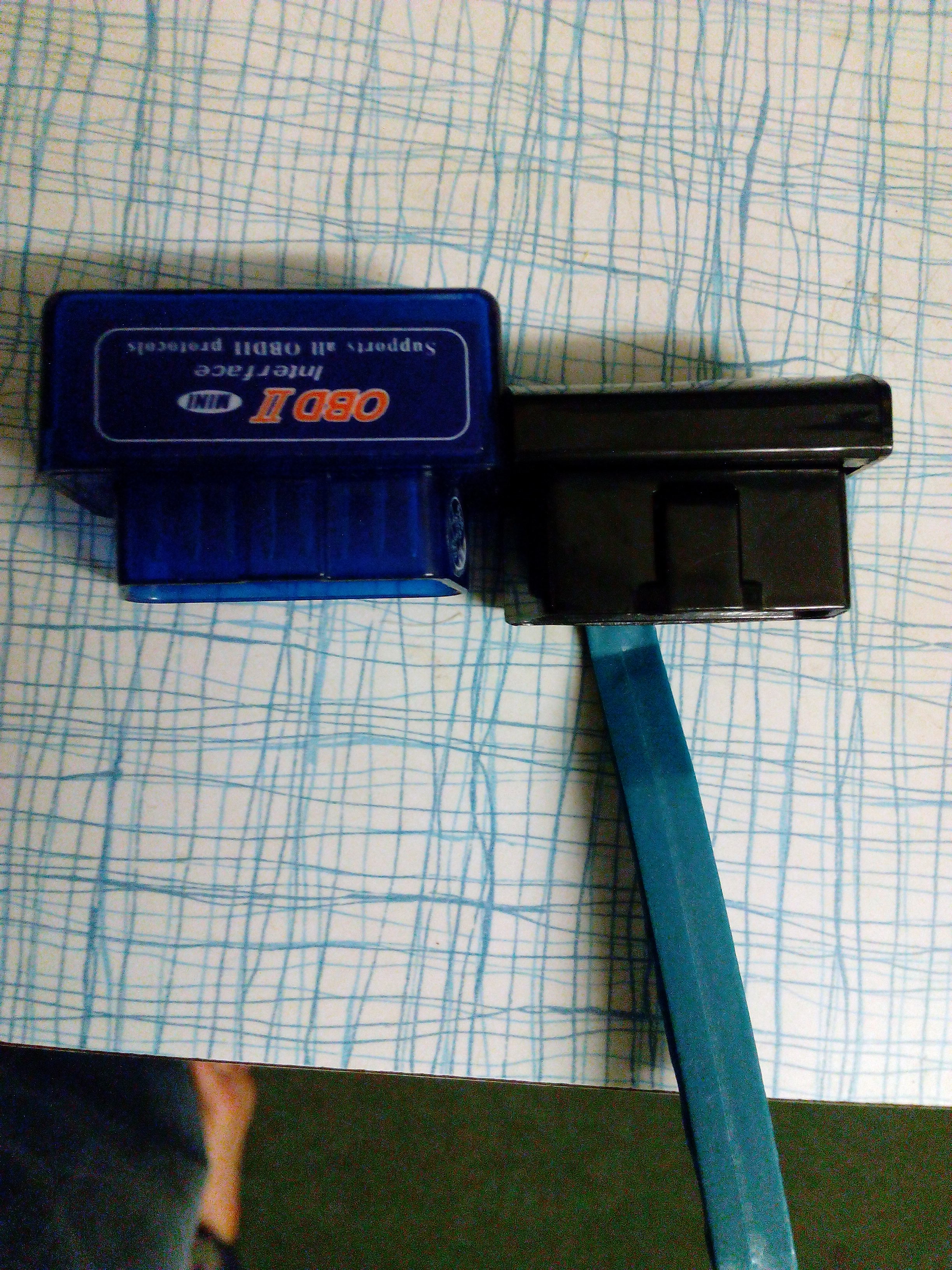

I used one of these as my ELM adaptor wouldn't fit properly.  Not sure its the problem your having but made it much easier to get mine working.  Maybe it was just the type of ELM adaptor I got that was the issue but I found it fouled on the opening to the socket and was difficult to get it to connect properly.  I got this one which, with the cable, works perfectly with Carista.
Thanks just ordered the cable to try with my adapter, I'll also try a Bluetooth one I have with another phone to see if it's my  wifi adapter as the Bluetooth one doesn't fit in at the minute.

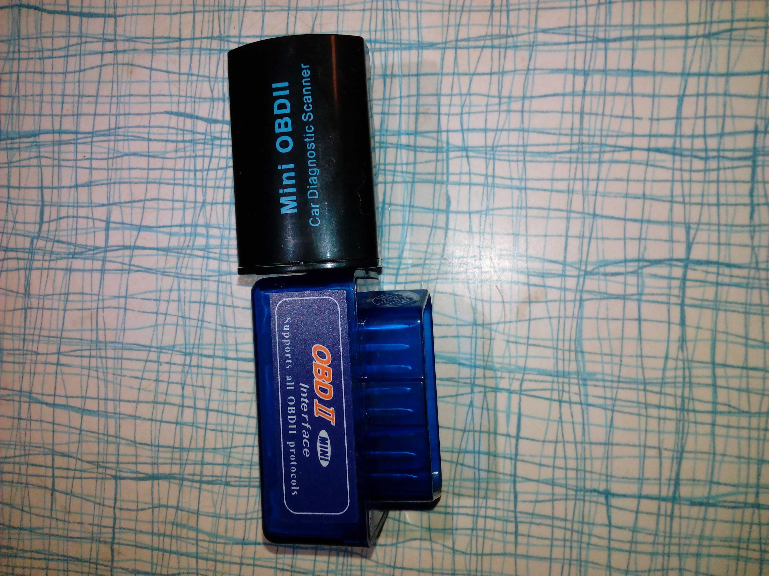

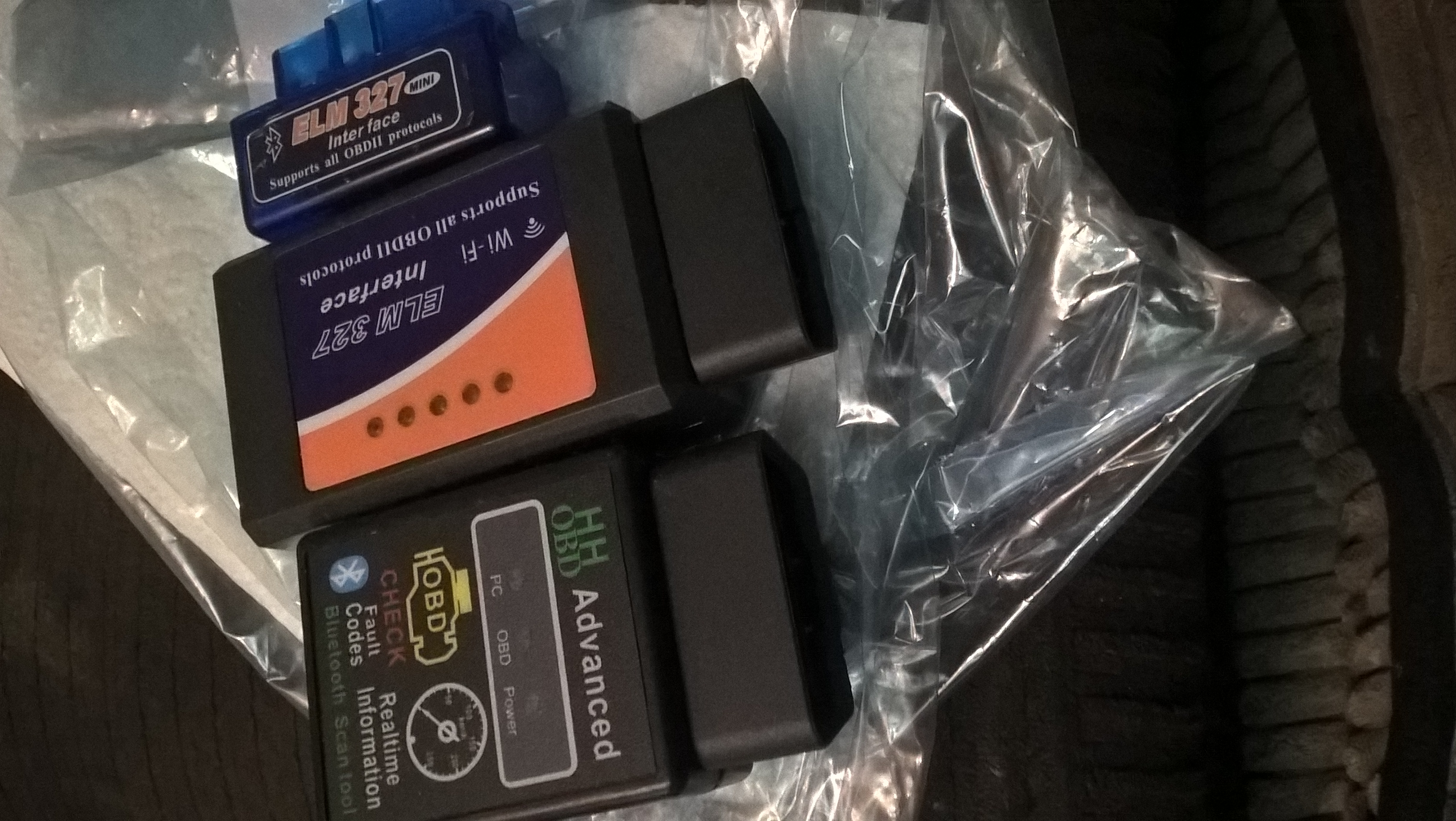

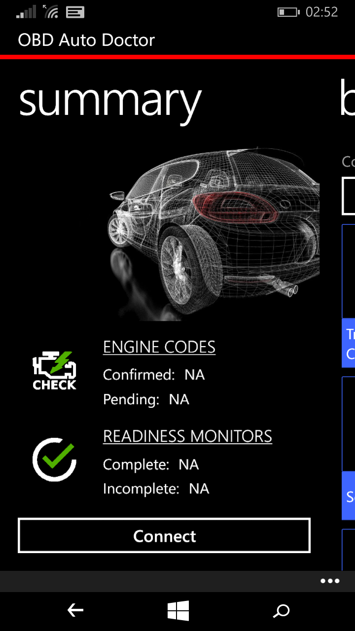

I have tried a few of these WiFi OBD's and this is the one that works for me.. Here is what I have tried and the last pic's are the one that WORKS with pic of my Phone screen app and start screen in app, Also I have that adapter/lead above and all tucked into my mini glove compartment below dash drivers side..
Thanks I'll wait for the cable to come and give it a try if not ill buy the one that's works for you and try that. The one I have is the middle one in the picture with 3 in.
I think the problem here is that the shoulders of the device are too near to the base.
I bought one and then realised the above.

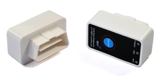

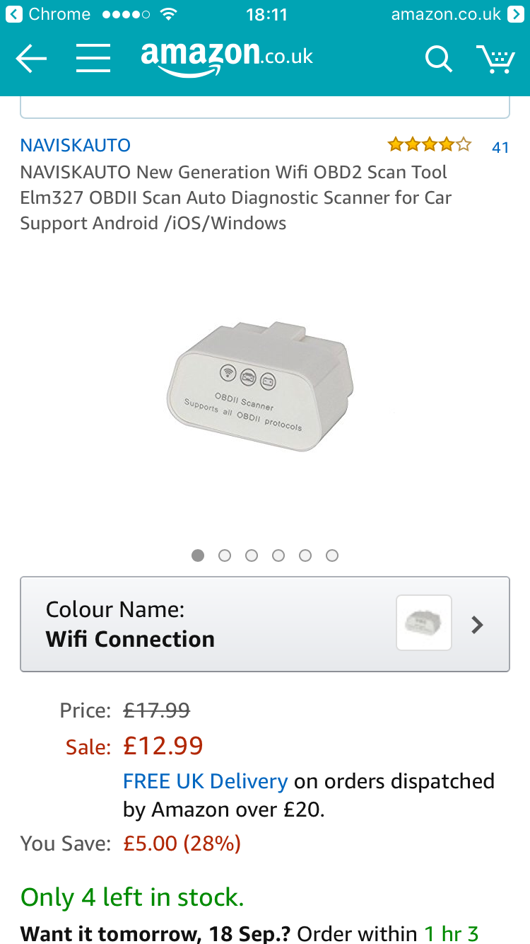

Turned out it was my wifi adapter that wouldn't work with this vehicle worked on others though so very odd. Managed to find one that works I'll post images below. Thanks for all help and advice.

Hey, i have purchased the same setup. With ELM Bluethooth OBD Adapter and Windows Phone with OBD Auto Doctor. I Was able to connect it and show some basic data, but to me it felt that it was very limited so i went in different direction to get the job done. Are you actually able to read some of the error codes? Because mine didn't show any even i had some come up with the other option.
I
If I remember, I think I purchased the upgraded app, and it only cost a few Euro... But again it's limited in what it can do..
