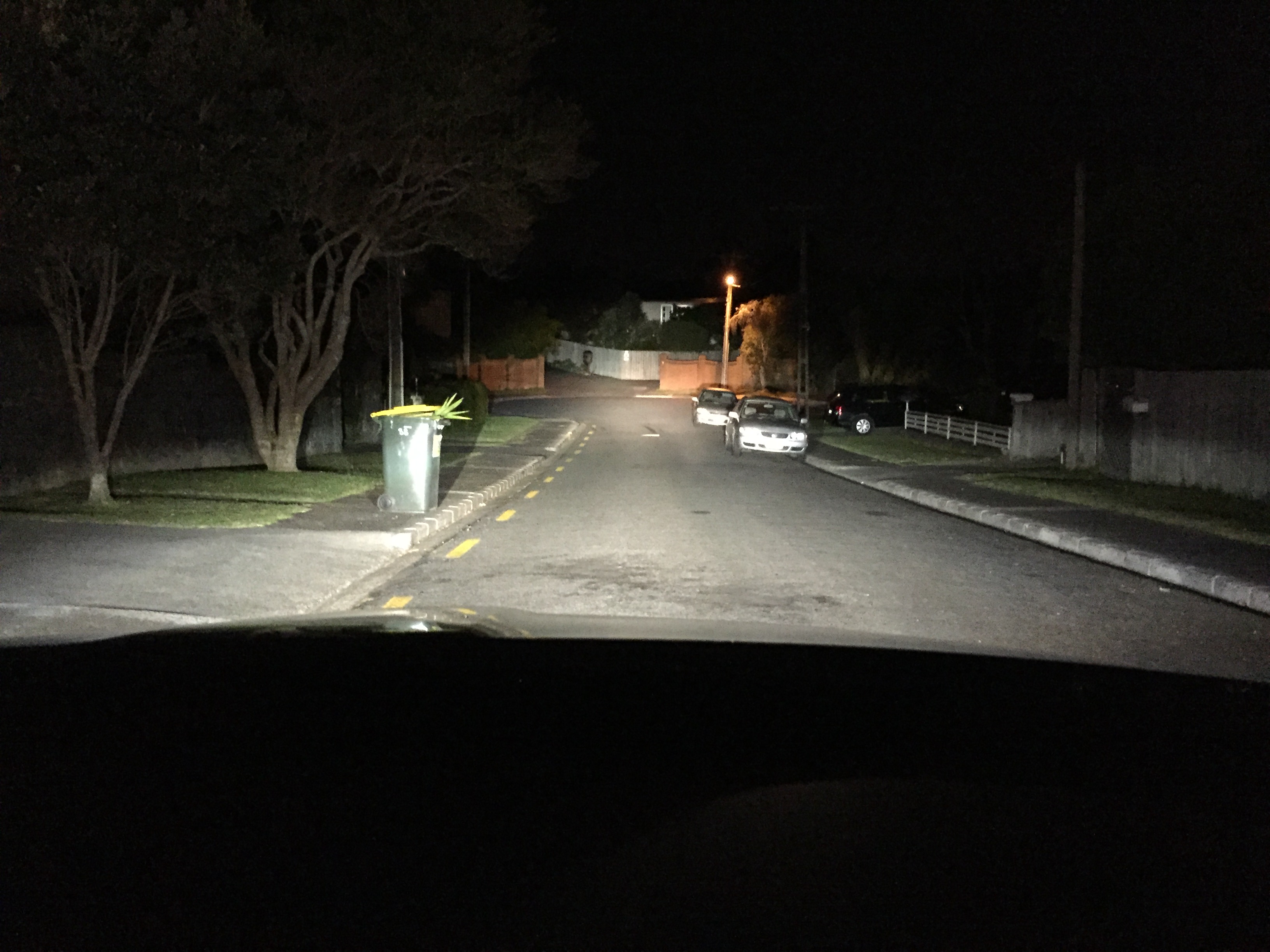

I've been meaning to upgrade the halogen bulbs in our car (2010 Elegance). Below is what they currently look like. I have heard the Osram Nightbreakers will be more blue/white so should match better to the Bi-Xenons.
I just stuck with the best halogen bulbs I could for the main beam. I think they're H1 iirc. It works really well imo and better than the single bi-xenon setup in FILs Mazda 3 MPS mk2.
It fills the void between the bi-xenon nicely.
