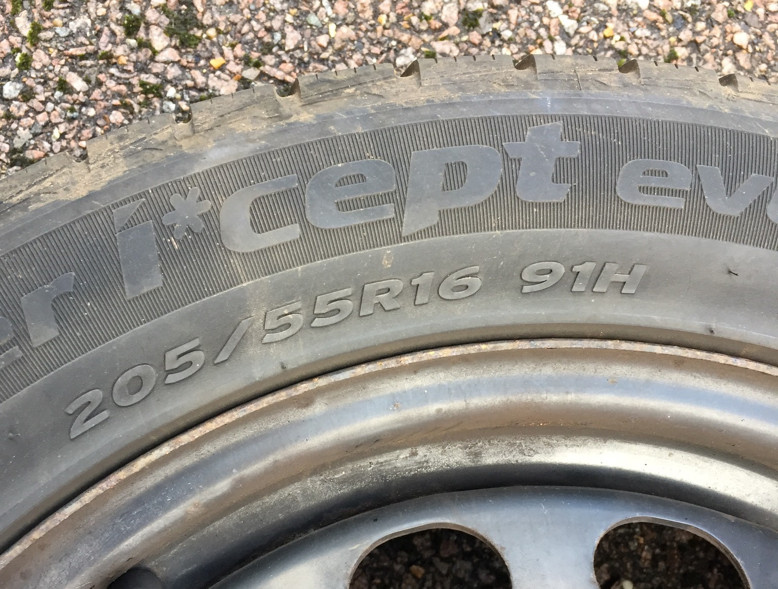

current winter tyres spec as per image,
For your year and model, the lowest speed and load rating that is type approved for 205/55/R16 is 94V.
And Octavia wheels are not strong enough for Superb. Part number should start 3C0601027... (same as Yeti)
I'm just going through the same process.   Some of the places I look (mainly those selling tyres/wheels) think 91 is OK, but in other places I see 94 as the load rating.   Similar car, facelift Superb 170 dsg estate.
