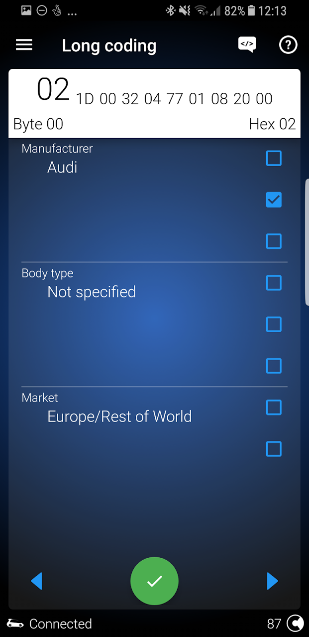

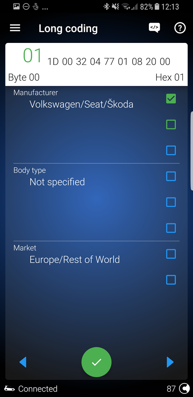

Am i right in thinking that to enable the Audi Throttle Pedal with OBDeleven i need to change this....
to this
