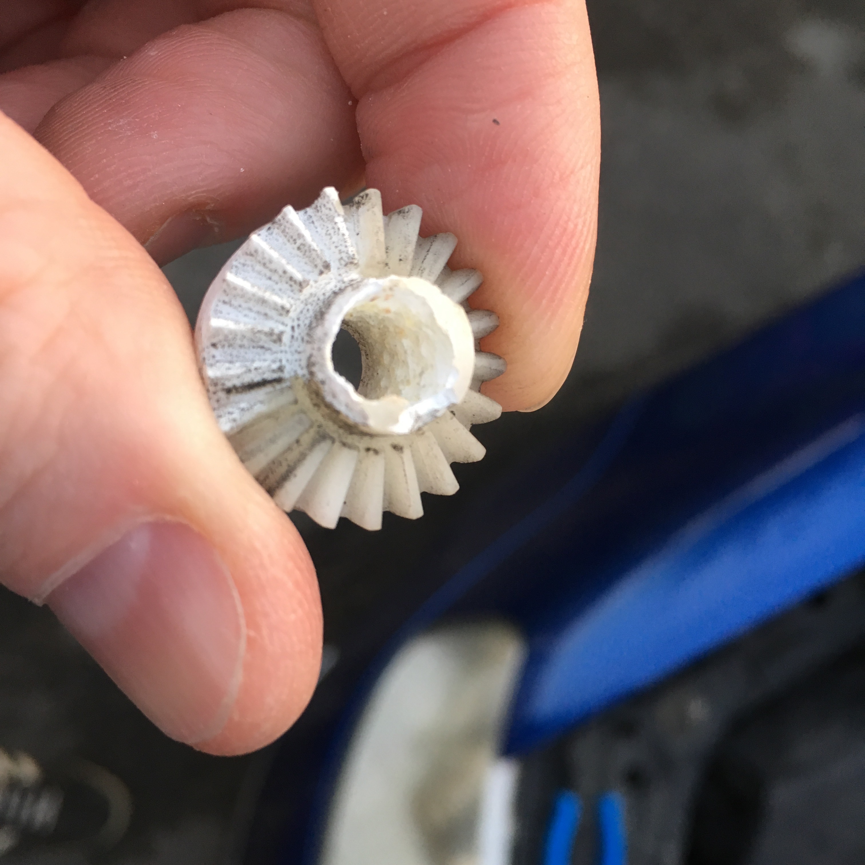

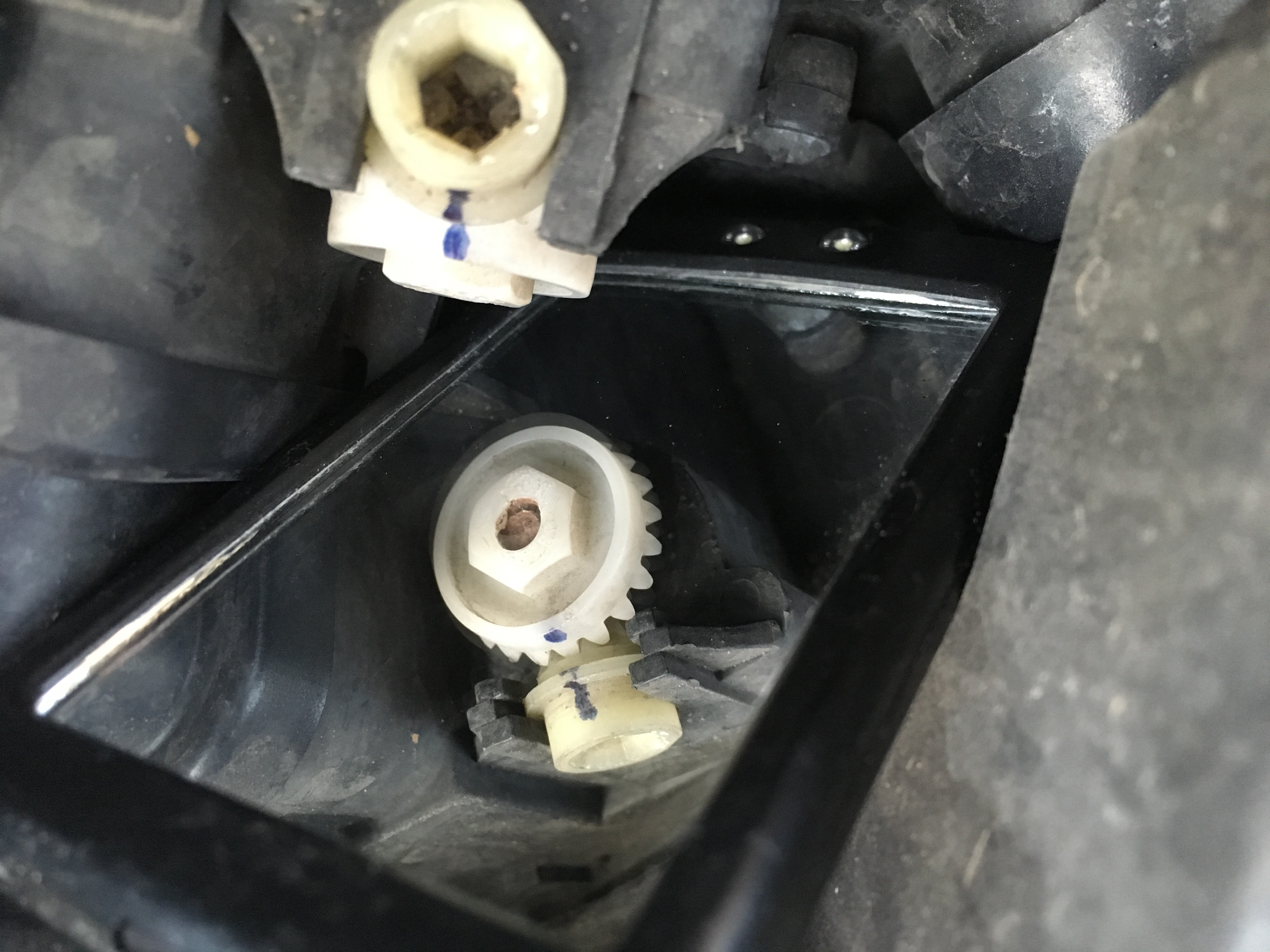

Thanks for the replies - I have got it sorted now without having to double the value of the car with spare parts. First problem was the adjustment: quick look and mess around showed that the white plastic gears (photo below) that can be used to adjust the beam were eroded/corroded (another photo) and not gripping the knurled bit of the adjuster shaft so just spinning freely - found rotodiesel's helpful advice (below) which helped no end and alignment is now OK. No related errors on VCDS so leaving well enough alone on that front.

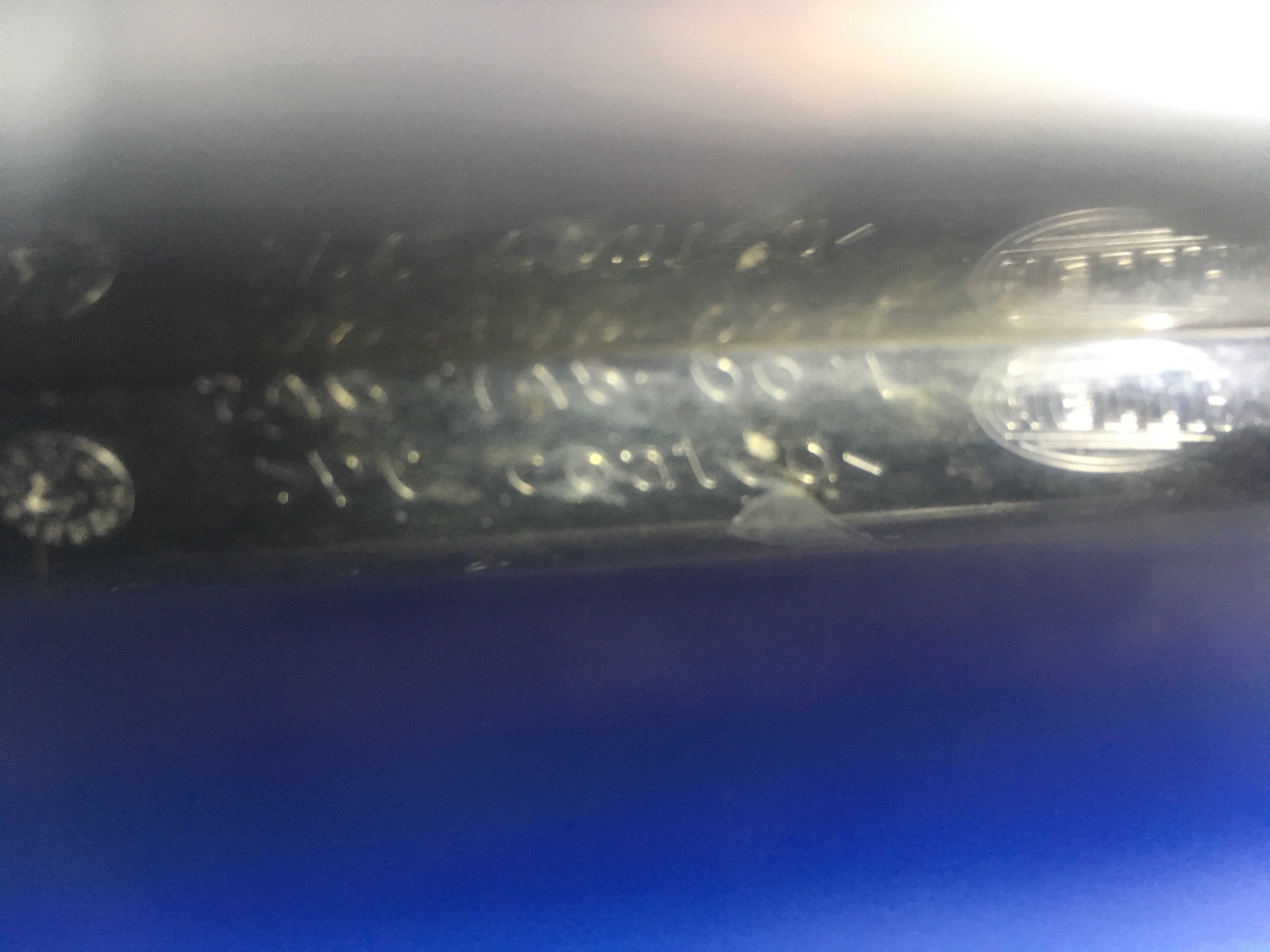

I managed to find out the Hella part numbers (well, that's what I assume they are!) in case they are of use to anyone else. They were at the bottom of the light and just visible in the gap between the top of the bumper and bottom of the headlight with aid of a torch: 246 745-00L & 246 746-00 R. Photo of one attached.
