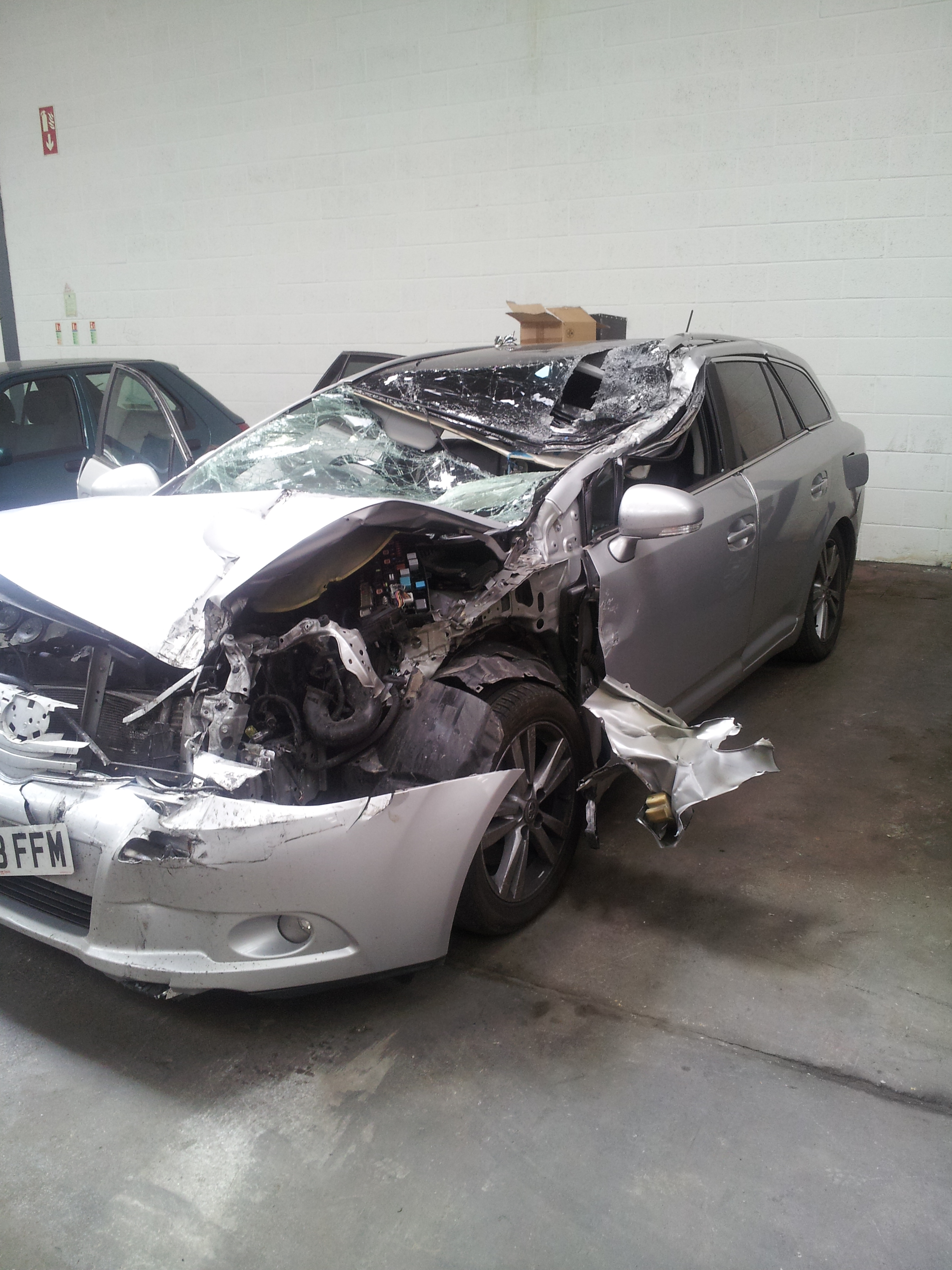

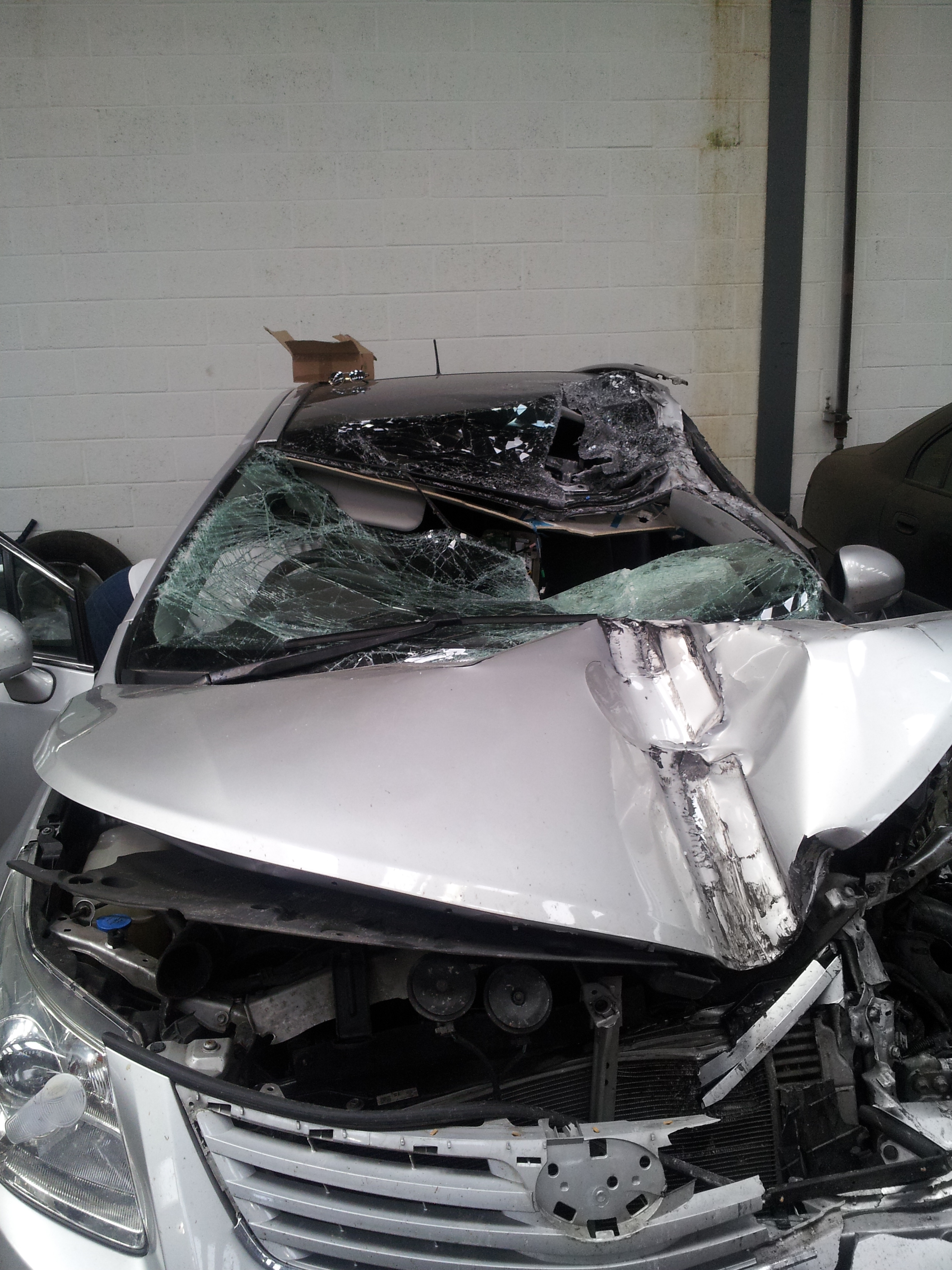

I was in a serious RTA - lorry decimated passenger side - thank god no one was in that side - the lorry was resting on the passenger head rest - no deployment of airbags on that side - my side - they all went off and saved my life

Not a scratch! That is how good modern car construction and airbags are these days.

I am certain that in a 1970s car, the engine lump would have been in my lap. Some of the force in this accident was transferred to components that buckled at the back of the car - the boot hardly opened.
