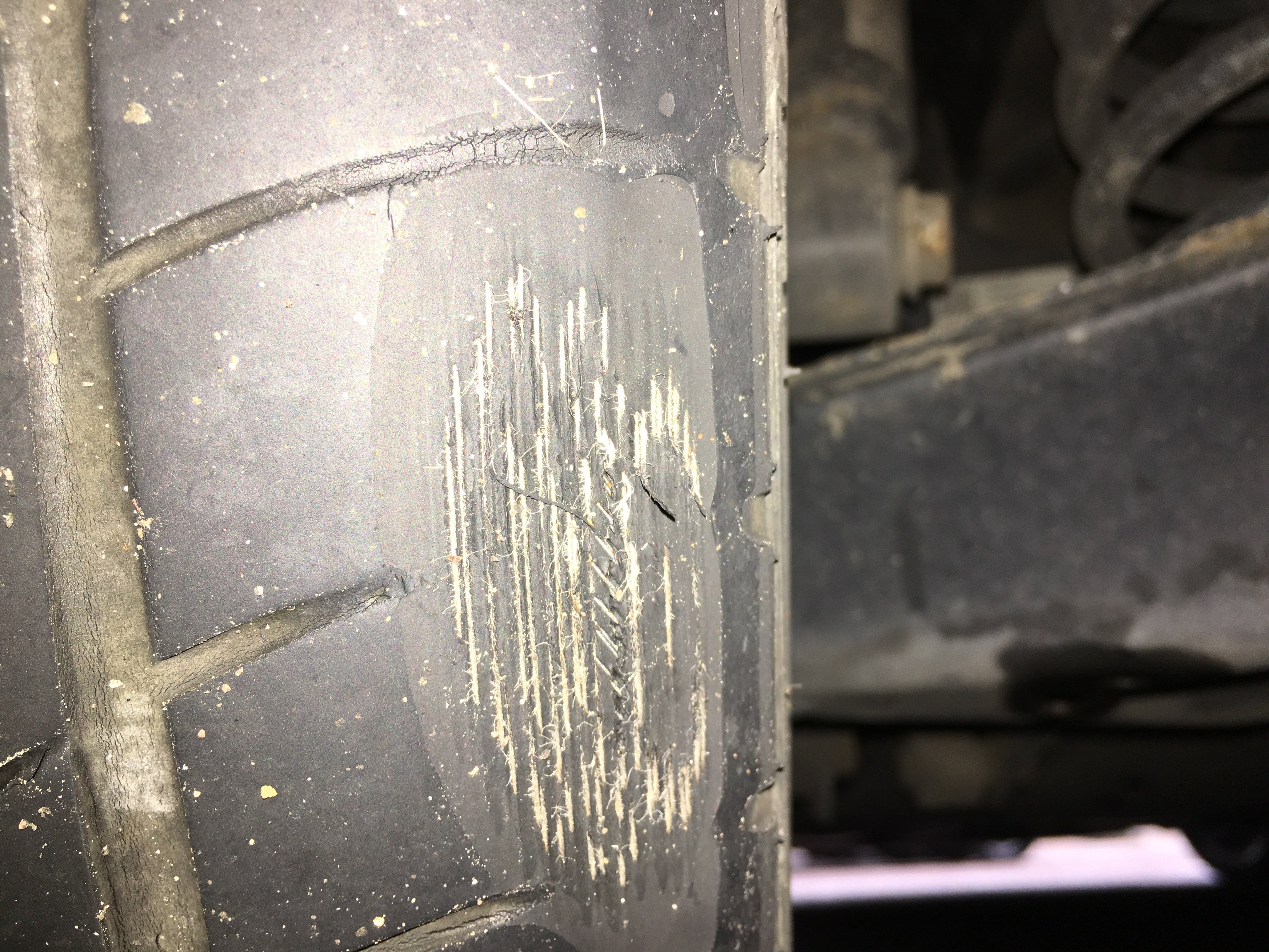

My  2014 Skoda Superb Estate has  225x40r18 Avon tyres on ,new ones the front
I found i am  getting  lot of excess tyre noise with these and about 70 i get an effect as thou the car going through a tunnel from the back end

I'd check the inner edge , they'll almost certainly be knackered
Yep - actually that has happned to me twice - if it has happened get the tracking checked
I'd be checking the rears for tyre sawing
had it while back and sounded awful
Also check you've not got a wheel bearing on the way out. Mine sounded like tyres in a bad state but was in fact a wheel bearing!
checked bearing and tyres and found this on the inside rear tyre
thanks of all the help
Now that's a flat spot!
At least you it now and not when the boys in blue are behind you.
