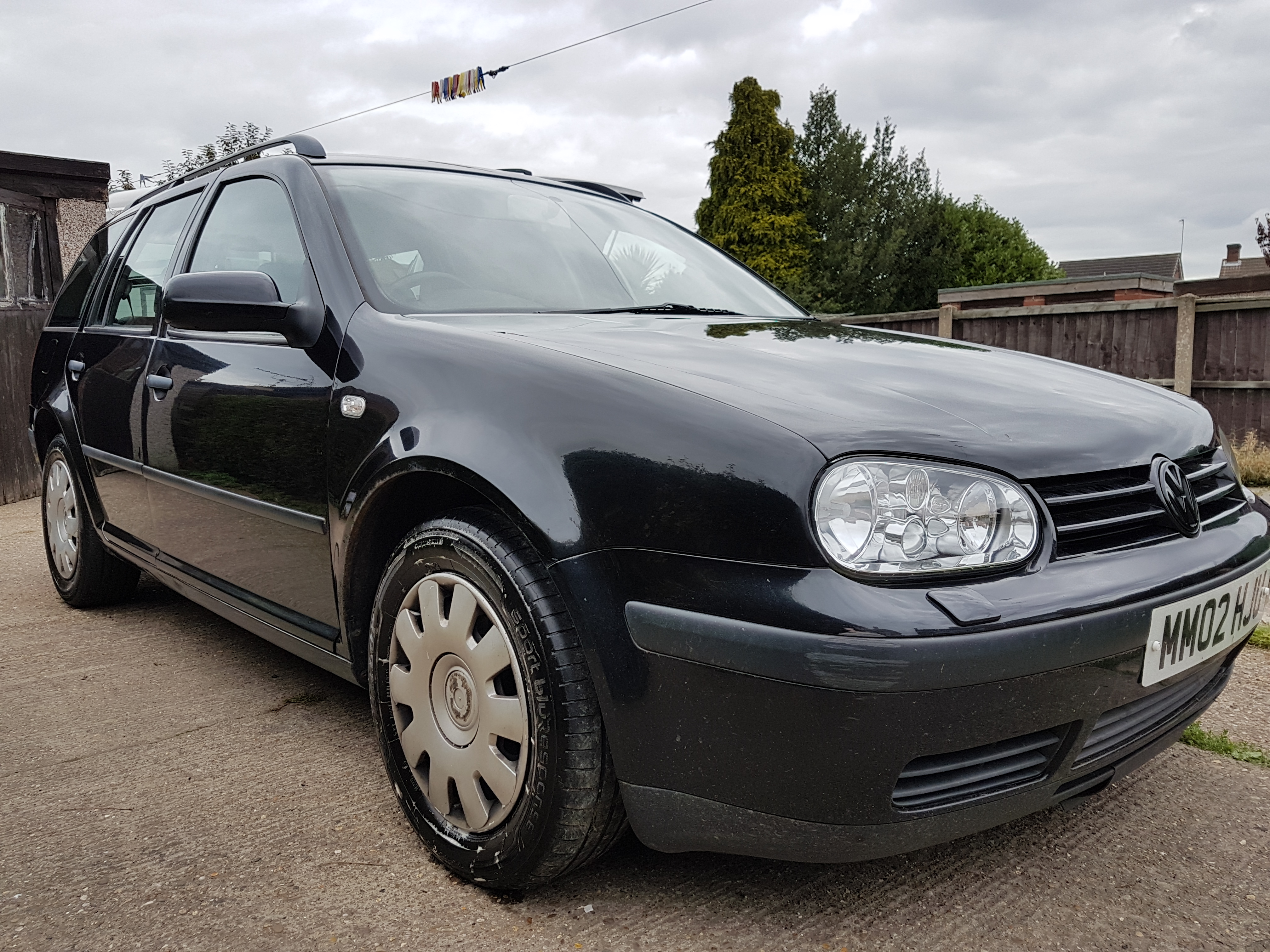

Si's golf tdi E-state
Bought this mega cheap off a lass down at the stables.
1 for tinkering with and
2 to keep the miles down on the x5.
Pd100 tdi
2 owners
Great history (before she had it off her dad.)
Winter pack so:
elec sunroof,
full leather (heated fronts),
aircon,
cruise control etc
It came with its issues and could still do with a screen but it's now mot ready.

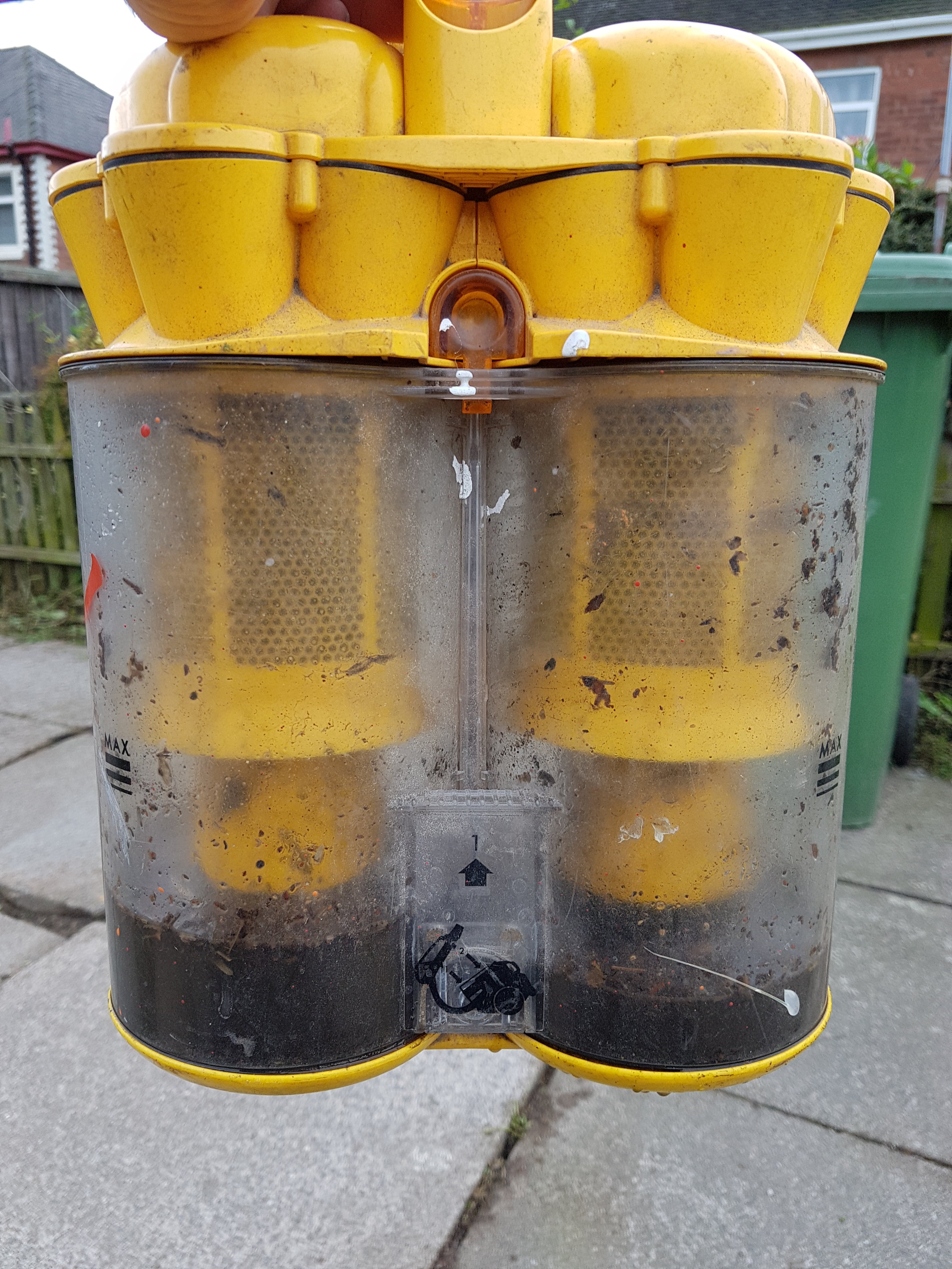

Sunroof drain tubes were next on the list and my good I've never seen so much gunk :(
Drivers side not even connected and was solid with dry muck.
Passenger side was full of slimy gunk, all cleaned and good to go.
All faults cleared and not returned.

Not sure the Dyson was meant for sucking water up :D

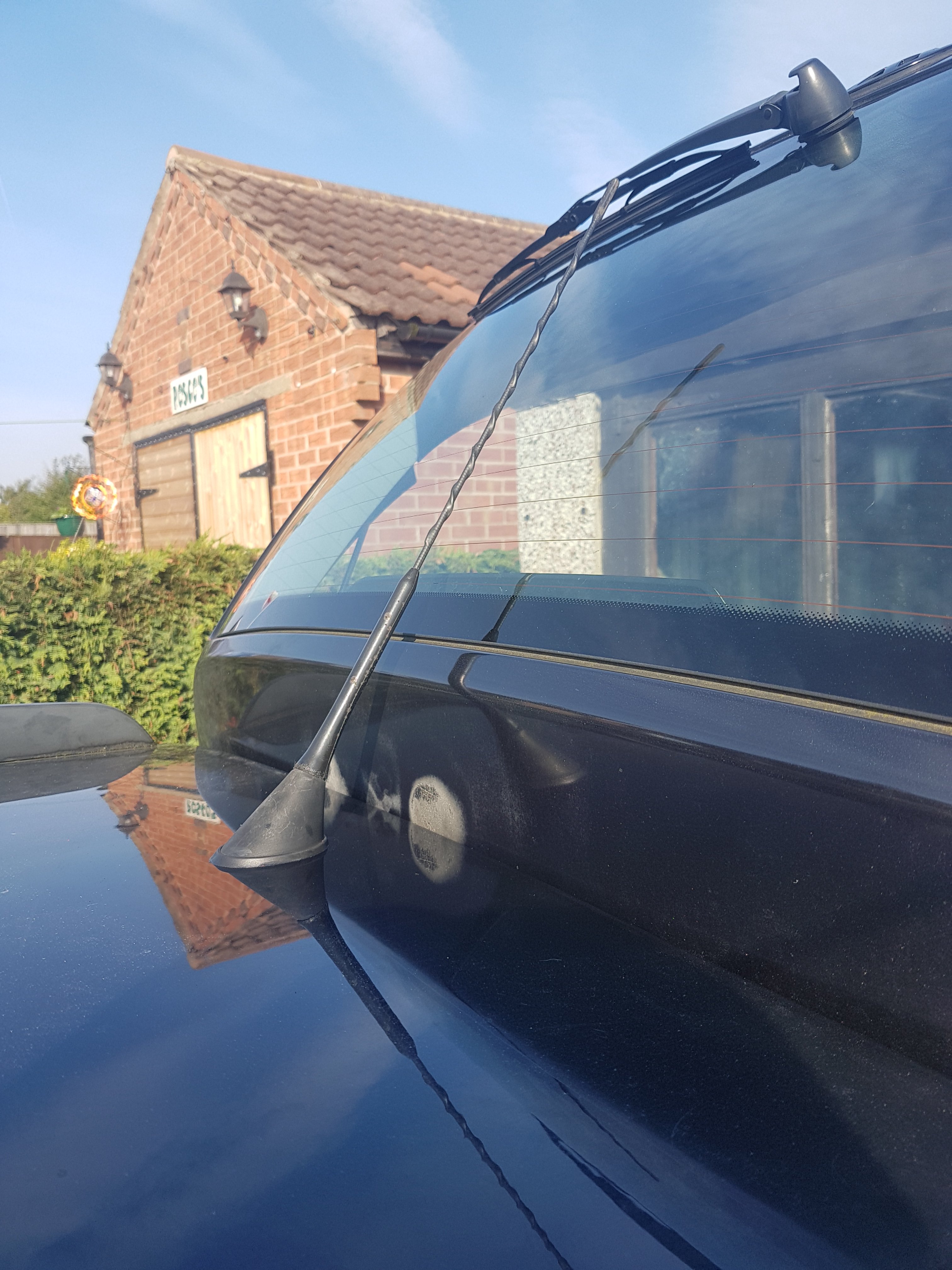

Needed and aerial and base, good job I kept the one off the vrs when I smoothed it out ;)

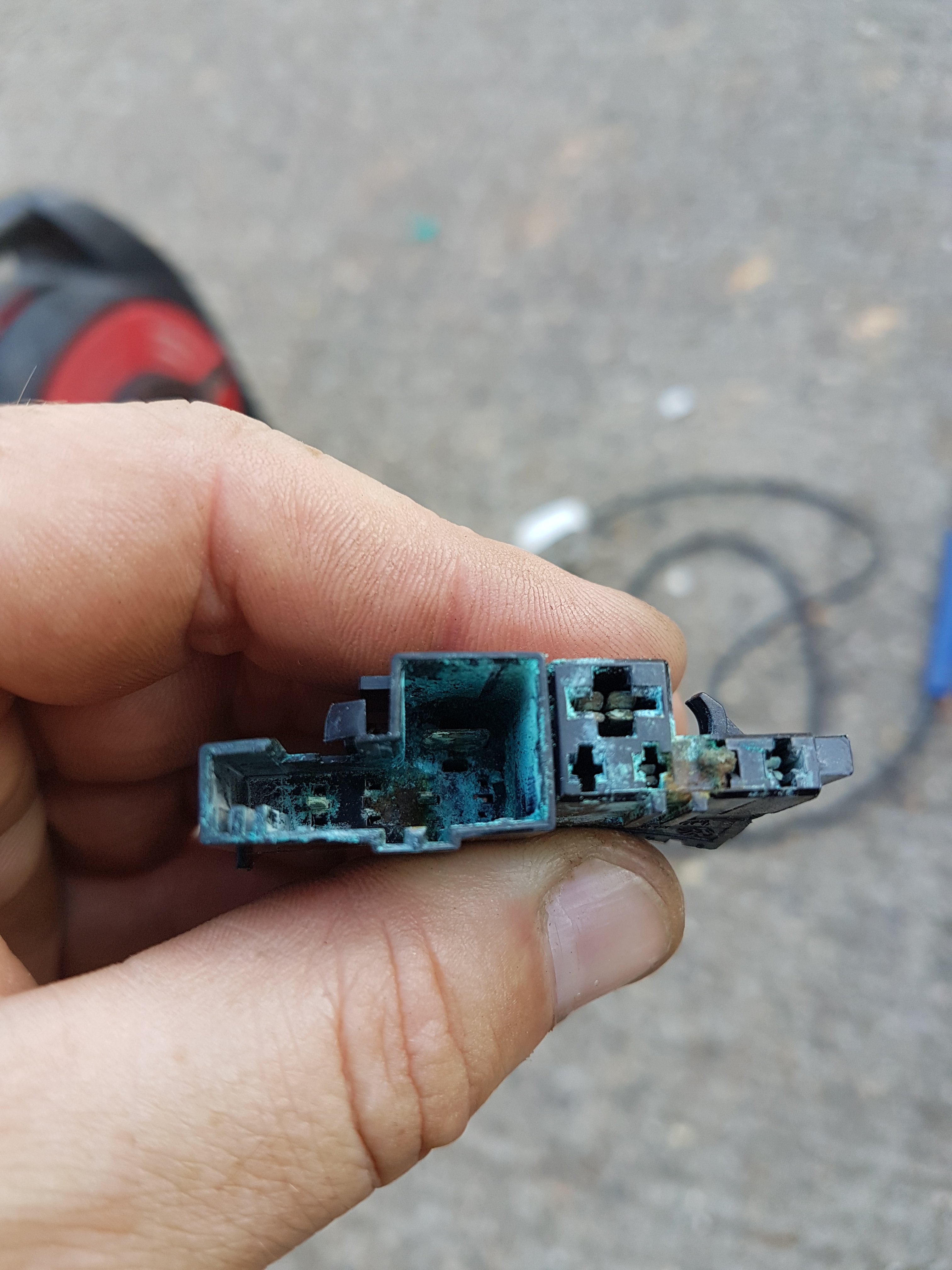

Another issue popped up after I'd fixed the rear wash pipe.
Dash would illuminate to tell me the tailgate was open and the alarm would go off all the while.
Turns out the pipe had been leaking all over a wiring plug and over time the wires and pins in the plug have corroded and snapped. Seen as it's only a cheap runabout I cut the plugs and soldered the wires :)

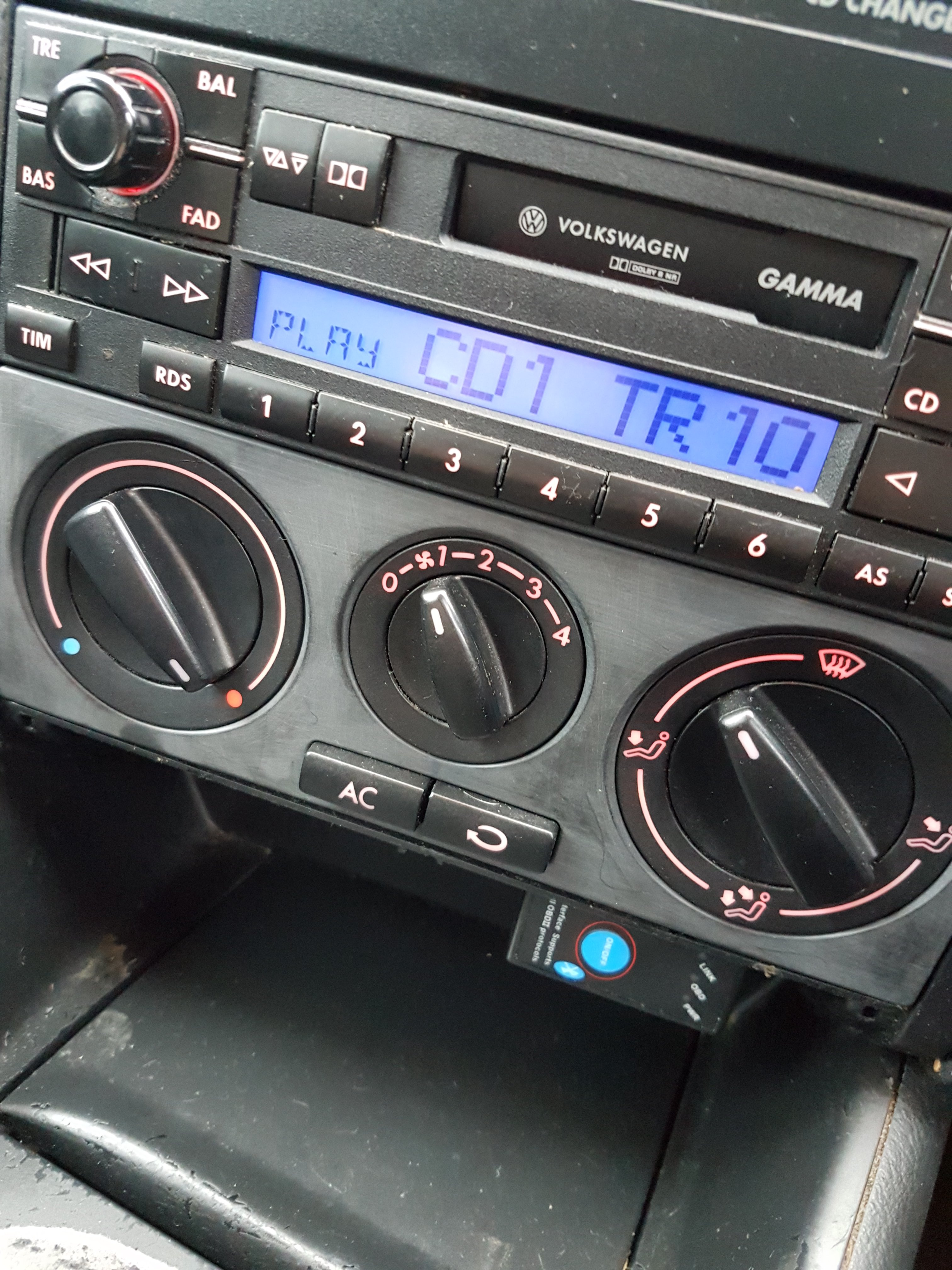

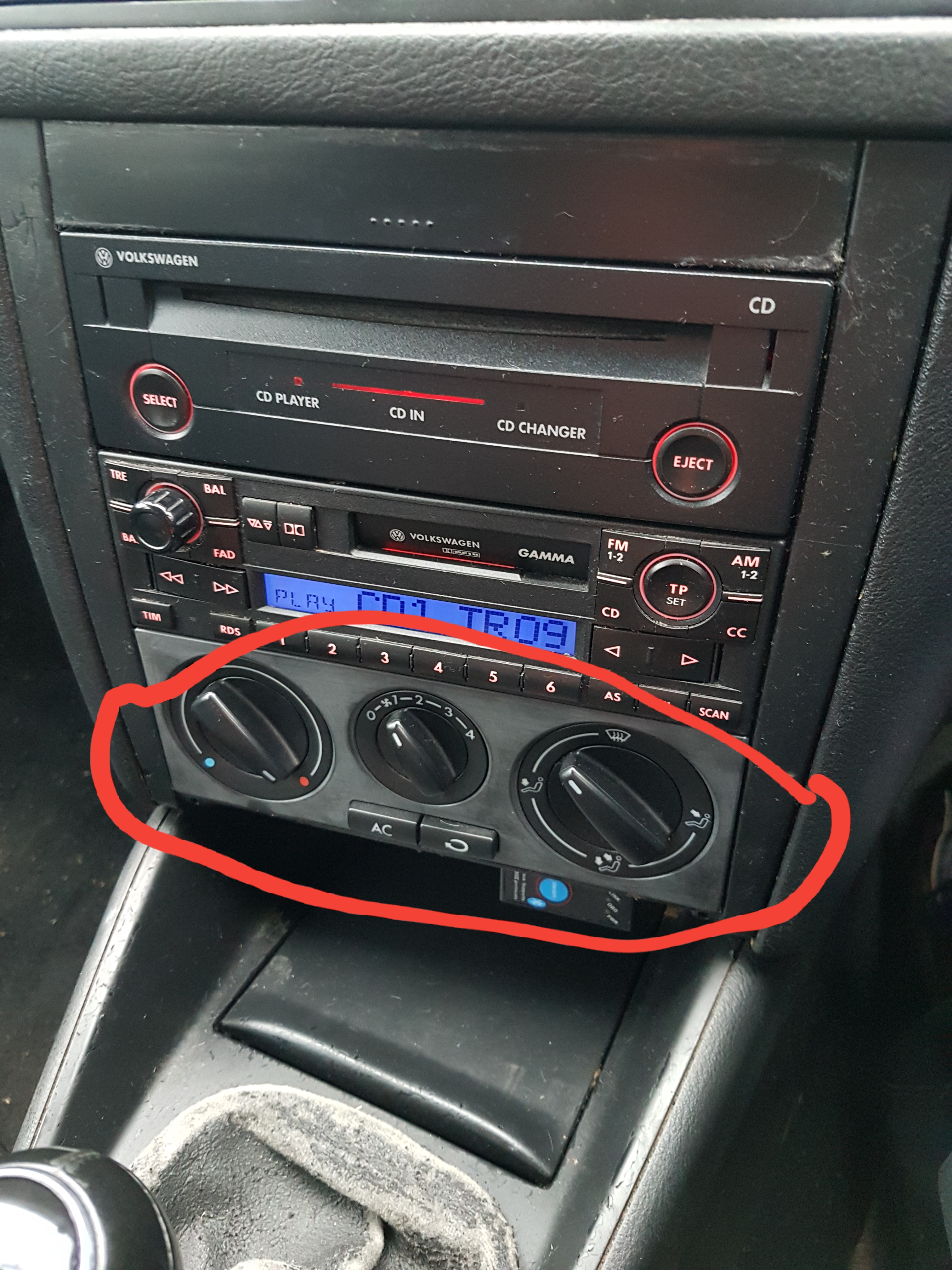

Another issue sorted. Since I've had it mot'd and been using it In the dark I found the heater controls never lit up and it annoyed the hellout of me. Turns out it was only a single bulb :D
Fixed

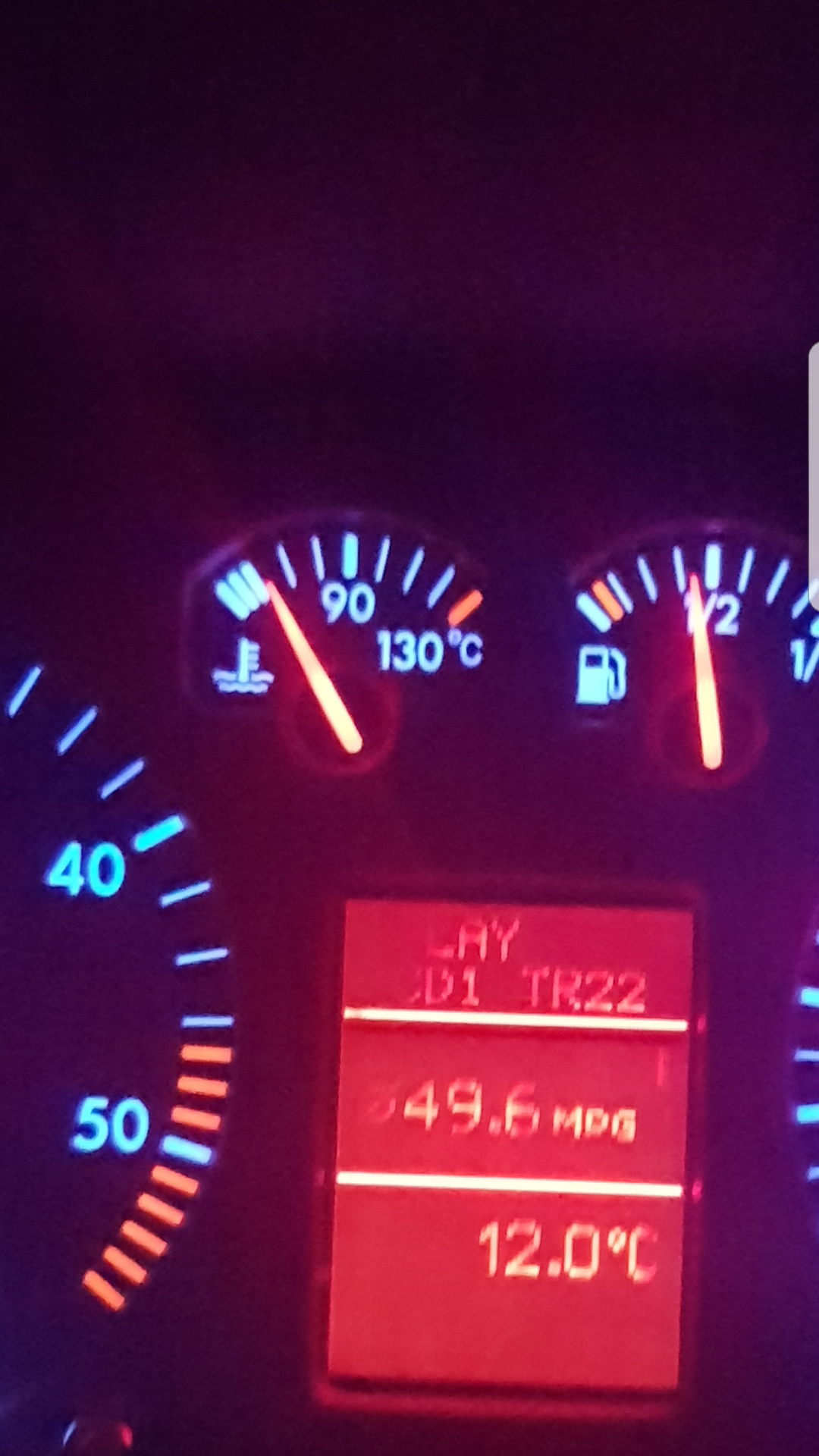

Gauge doesnt move any higher so not sure if coolant temp sensor or stat so I'll swap both out for new.
Deffo need to get some roof bars and a cycle rack :D
Full FIS clocks that's a nice extra to have. I had the exact same issue with my temp gauge and did the same as you're planning, new genuine thermostat and genuine coolant temp sensor also gave the coolant a good flush through and filled with new stuff. It says you have to remove the alternator to get at the thermostat in these but you can just manage to get to the thermostat housing bolts without removing the alternator.

I've looked at a few YouTube vids and it doesn't look to bad tbh, it's booked in next sat for a new screen so that's another tick off the list.
