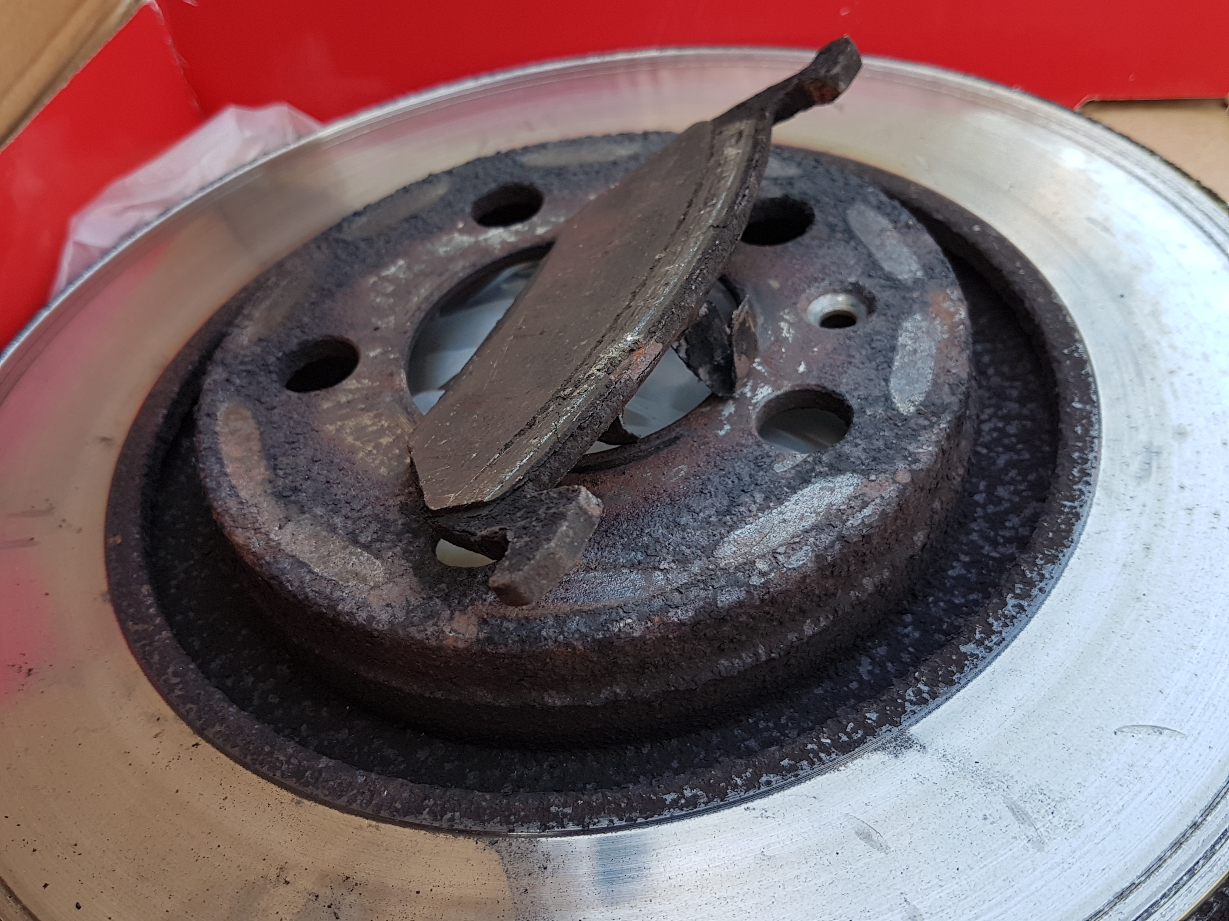

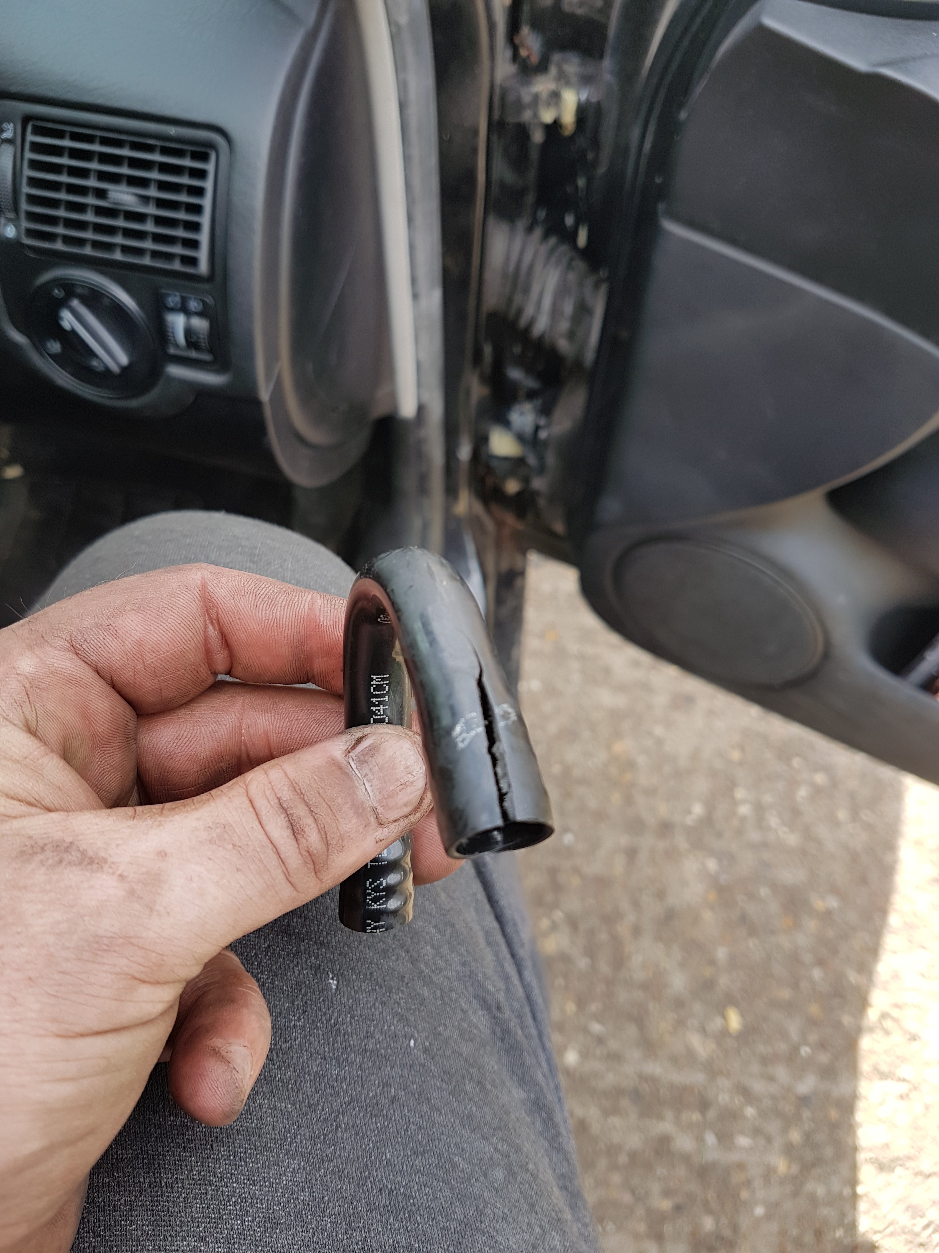

Couldn't wait to source new hubs for the 312 upgrade calipers & carriers I've got as the old ones are near on metal to metal it seems. Fitted new discs and pads which should have been straight forward, took it for a blast to test them and nothing!
Came back, wheels off checked everything all ok so off to test again and still nothing.
Scratched head, had a brew and had a look on Google. Checked all vac hoses seemed ok, started the car and heard a hissing noise.
Found the little f@#$%¥ :D
Luckily found some hose up to the job in the garage so all good again.

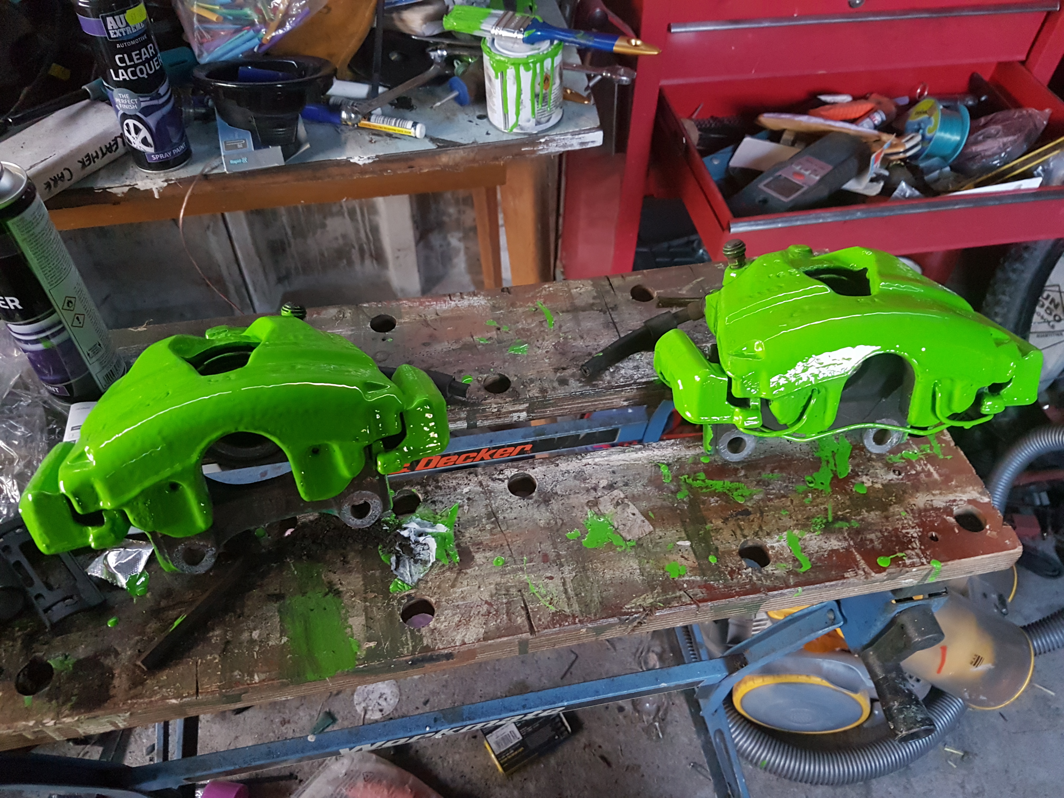

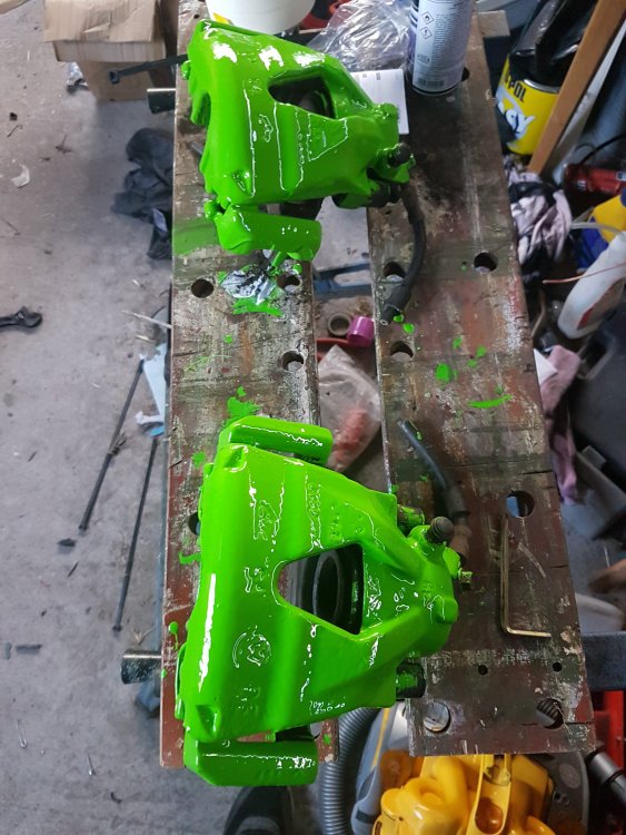

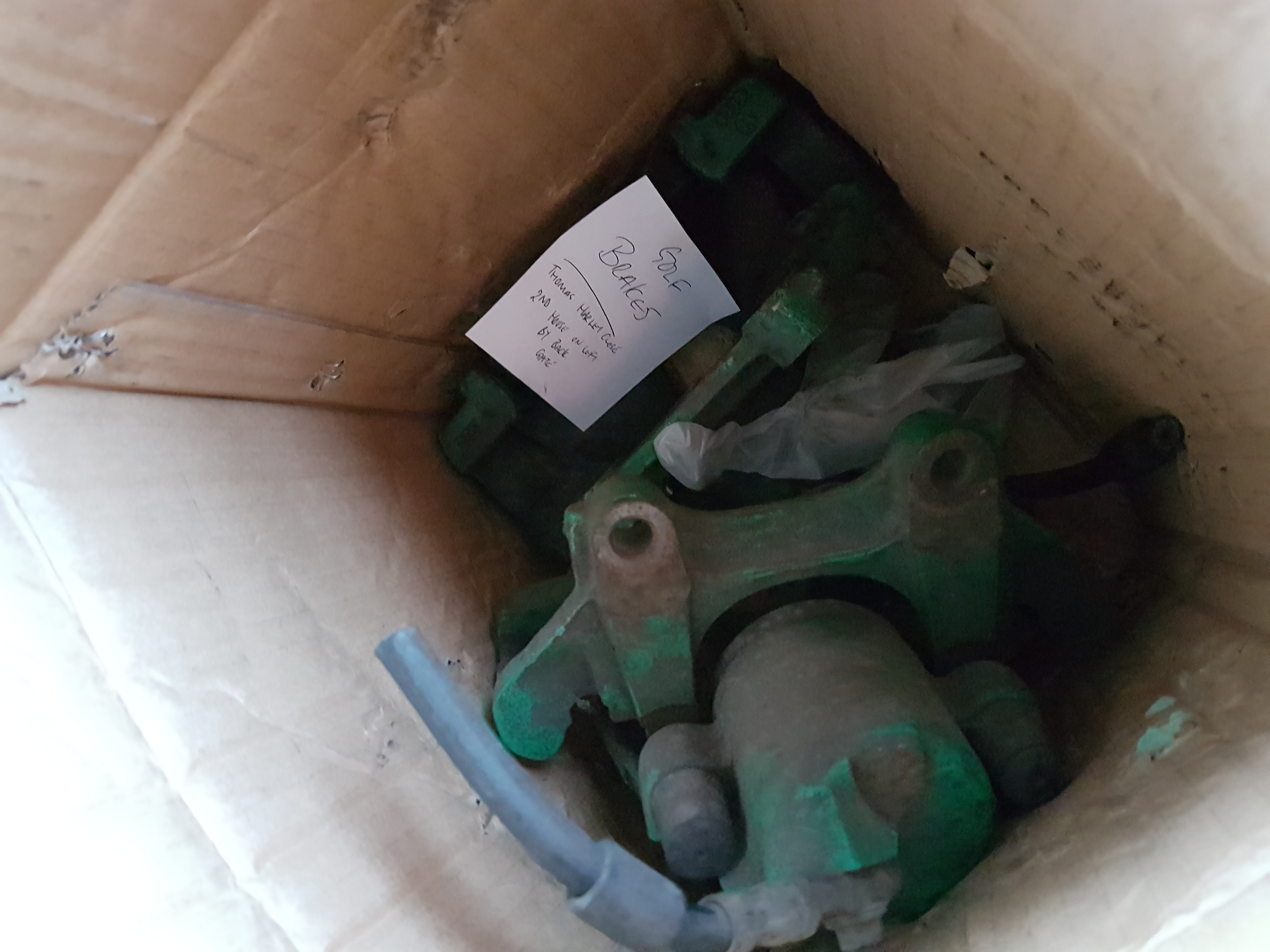

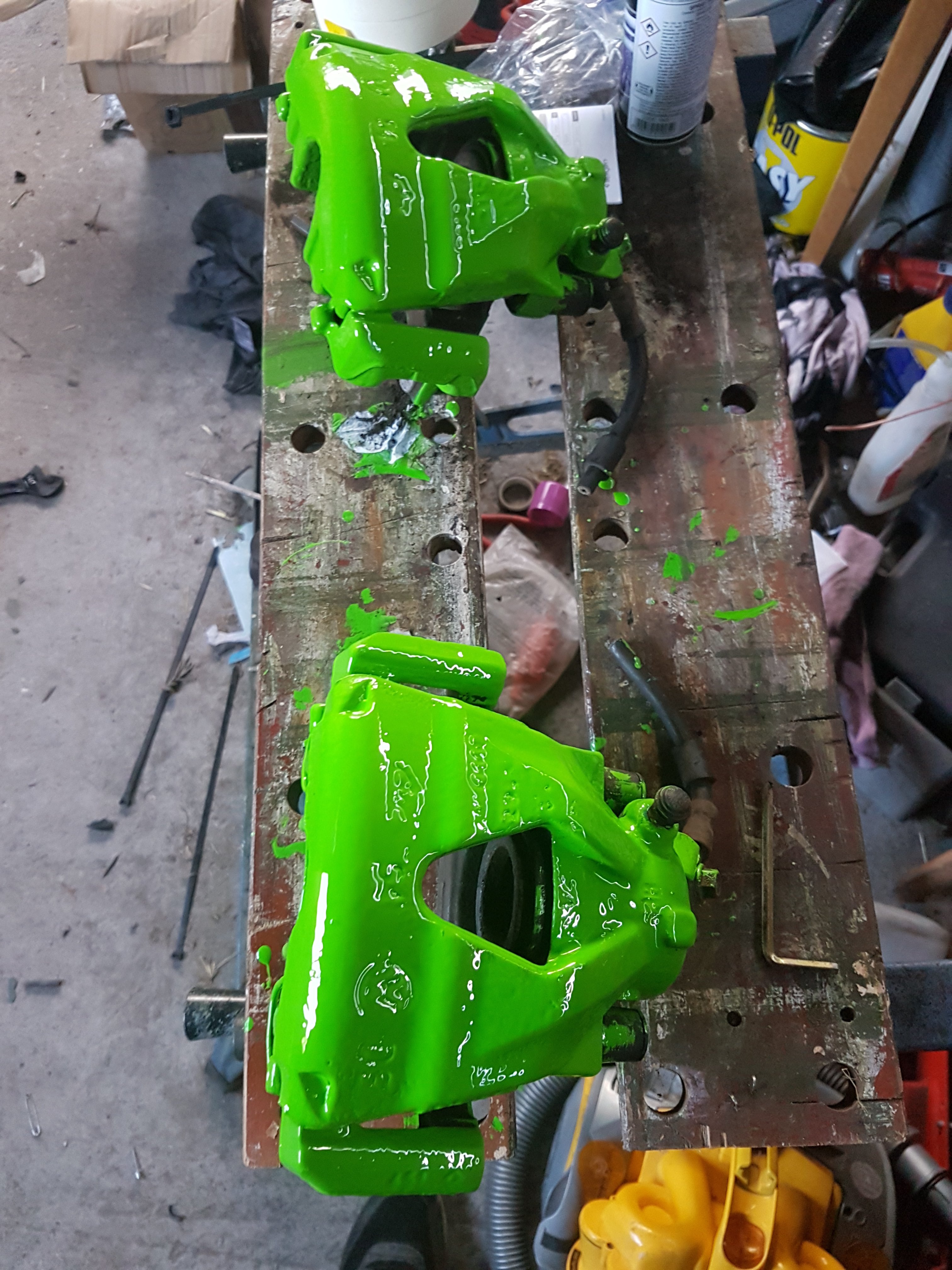

Finally managed to collect the vrs 312 calipers this morning.
Gave them a lick of paint to freshen them up, just need to get some hubs now.
