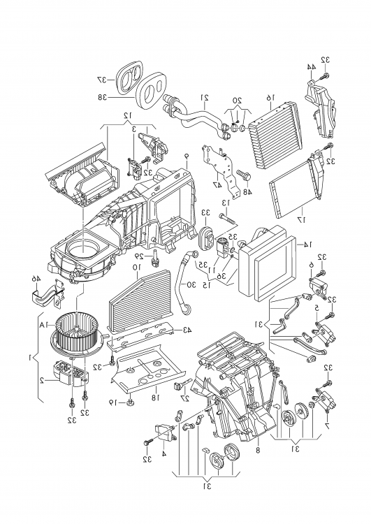

Another (maybe soppy question) most data I can find is LHD but found: http://www.realoem.me/Skoda/CZ/OCT/2013/663/R/8/820/820020 and question is related to config R/LH. I've reversed the image to what I think is RHD and if wrong can someone tell me as if the regass doesn't fix things I'll start exploring beneath the dash.

27 4B0820539   temperature sensor
left, G 261, right, G 262 http://www.realoem.me/Skoda/CZ/OCT/2013/663/R/8/820/820010
And above depiction shows blower on RHS of vehicle? Is VAG limited to LHD vehicles diagnostically? Tomoz I am taking the glove-box out to see!
Both G262 (right - [on LHD?]) & G261 (left - [on LHD?]) are NTC thermistors (1k2 - 100k) that control L & R footwell flaps. So, how does a footwell duct affect the upper duct, especially when on the right and the left upper duct isn't working with low R134?
IMHO thermistors rarely fail, they are passive bits, so the flap motor would be suspect. If VAG had said G261 the problem it's more believable (if it's on the left?)
