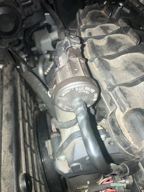

  1. Thanks appreciate the feedback and the code numbers👍 Yes overhaul seems in order. Though dealer has quoted more than the car is worth to do it 😟 I feel 129,000km is far too new for a car to require an engine rebuild, it really has marred my otherwise fantastic experience with the car

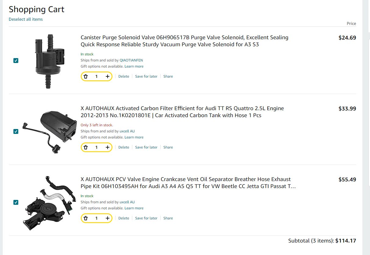

  2. I have all 3 of these parts in Amazon (Aftermarket) for $115 Am I missing anything? I just need the car to keep going for another year or so, so aftermarket should do the job?
  3. Hi Briskoda I have a 2012 Super 118Tsi with high oil consumption. Smoke does show from the exhaust when the car is revved high, but for general motoring its fine and runs beautiful Recently the engine light has come on, so after a trip to the dealer for diagnostics and $140 fee later, they have recommended replacing the PCV Valve, the Charcoal canister and Purge Control Valve For this they have quoted around AUD$650 for the PVC Valve, and around $1350 for the Charcoal canister and Purge Control Valve Looking at these, they seem like pretty straight forward replacements for a non-mechanic to perform (I am definitely a non mechanic, but they look simple enough on youtube) They mentioned the parts were $300 for the PVC and $1000 for the Charcoal canister and Purge Control Valve, with 1hr and 1.5hr mechanic install time. The dealer refused to provide the OEM part numbers, as they won't sell the parts alone to the public, even though I paid them for the diagnostics Does this sound about right? $2000 is ALOT to spend now on a 12yr old car that I am looking to replace in the not too distant future Can I clean the PCV? Could I try a wreakers for the parts? Assume these are the 3 parts and their part numbers?
