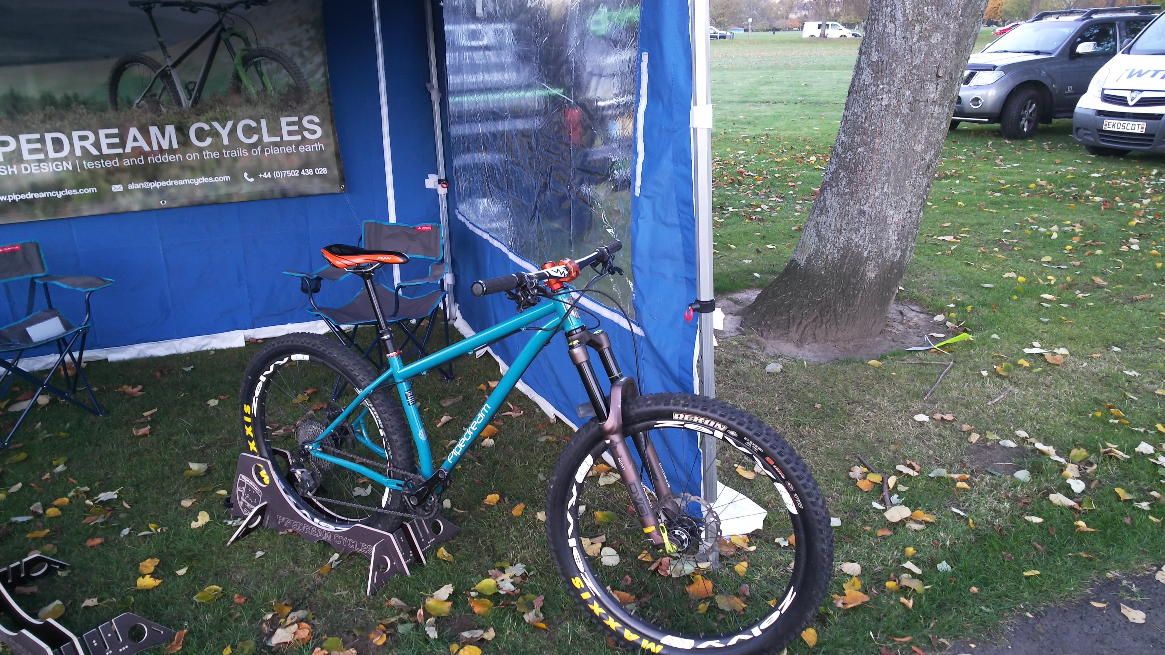

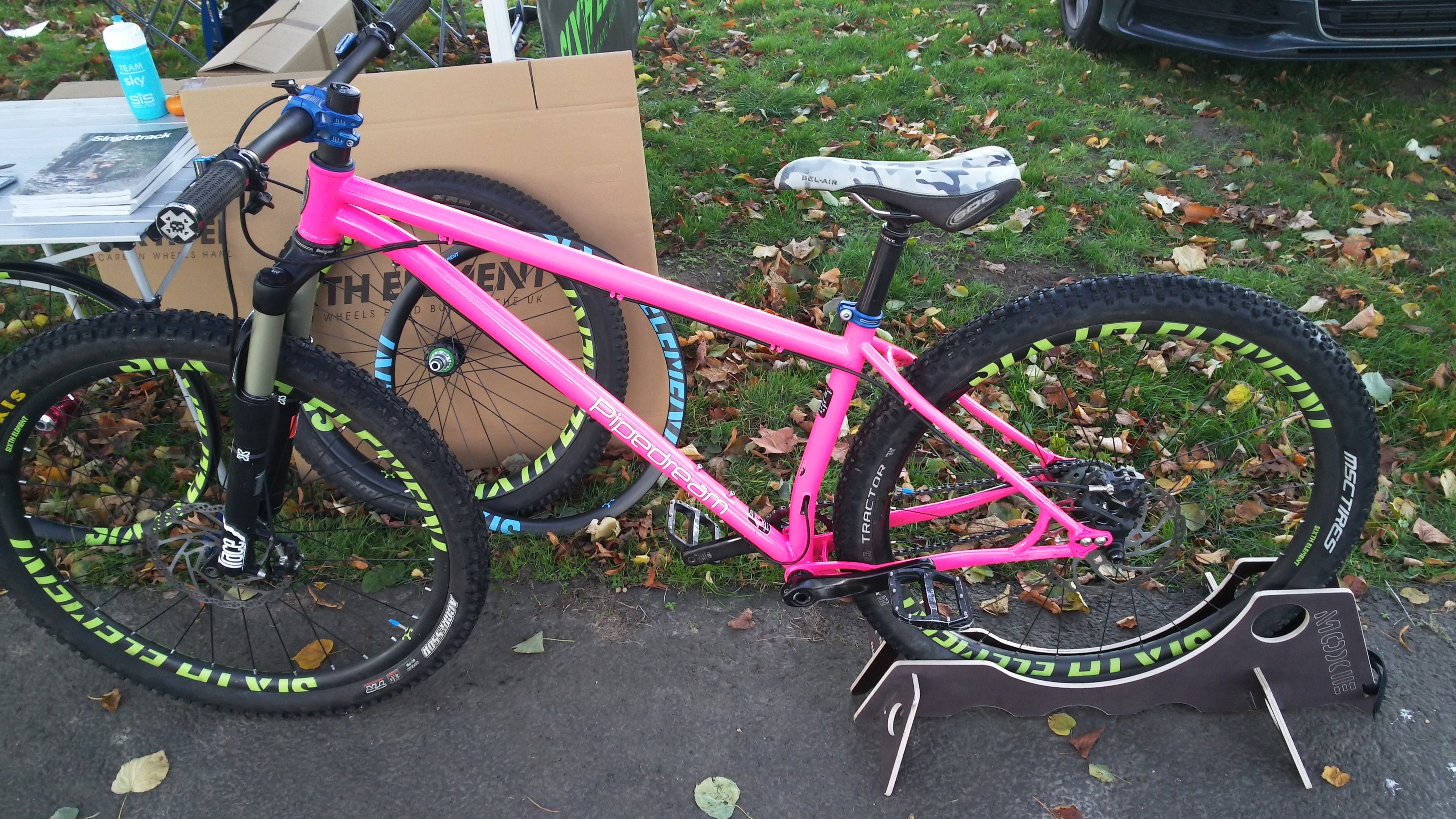

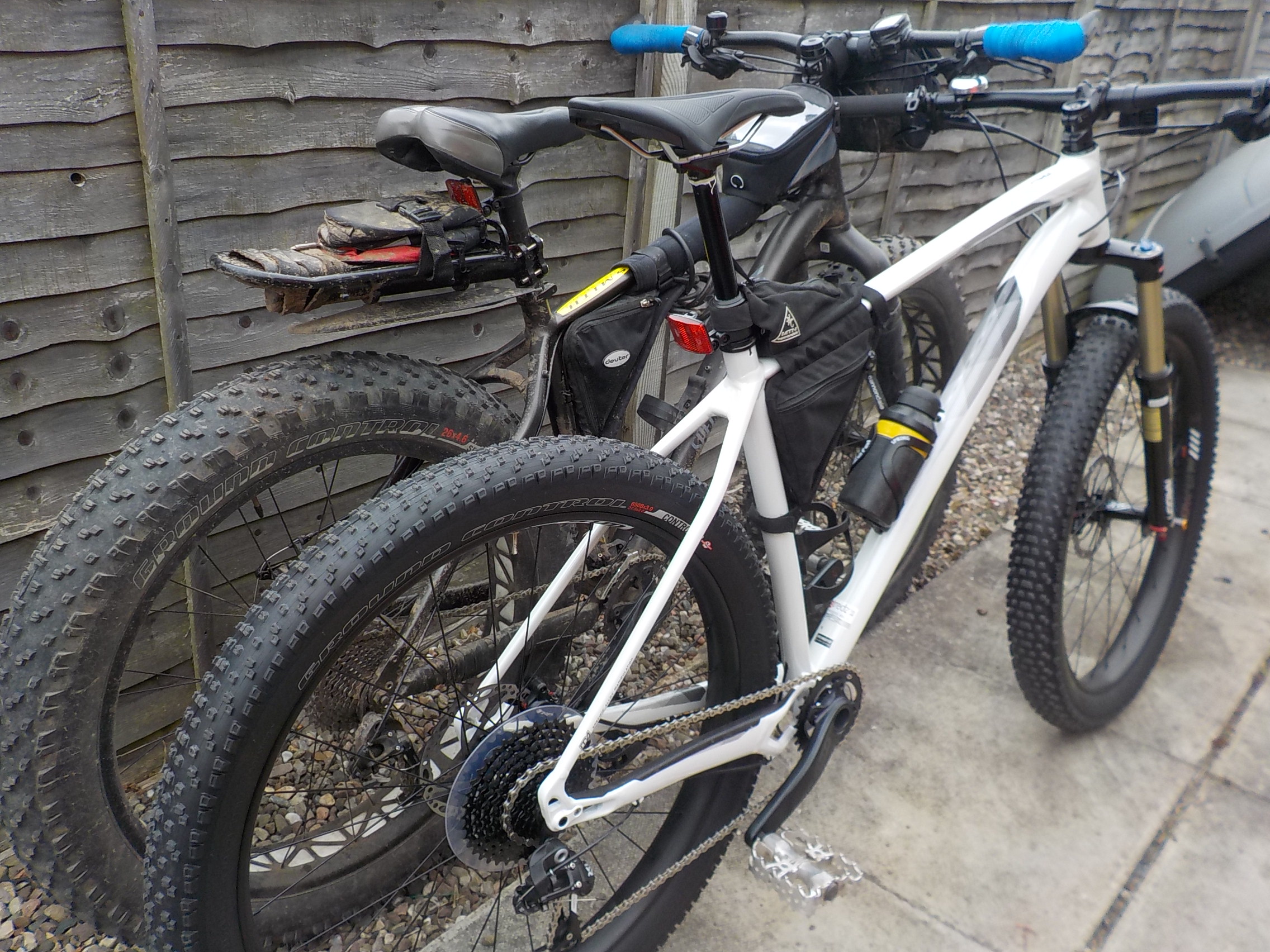

Best just get a bike with 27.5 Plus wheels/ tyres or a 29er.
i am 110kg and ride up and down kerbs daily and can not lift the wheels.
Or get a Fat Bike.

Those tyres look so cool! I need something with a better rolling resistance though at the moment :D
I'll have a hunt for some wheels then, I'm assuming anything over £100 or so will be half decent? Or do I wanna spend a bit more? I best go check the sizes

You pump up Plus size tyres and there is little rolling resistance as there is the same tread on the road as with a narrower tyre.
Then there is the fact that when you are rolling you keep just rolling along.
