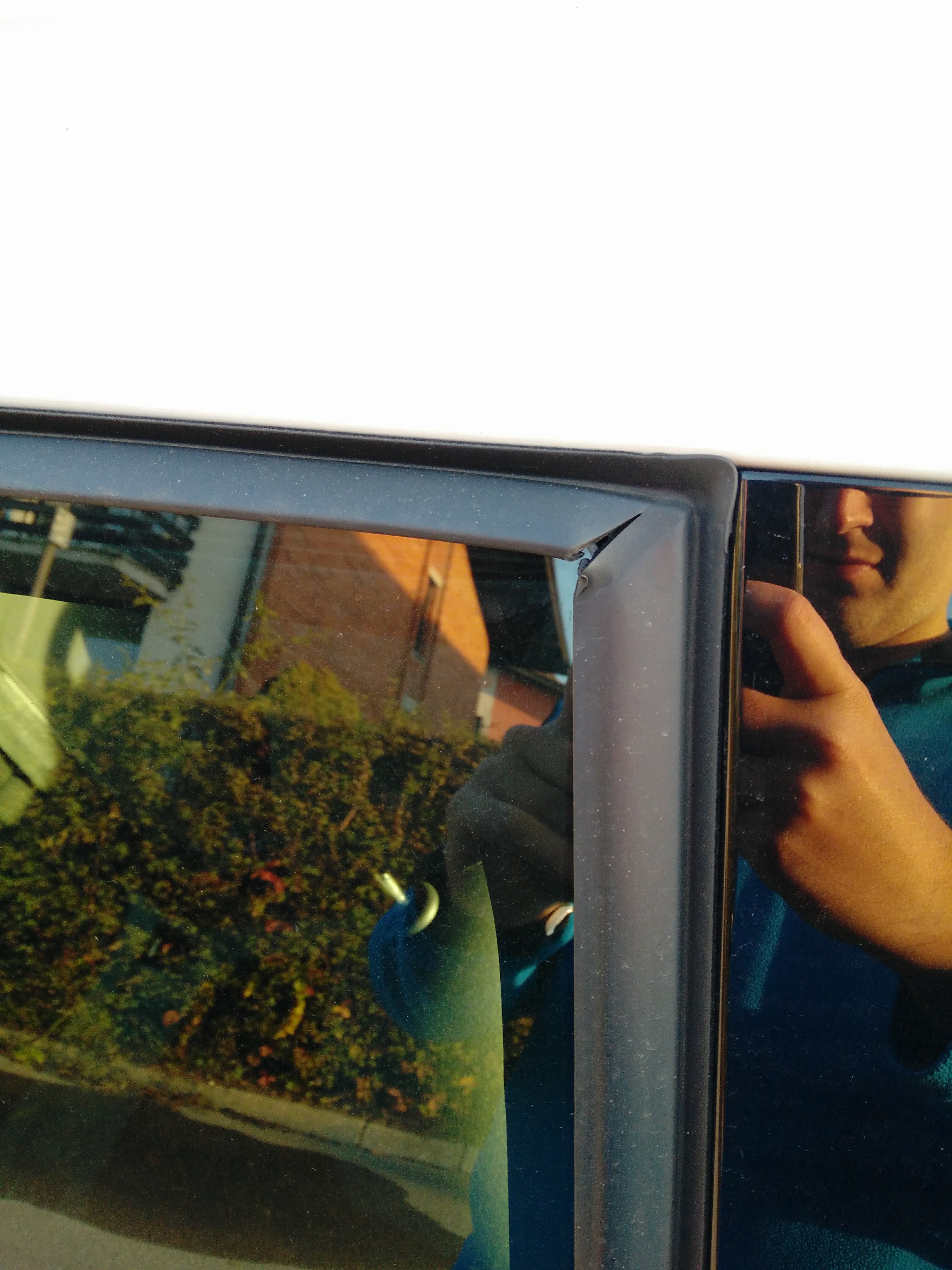

Has something like that happend to any of you guys? I have a cracked window seal on my back door. My Skoda dealer is going to repair it under warranty.
The same thing happened to me on the driver's door. I think it's because the electric window pushes too hard up into the rubber. I didn't spoke with my dealer yet to see if i can repair it on warranty, hopefully i can. I noticed it because at high speeds it makes some noise, a whistle and it bothers me. Please tell me how you repair yours so i can tell it to my dealer too.
Dealer changed whole window fram under warrennty. Now everything is as it should be.

@Jerc Can I ask how easy it was for dealer to change the window seal? Did they make any damage to the other parts of the door changing it?
Mine has a tear in the divers side so I;m looking to change it, but not if it's hassle.
The same thing happened to me. It will be replaced under warranty but as I live in Chile the part had to be imported and I am awaiting for it:dull:
That just looks like a very poor/bad bit of design there and that seal profile strip is just being cut, bent and welded - and that welding process is not fit for purpose, you get a lot of that in VW group cars, well at least in SEATs and as shown here in Skodas, cheap cheap!

I had my passenger side window trim/seal replaced due to the seal splitting on the weld as per the picture on Original post.
Dealer replaced it but unfortunately broke a door trim clip and grab handle clip whilst doing so.
They was kind enough to leave the broken bits in the door pocket and a rattling speaker to suit.
Needless to say they did repair it to my satisfaction when I went back for a service.
The seal has been fine since.
I think it all depends on the technician that is given the job on the day.:wondering:
