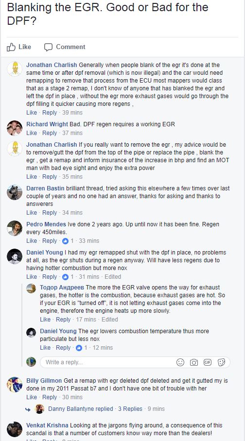

Thanks for your reply chaps. Actually now going for a professional remap and EGR blanking (using a plate) tomorrow with Pembrokeshire remapping /DNA tuning (I don't trust the guy who was originally sorting it!). My sole reasons for deleting it rather than replacing is 1) Cheaper to remove than replace and 2) (Hopefully) no more EGR issues
I'm led to believe that this won't have any detrimental effect on the DPF (and if it does, that'll be dealt with accordingly too) The car is driven fairly regularly on motorways or in 60 zones and still get the part blocked DPF light on at times (but clears easily enough with the built in regen cycle). Fingers crossed it solves my current problems. Modern diesels with EGR's / DPF's are a pain in my opinion - and for this reason is why it will be replaced soon enough with a petrol fueled car.

just asked the FB forum. Here are a few replies
