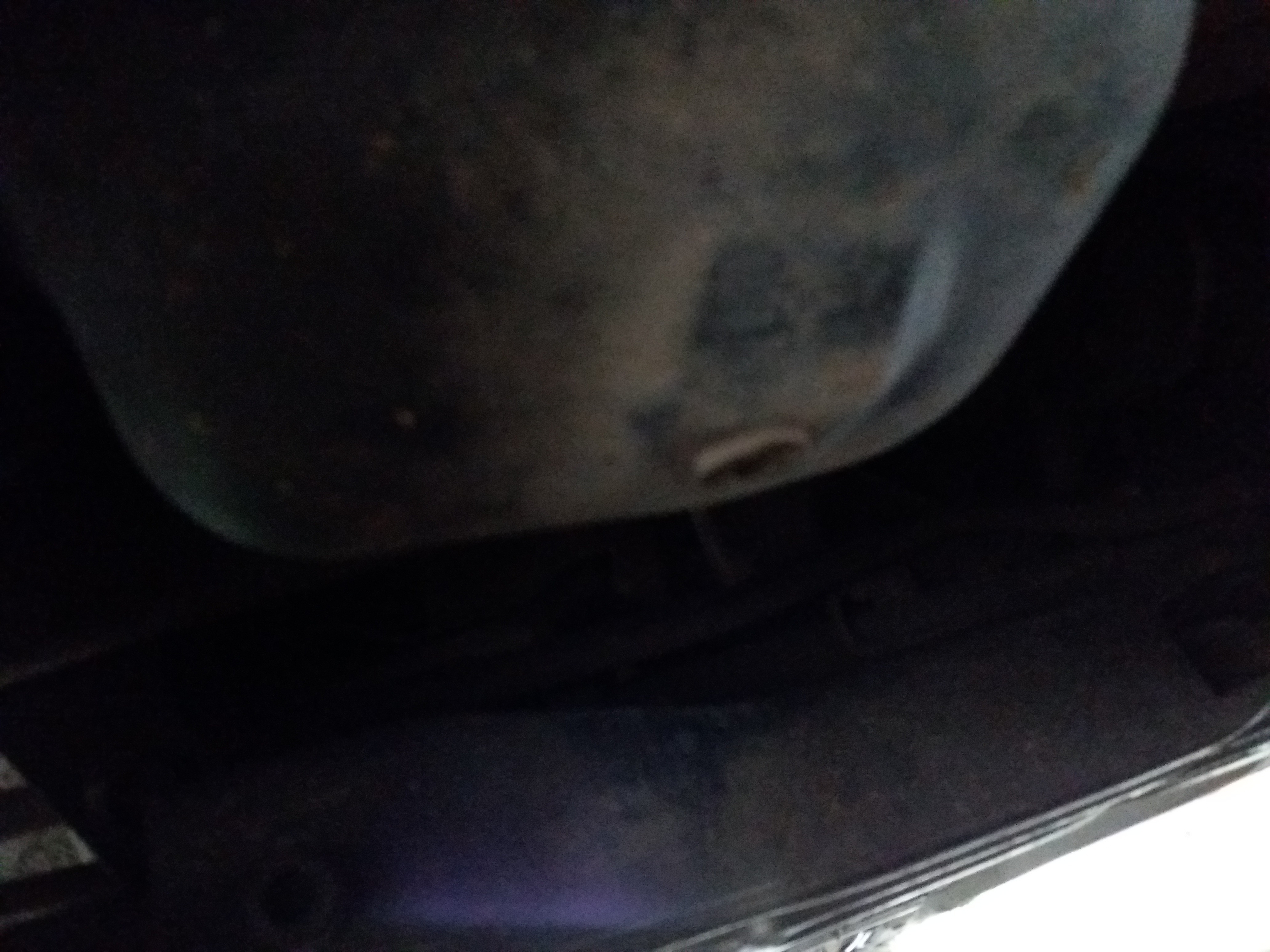

I want to change oil, is this the correct plug? Sry for bad picture. What kind of hexagon is it?
  • Sponsor
Is it a 1.2?
1.4 MPI. Is the plug below the sump pan or on the side?
Logic would dictate its the lowest point on the sump...
Yes, thank you. You can delete the topic, if necessary.
The size is 8mm hex.
